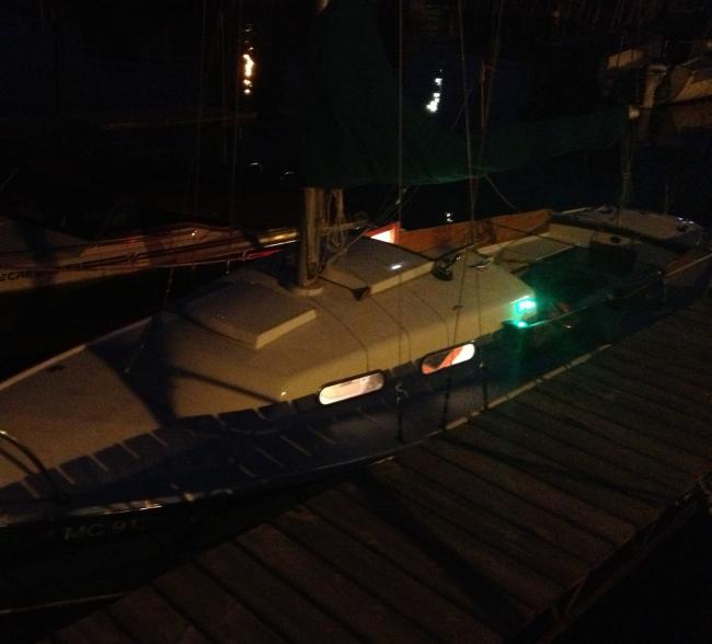

    600
    LEDs are nice!
    (Posting from my phone. This image might be enormous!)

    Kyle, are those the original fixtures?
  9. #114
    600
    Wish you'd have stopped in! I'd love to sail with another Alberg-ian! Open invitation to anyone onboard. (vw4kw at yahoo dot com)
    Yes, all original. The LEDs plugged and played no problemo. I will keep looking for my supplier. I can't remember who it was - sorry. If I remember correctly, I used the guidance of Rico's (s/v Mephisto Cat) posts and his source. I'll search and see if I can find it.

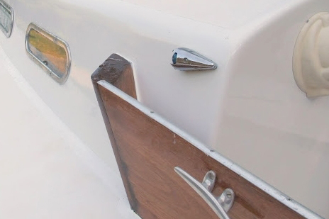

    Went to the Grand Rapids Boat Show this weekend - stink boat's aplenty - and was intrigued with rope LED lighting used in many modern day boats. I didn't think of it so much for looks, but for utility in hard to reach areas of our boats that a little bright-lighting might be advantageous. There is everyday lighting, and there is full-on house lights that illuminate every nook and cranny of the ship.

    600
    AGGG! I got my lights reversed!! Thanks for the heads up.... I could have left them that way for years! Oh dear.... SMH...

    Thought I should mention the light and glad to see that you have a good sense of humor. I'll bet you guys are ready for spring. Are the big lakes still icy? I've noticed Google usually out performs most sites when it comes to searches. I'll take a look at the led stuff
