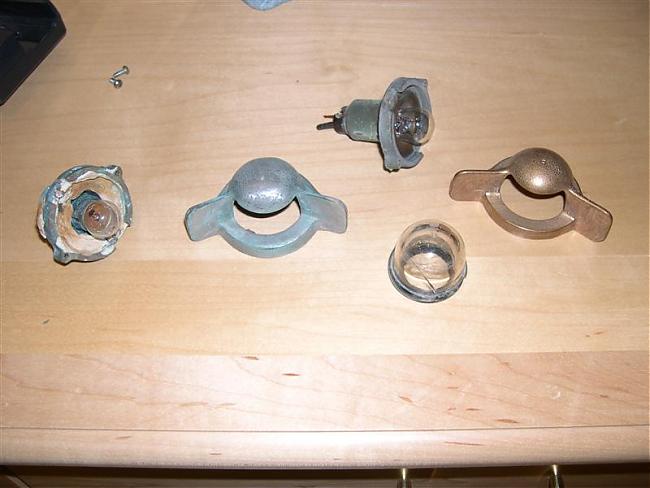

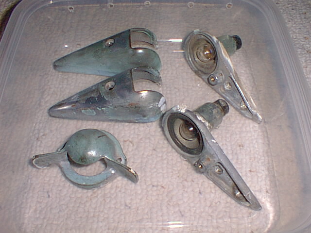

    Is this the 'stuff' you guys are refering to?
    2,309
    Yes, that's the original Pearson hardware.
    Northern MN
    1,100
    Make me an offer. I can't refuse.

    Bill,
    I'll try to find the lower half of the stern light. It must be somewhere around here in one of these boxes. When we picked up 113 she had nav lights on the pushpit and pulpit so the original equipment wasn't in use anymore. The pevious owner was pretty good about not throwing anything away. Meaning she was fully loaded with stuff. I hesitate to call any of it junk.
    Anyways, I'll look for it-it's yours for showing interest. Tony G
