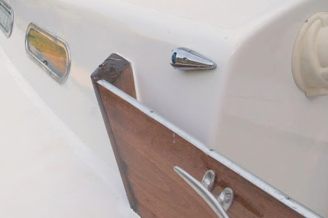

    Hey Ebb, I purchased some LED bulbs for my original perko nav lights and hope to change the cabin light bulbs to LED bulbs soon. I took my glass red, green, and clear lens off and soaked them in vinegar to get some of the minerals off and that worked pretty well. Looking forward to low energy consumption. Replaced my old #68 bulbs with the 9000425 from Dr. LED. Interesting that the led bulbs have to be colored even when they are behind a colored lens.

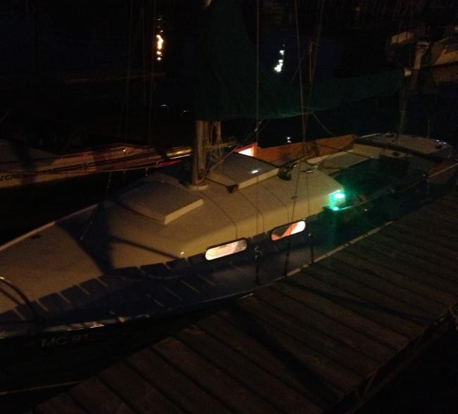

    LEDs are nice!
    (Posting from my phone. This image might be enormous!)

    Yes, all original. The LEDs plugged and played no problemo. I will keep looking for my supplier. I can't remember who it was - sorry. If I remember correctly, I used the guidance of Rico's (s/v Mephisto Cat) posts and his source. I'll search and see if I can find it.

    Went to the Grand Rapids Boat Show this weekend - stink boat's aplenty - and was intrigued with rope LED lighting used in many modern day boats. I didn't think of it so much for looks, but for utility in hard to reach areas of our boats that a little bright-lighting might be advantageous. There is everyday lighting, and there is full-on house lights that illuminate every nook and cranny of the ship.

    AGGG! I got my lights reversed!! Thanks for the heads up.... I could have left them that way for years! Oh dear.... SMH...
