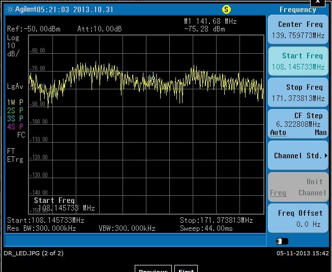

    Careful... The Dr. LEDs I tested didn't have the required width of vertical light emission. If you heel past 20 degrees, the sidelights will disappear. The COLREGs require +/- 25 degrees. Here's my letter to Dr. LED and their reply:

    Also, "Zero RF" is an unattainable pipe dream for LEDs that operate at a wide voltage margin (12 to 24 volts) because they incorporate switching regulators that will produce some RF interference (RFI). They all produce some RF interference, although there is a great variation in how much. The only way to achieve "Zero RF" is to encase them in shielding.
    Here are spectragraphs of the RFI noise from the red Dr. LED I tested.
    The first image is the RFI noise level from the Dr. LED.
    The second image is the baseline (background) noise levels (LED powered off) taken inside the RF shielded (several feet of steel and concrete) Screen Room I used for testing. The Dr. LED's RFI was more than 30 decibels (a ratio of 1,000 times) higher than the background noise.
    Placed near your VHF antenna, this noise level from the LED lamp would practically obliterate your VHF reception.
    I do wish there were RFI standards applied here in the US to these lamps. Most sailors don't have a screen room and a $20,000 spectrum analyzer handy. About the only test you can perform is to tune in the weakest weather station on your VHF radio and then turn on your LED lights. If the weather station reception is lost, you have a problem, though without a test instrument, it will be difficult to quantify how serious that problem is.
    The best LEDs I've found have the European Community "CE" stamp on them. Unlike the United States, the Europeans have RFI test standards.
    You can read more about Dr. LED issues here: http://www.cruisersforum.com/forums/...hts-36083.html
