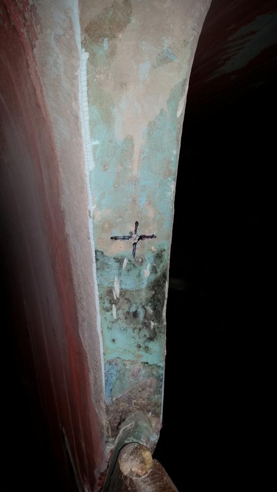

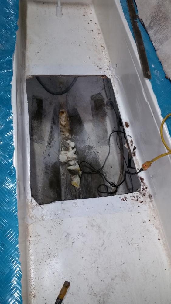

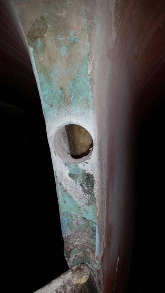

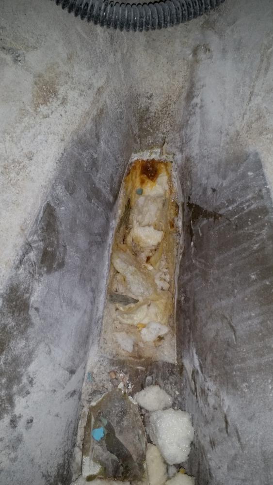

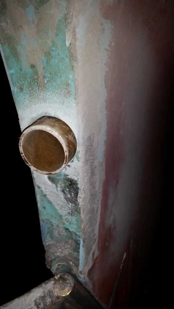

    Last weekend I started the repower project. Earlier I removed the fairing over the propeller window. I was really pleased to discover that the hull mold and rudder for the boat were originally built for an inboard then modified for outboards. I just had to remove fairing skin on the hull and a block in the rudder and I had my window. Last weekend I cut a window in my cockpit floor to make the engine installation a whole lot easier. I did not re-core the cockpit floor (though it was needed) when I did the rest of the deck work in anticipation of this project. After I removed the cockpit floor I had easy access to hull and the liner. I cut back a little of the liner, dug out the foam, marked the center of the propeller opening then drilled a hole for a fiberglass stern tube. So far so good.
    Name:  2016-01-23 14.57.46.jpg
    Cockpit Floor with access window cut out
    Name:  2016-01-23 14.58.20.jpg
    Liner cut back to expose foam where prop shaft will enter

    Name:  2016-01-25 16.50.48.jpg
    Drilled for stern tube
    Name:  2016-01-25 16.51.22.jpg
    Stern tube fitted in place

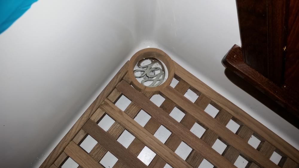

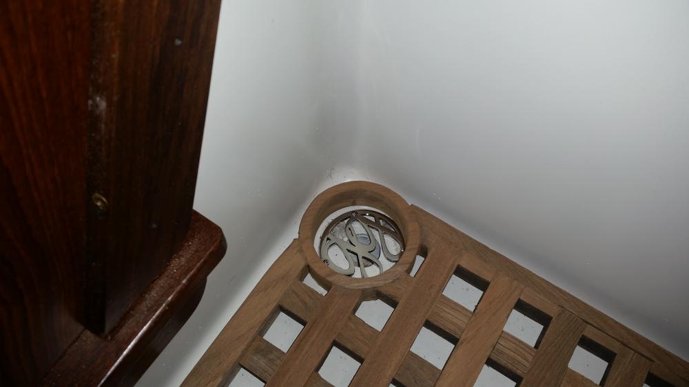

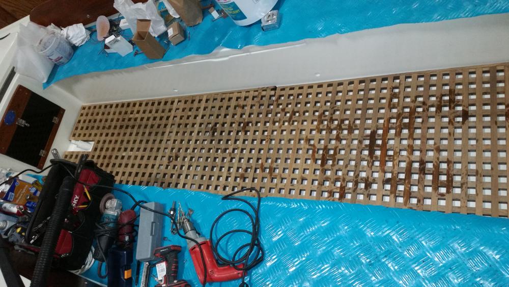

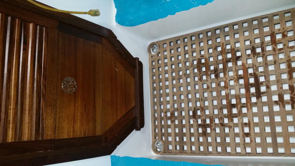

    As promised - a couple of pics of the cockpit before I cut out the window for the engine installation.

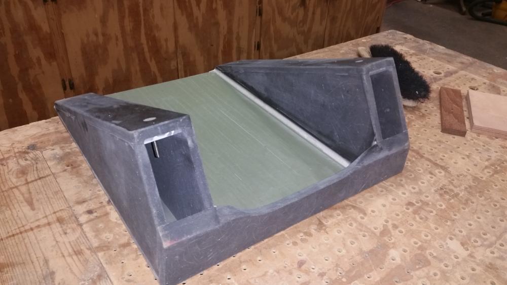

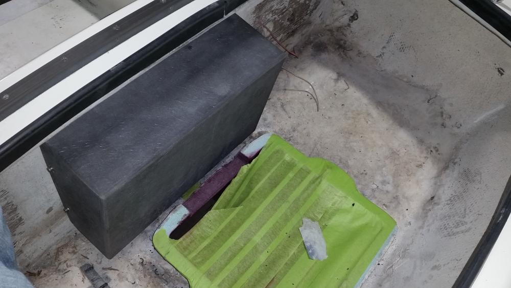

    The prop question was decided by fate. I happened across a used 13 x 11 3 blade sailor in good condition - for 50 bucks. That is what I am goin with. I had a bit of a setback yesterday. I built a really nice engine bed. I created a framework with glass reinforced foam panel glued to a fiberglass sheet. The stringers were backed with 1/4" aluminium and I laid up 4 layers of 1708 biax over the whole thing then filled it and prepped it for an epoxy coat. All that was left was to glass it into the boat. That is when I discovered that a 21 looks just like a 12 upside down. The measurements I took from the old engine required 21" of clearance over the bed. I read 12". I designed for 16" to be on the safe side. Does anyone want a really nice engine bed? At least I know how to do it this time.
    Name:  2016-02-03 18.59.34.jpg

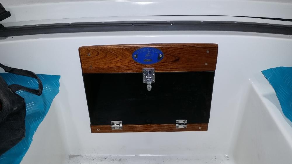

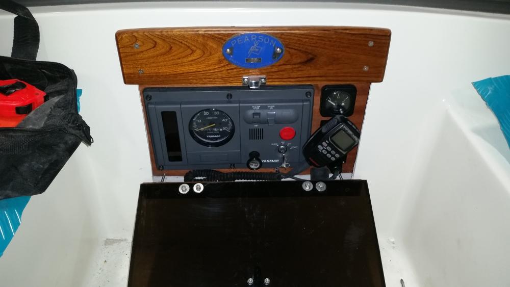

    On the plus side the control panel came out really nice. I recessed it in the door behind the tiller head and built a removable box to protect the backside

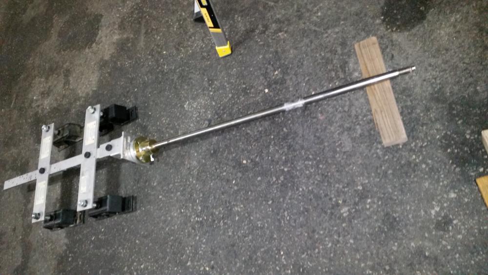

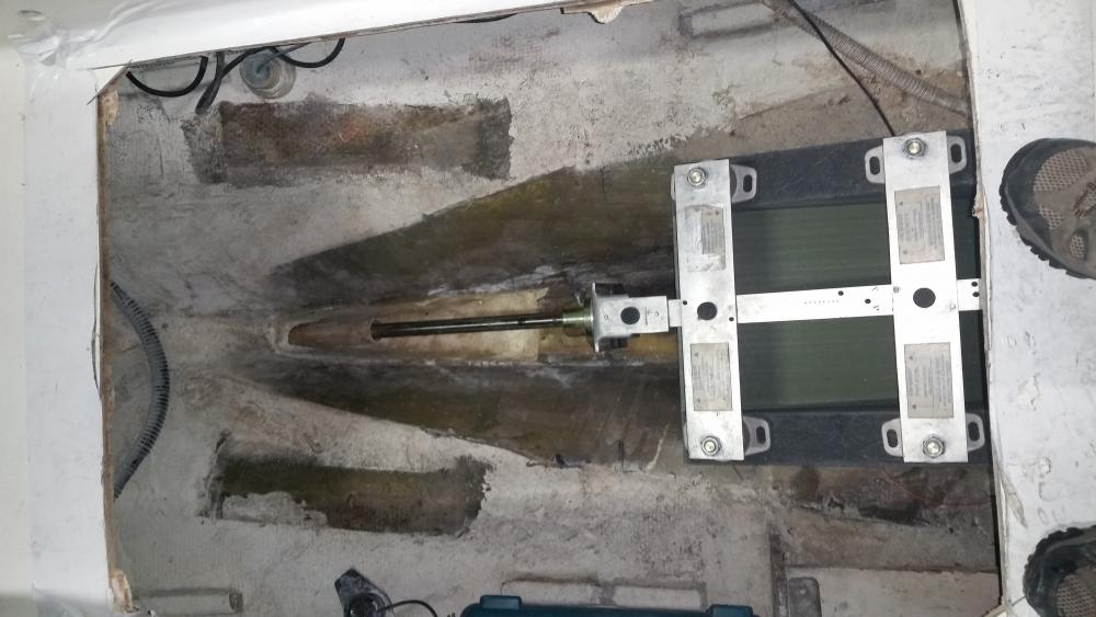

    Alignment Jig

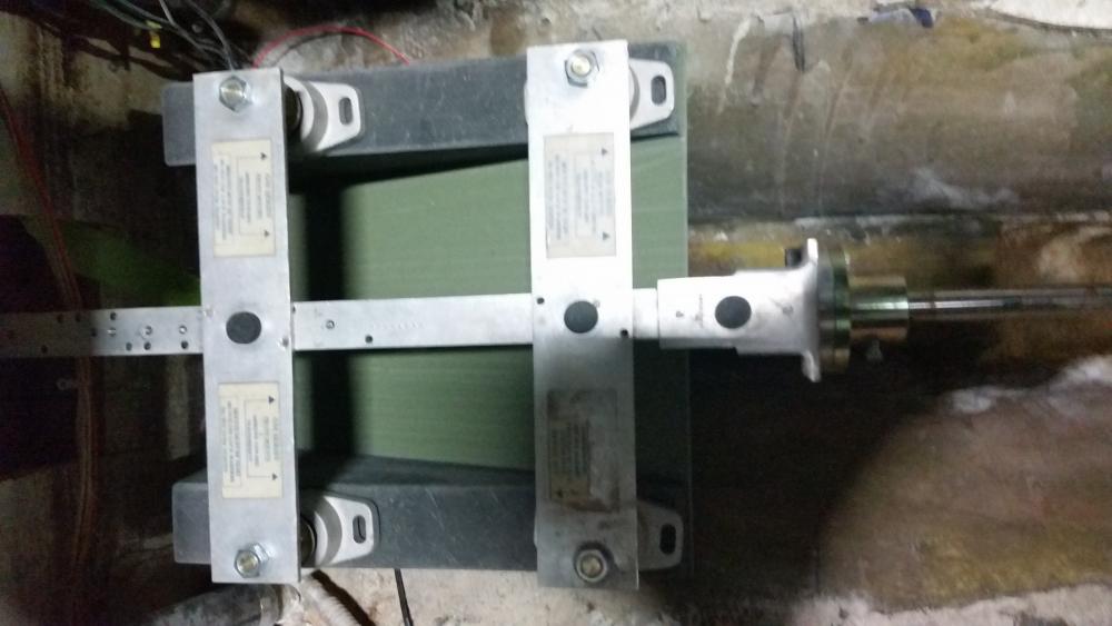

    Here are some pictures of the jig in place with the now useless bed.
    Name:  2016-01-30 14.32.50.jpg
    Name:  2016-02-03 15.37.20.jpg
    Name:  2016-02-03 15.37.36-5.jpg
  15. #60
    You know I built so many things on Destiny twice I effectively built two boats. :-( So I feel your pain. But you are getting really close and we are all cheering you on to reach the finish line. BTW I sure wish I would have had that jig when I repowered Destiny.
