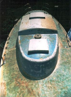

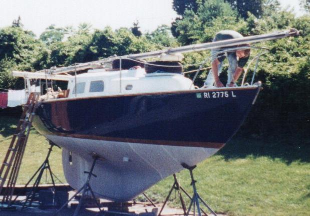

    Alyce and I have had Periwinkle since '96. The previous owner was in the process of moving from a rented place to a new house with no offers at the price he was asking. Given the unfinished state of the boat, it nearly got chopped up. Going into the project I knew the boat needed the following:
    new engine (inboard or outboard, we hadn't decided at the time)
    major deck recore - the foredeck was a swollen mass of spray-in-foam, water, rotten balsa and tile-grout (no kidding)
    the coach roof was full of water on the port side
    rudder was in three pieces
    the boat needed a complete electrical & plumbing replacement
    there was also some visible keel damage masked by bondo

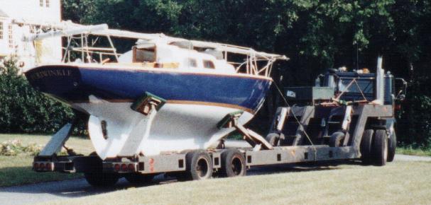

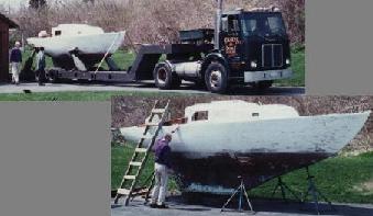

    Here is what the boat looked like on delivery day:

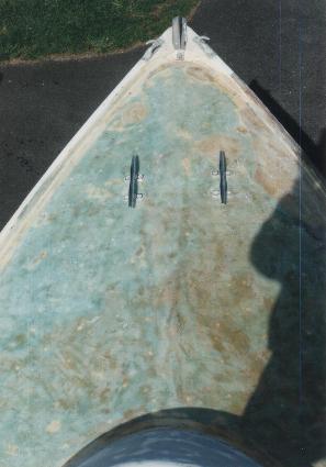

    The recore of the decks and coach roof was the first priority (after chasing out the critters). Sorry I don't have pictures of the demolition phase, it was a bit to dusty to think about using a good camera. The foredeck was reassembled from the Inside (only because the upper skin of that section of deck was the least damaged). Clamping pressure (from inside the V-berth) was afforded throught the liberal use of drywall screws. While the core and inner skin were curing the boat looked like a pin cushion...
    The coach roof & side decks were far easier since they were addressed from above.
    Here's the new deck ready for some paint:

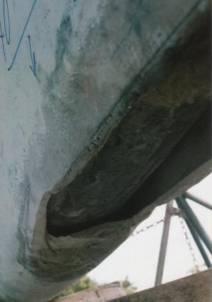

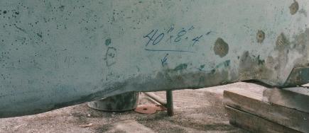

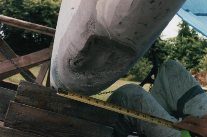

    after the top side was complete, the demolition party moved to the keel.
    Under the old bondo, there was evidence of several collisions with the bottom and maybe two trips to the beach.
    One interesting problem that may show up in other boats is a 1" gap I found between the ballast and the bottom of the keel. This appeared to be one of the reasons #231 had a large number of fractures and repairs to the bottom of the keel. The air gap may have resulted in damage every time #231 was hauled out and placed on blocks.
    During the overhaul, the void below the ballast was filled with mat and epoxy. The damage from the mid-point of the ballast aft to the rudder was reglassed in matt & roving to just a wee' bit heftier than original.
    below that image is the leading edge of the keel (after the bondo-ectomy)... this too was repaired with mat & roving to the original dimensions
    last is an image of the final stage in the keel demolition...

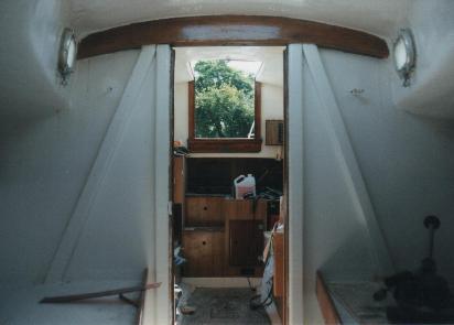

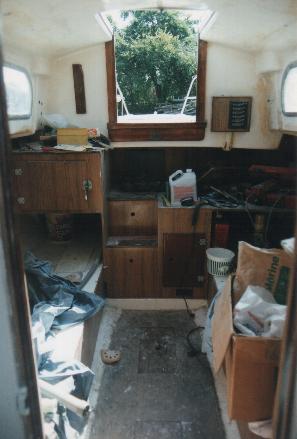

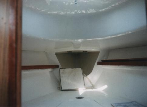

    In this timeframe a new beam under the mast step was fabricated (in white oak) and the V-berth was repainted. The main cabin however left a bit to the imagination...

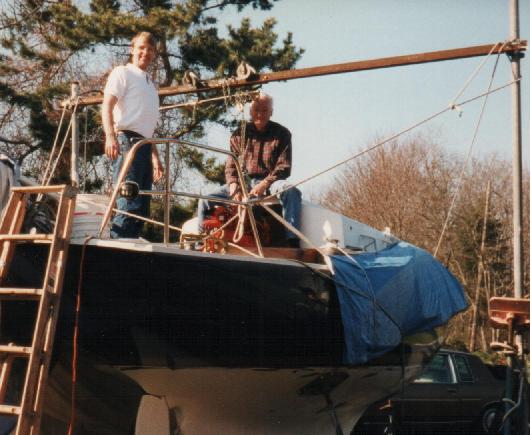

    I lucked into a used Westerbeke 20B2 that had two seasons of use. The big question was how to get it up in the air and onto the engine beds without a crane. The answer was a come-a-long, a couple of pulleys, four jack stands and a whole bunch of ubolts and threaded rod....
    This was easter sunday '97, 12 calendar months from delivery.

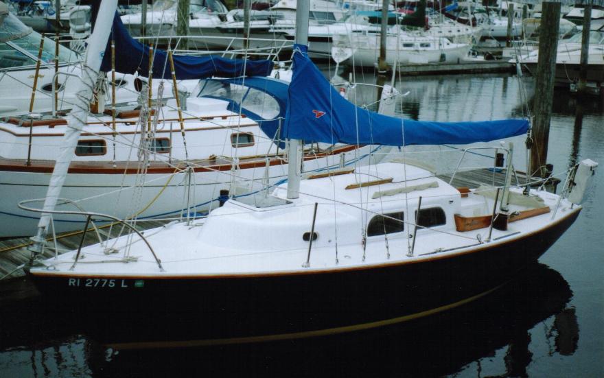

    Ok that was a couple of years back what has happened since? new sails (very happy with a set from www.cruisingdirect.com), new standing rigging, a furler (Schaefer 750). a repaint and the removal of the outboard well...
    Here's what Periwinkle looks like today:

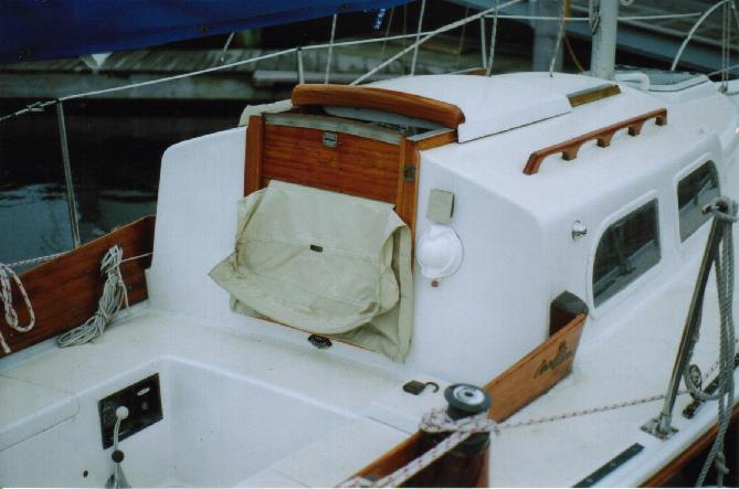

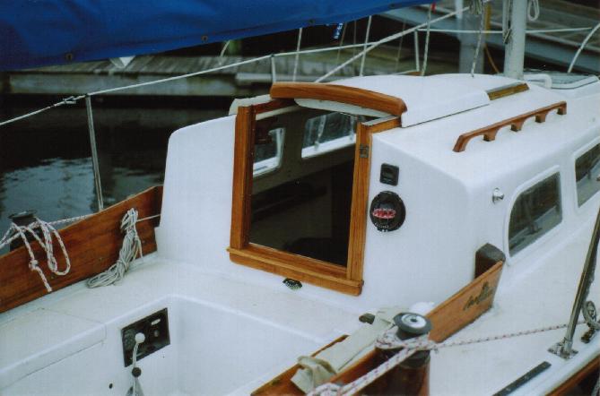

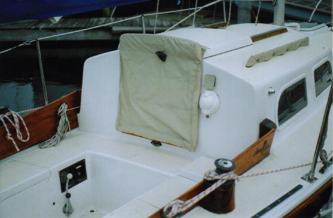

    lets start the tour in the cockpit..
    While I don't mind doing varnish, I prefer to make it last a couple of years. Hence everything that is varnished gets a cover....
