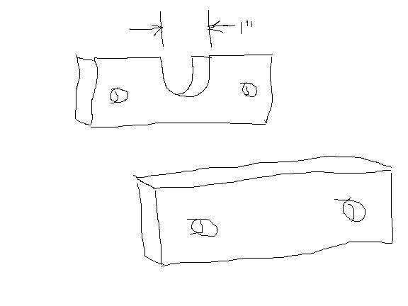

    You need a prop puller , looks like a gear puller .
    You can make your own if you cant find one to borrow.
    2 pieces of 1/2" all thread rod about a foot long , 4 nuts and washers .
    2 pieces of heavy metal , one with a U shaped hole cut out of the side and holes drilled for the all thread near the ends .
    I draw it for you after dinner .

    Thumbs up Home Brewed Prop Puller
    OK, quickie sketch .
    Put all thread through small holes , notch goes behind prop and plate with no notch goes against end of shaft. Tighten evenly on nuts until you have a good strain then whack it with a wood/leather or rubber mallet ,tighten some more and whack , repeat till it comes off .
    any ?
    Whack the puller , not the prop !

    Mike, many thanks! I get the concept methinks. And it looks like I may be able to borrow a real prop puller...

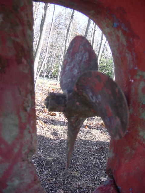

    It's a Yanmar 2GM. 13HP, 3400 RPM, and 15HP at 3600 RPM max.
    I also have a three bladed prop. (See pictures)

    Say no more, I solved the problem
    You have one blade too many on that prop . No way you can turn a 13x11- 3 blade with 13 hp unless it was in a 400lb skiff . At 2100 rpms your are not even getting 13hp. That is a huge prop for a small boat .
    My figures were for a 2 blade 13x11 , that extra blade needs more hp to spin it.
    It is probably a motor boat prop too , and has huge surface area .
    Get a 12x6 sailor prop (2 blade ) and you will be happy for the rest of your life .
    You will sail faster too (less drag )
    1216 shaft rpms should give you 6+or- knots with a 12x6 ( 6" pitch ) prop , so if you throttle back a little 5.5 knots is easy .
    You know you can have props re-pitched , so get a 2 blade that is close and try it and if it is not exact either pitch it up or down until you can get 5.5knots at 2800 rpms .
