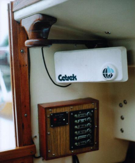

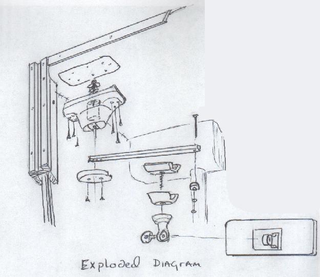

    One other standing request that I've received was for details and dimensions of the chart plotter mounting bracket:
  5. #50
    Nov 2005
    Narragansett Bay, R.I.
    597

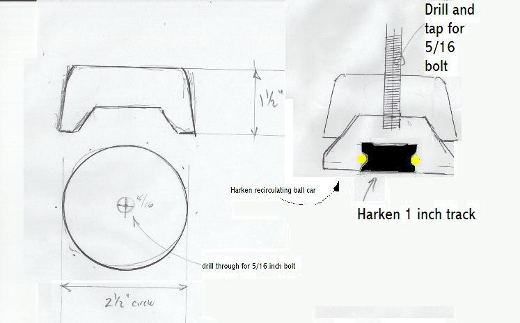

    In the attached sketch you'll see the major parts:
    * 12 inch section of Harken 1 inch recirculating ball track
    * Harken car to fit the track (tapped to hold a 5/16th" NC bolt)
    * teak - base containing a 5/16th NC bolt, a stainless steel spring (1" x 3" or so)
    * teak - cap (for the base)
    * teak - transition from Harken Car to the plotter arm

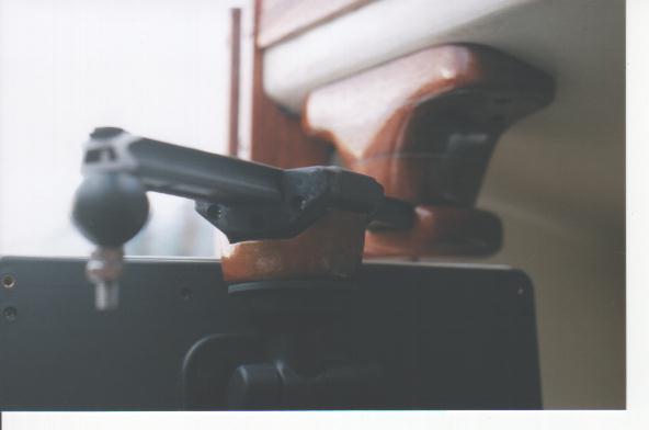

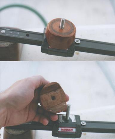

    Next a close up (before disassembly):

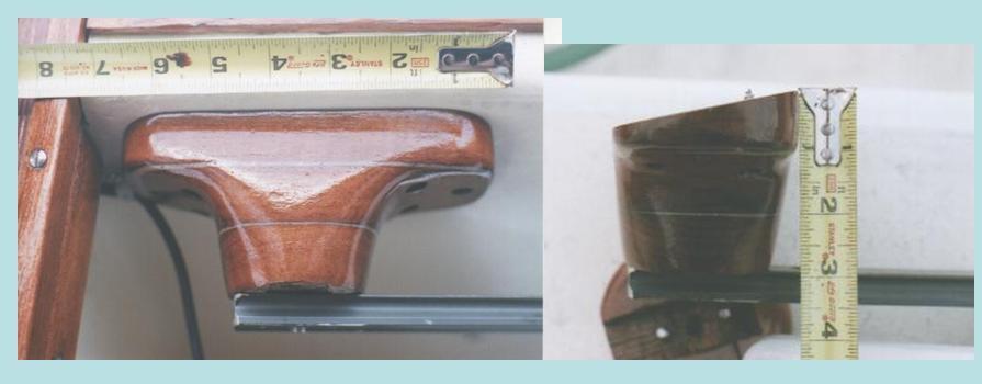

    here's a photo of the base (note the slot between the track and the base, this acts as a detent to hold the plotter in position):

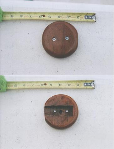

    The cap that covers the rough end of the base & plotter arm is also formed from teak and fastened with #8 machine screws here's a close up:

    one more section of teak makes up the transition from the harken car to the chart plotter mount:

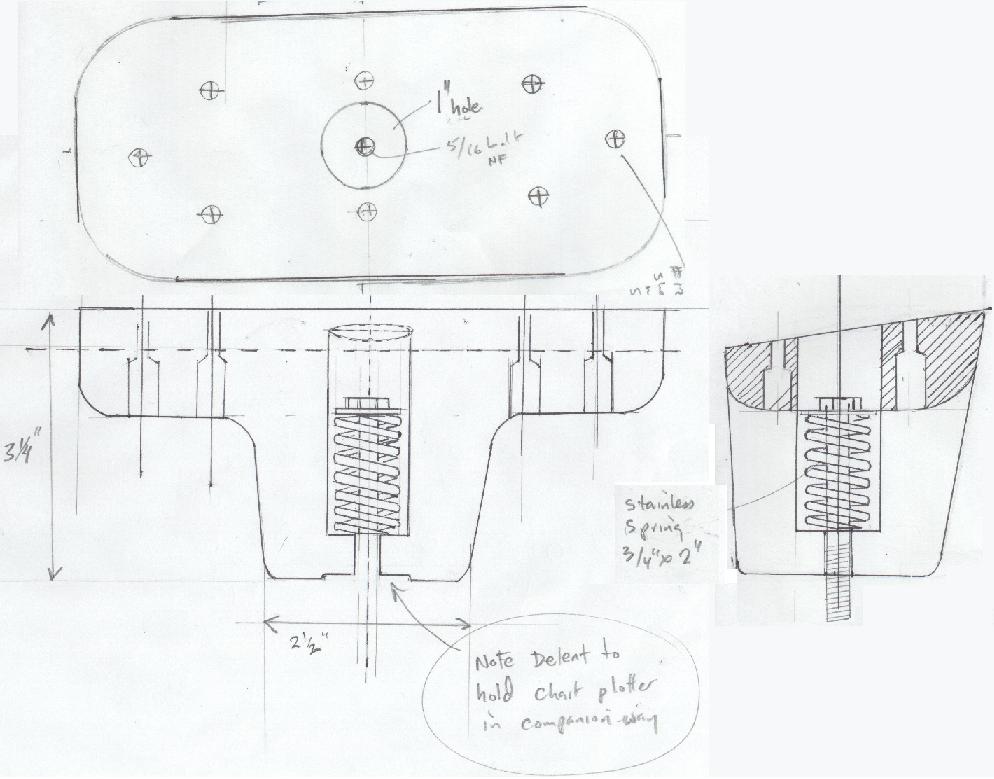

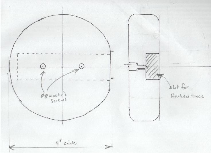

    If anyone is crazy enough to try building one here are the drawings for the base, cap and transition sections:
    cheers,
    bill
