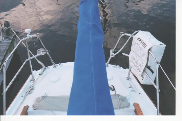

    Quote Originally Posted by mbd
    Where did you get that two-part pushpit - if it can be called that? Or would it be stern-quarter lifeline stanchions or something? Anyway, how do you like them? .
    I found the two part stern rail (new) in a consignment shop. The manufacturer's label read "High Seas" (never had any luck finding a web site that matched the label). The installation was probably easier than a single piece, the only mod was that I needed to shorten the aft most column.
    The remains of the label for the stern rail show the following mfr address:
    High Seas
    4861 24th Avenue
    Port Huron, MI 48060
    313-385-4411
    I like the two piece version, it doesn't get in the way when boarding over the stern (at the dock or by ladder when out of the water)

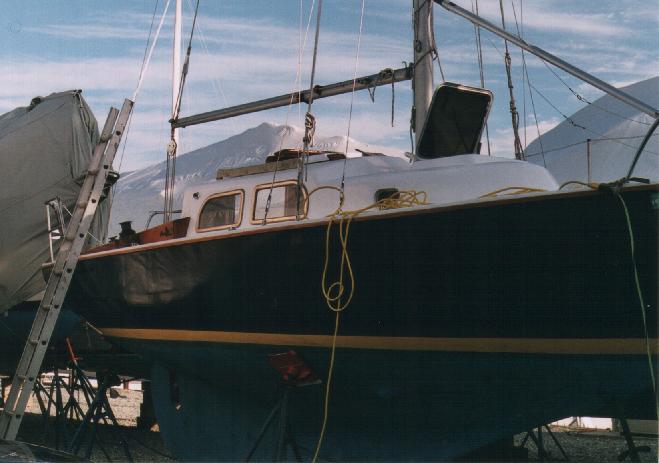

  7. #37
    Nov 2005
    Narragansett Bay, R.I.
    597
    The snow is melting, the RedSox are playing baseball in Florida... humm.... must be time to get the boat cover off. It's time to install the new portlights (covered in the technical discussion under the "Large Portlights" thread http://www.pearsonariel.org/discussi...ead.php?t=1227 ), lifelines, zincs and bottom paint.
    Here we are two days into the process....Just three weeks till launch.

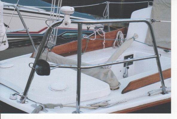

    I had a couple email requests for details on A-231's stern rail attached are some photos:

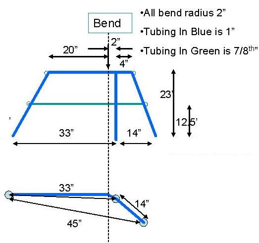

    ... and a dimensioned sketch if anyone is heading to a welding shop:

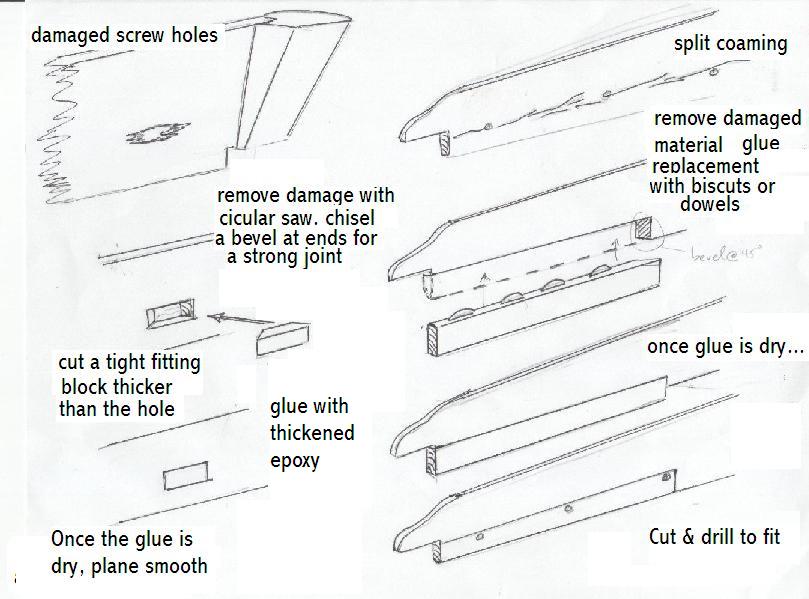

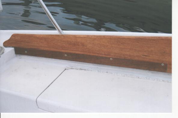

    There have been a couple of threads on the site related to coaming repair. While I haven't had to deal with rotten wood, 40 years of abuse left A-231 with a couple of splits on the port side coaming. These were fixed with a couple of dutchmen replacing the splintered and torn sections.
    As you can see, the color match isn't perfect but the original fabric of the boat is still in place
    here is the repair to the torn screw hole on the forward edge:
  11. #41
    Nov 2005
    597
    the repair to the aft end of the coaming was needed where a split occured along the line of fastners. originally I just glued this with epoxy, but the coaming split again right next to the seam. In the end a whole section was cut out and a new piece glued on....
  12. #42
    Nov 2005
    597
    The technique is shown in the sketch below. I tend to use a circular saw to rough out the openings for new material. Other more careful folks use a router or chisel...

    bill,
    when 338's new coamings go in - and having seen so many coamings split at exactly this place - think I will drill in thru the bottom edge 3 or 4 holes to glue in dowels of the same material, mahogany in my case.
    Think the split occurs from the upper portion of the coaming being free standing. Someone could design a nice curvey block that could be lagged into the deck and screwd to the coaming that would help keep it from bending outward. Wish I could add a drawing here!

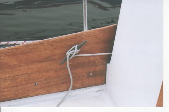

    Mysterious cleat and line going forward to the coaming post. What's happnin there?

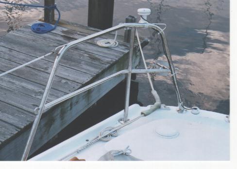

  14. #44
    Apr 2004
    Pensacola, FL
    726
    I noticed in the earlier post, that is his furling line. Pure genus! I love it.
    Mine is strung outboard, with fairleads on the bow pulpit (like most bosts I have seen) and I regularly step on (read roll off of) the line when going forward.
    Might borrow that one!
