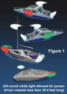

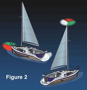

    Keep in mind that navigation lights are not like headlights; you do not use them to 'see' your way through traffic. And they are not very bright even on the biggest ships. Navigation lights are meant to be seen from specific angles in a particular way in order to enable others to tell the relative 'attitude' (direction of travel) of a ship solely by the scheme of lights that are visible at any one time.

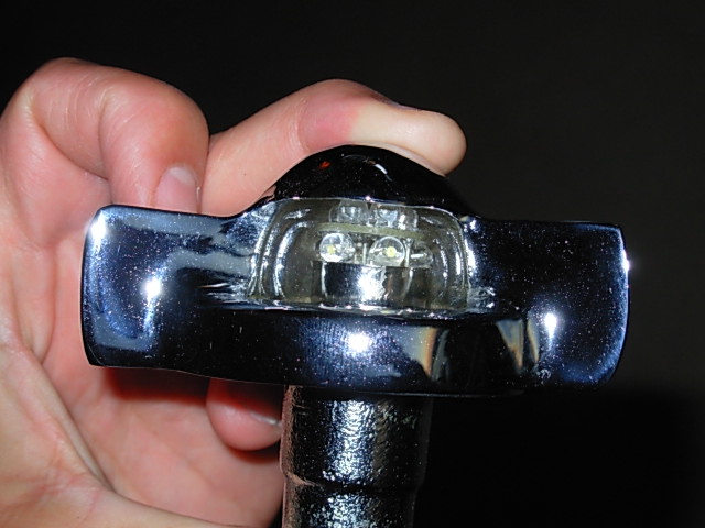

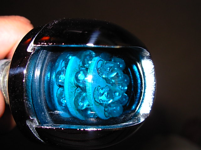

    I completed my LED installation a couple of weeks ago. This was only one day before departing to the south bay on a Friday afternoon for a regatta. This 30 mile+ windy, dark & foggy trip in heavy traffic, provided clear affirmation that my lights are nicely visible even in adverse conditions.

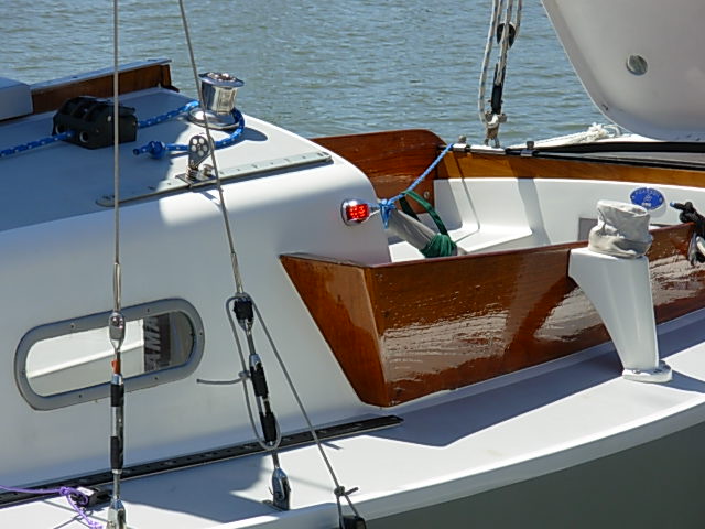

    Picture: Bright LED at mid-day. Note that the image does not EMIT light so the LEDs appear less bright. In person, they are so bright that the light seems almost like a single point of light.
    This picture is taken at a 45 deg angle off the bow.
