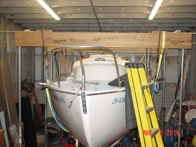

    Attachment 9187Attachment 9186Attachment 9185 I'll post some better photos

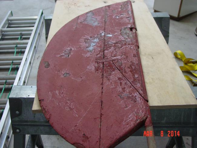

    Thanks Ebb, I agree the heel needs to come off when I take the rudder off as well. The fiberglass does appear to be somewhat weak above the heel. The photos look more like abstact art with some paint on and some off, the wood doesn't appear to be in bad shape but it looks rough for sure in its current state. The keel has dripped some water out this winter so the heel may be one of the places it entered. The bilge looks great so I don't think its worked its way down from there. I ordered a rudder bushing from Bill and hope to start the dismantle soon. I made a lifting frame to make working on the bottom a little easier. I need some better straps and better post but its working pretty good for now. I lifted it off the trailer and hurridly blocked the keel and put some stands under it.

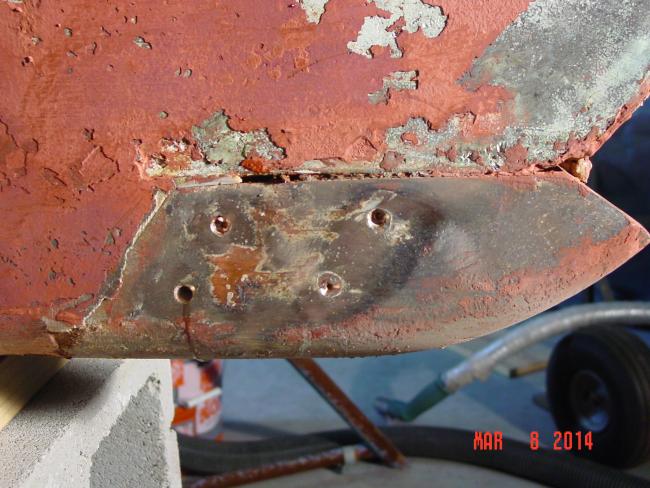

Size:  44.4 KB Removed the rudder last night and it appears to be pretty solid. There is a gap between the seperate boards which allows a little flex when pushing down on the trailing laying flat on a table. Would love to have a new one but... Can anyone explain or show pics of how this original rudder is assembled?

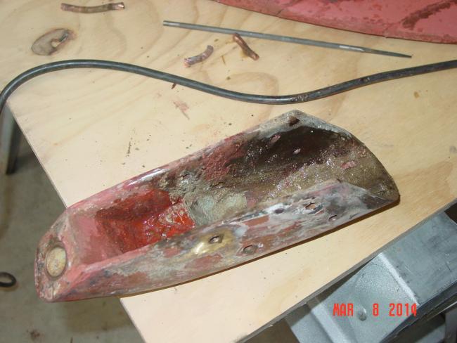

    Descent Shoe
Size:  34.2 KBName:  DSC05617.jpg

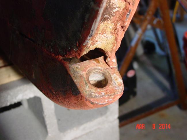

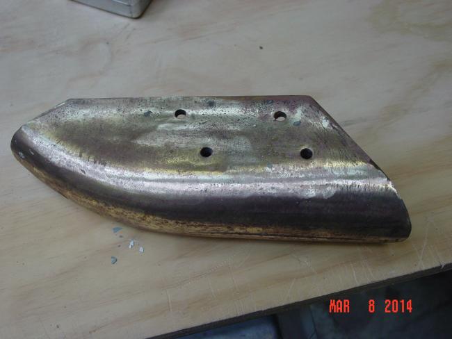

Size:  56.7 KB The shoe looked good from the outside but I could see a puddle of water down inside the shoe, so I removed it to inspect the heel. Sand and dirt are inside the shoe
  15. #405
    Feb 2013
    Oklahoma City, OK
    101
Size:  61.8 KBName:  DSC05628.jpg
Size:  32.5 KBName:  DSC05622.jpg

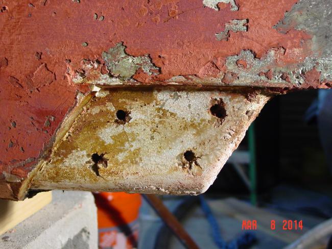

Size:  42.7 KB The heel in pretty good shape, shoe off, the red part on the inside is where water was puddled, the shoe cleaned up a little
