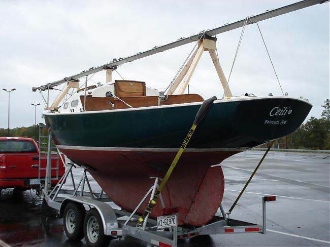

    Here CEILI, 1966 Commander #256, can be seen taken a highway rest on her journey to N.E. North Carolina from Falmouth, ME.

    Nice boat - nice trailer too! Was that included in your purchase or did you get it for the haul?

    Thanks. No, the trailer didn't come with her. I had her made for a previous boat we had, a 1973 Cape Dory 25. In order to accomodate the extra draft of the Commander, I cut all six screw jack supports off and welded in new ones with greater height. I used heavier guage pipe (schedule 80) vice what Triad trailers used. I only wish I would have made the new supports a bit less tall. I still have eight inches of upward adjustability but as you can see, am nearly bottomed out as she is currently configured. Which means....when I get to the hull, I won't be able to complete her without her being off the trailer, which means I'll be under the daily fee rate of the local yard.
    I plan on making the trailer available for rent next year after I have Ceili back in the water.

    nice trailer... can we talk you into posting a drawing package?

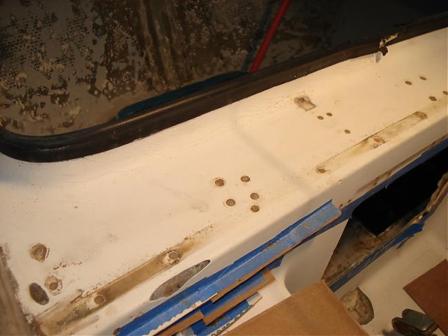

    I'll use this thread to maintain progress on the work I'm embarking upon with our Commander. To commence, I have focused my efforts in the stern section and will progressively move forward. For now, this is what I'm doing:
    1) Fill over 3 dozen holes (drilled by PO's).
    2) Repair / restore fiberglass that was cut out for previous outboard motor tiller.
    3) Remove and replace backstay chainplate and knee.
    4) Fabricate a gas can shelf on each side of the motor well
    5) Incorporate a transom stringer, that will double as the aft shelf support

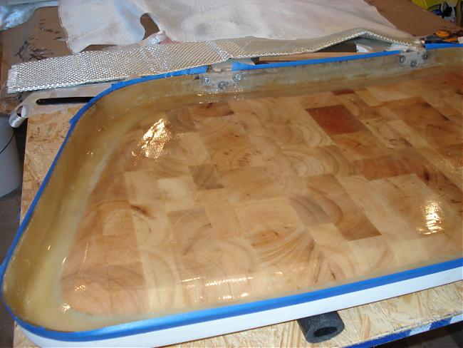

    6) Recore and skin the lazarette locker cover

    Ariel #231, I somehow overlooked your post and didn't want you to think that I was ignoring you. Hmmm.., what specifically were you interested in as for the trailer drawing? I'm thinking you want measurements, but of what specifically? I can take measurements, but of the entire profile might take a bit of time. Plus, I have no idea how to post a sketch. Maybe I could take a closeup digital photo of a sketch depicting specific dimensions? Are you planning on modifying an existing trailer, building one from scratch? How soon till you do either or are you mainly curious?

    i'm mostly curious about the dimensions of the frame members, the ratings on your axle setup and the tongue load of the system when ready to tow... it's getting harder to prep a boat for the season while in the boatyard (DEM talked about treating city water as a hazardous material until some measure of sanity prevailed). Building a trailer may be in my future a season or two down the road. I've already welded up a set of jackstands suitable for trailer installation.

    Take the first photo in this thread.
    Imagine Ceilli sitting on a FRAME with jackstands.
    Imagine that frame sitting on the trailer.
    A duo.
    Why couldn't a transport trailer be designed for Ariel/Commanders
    - and for that matter any number of 8' wide keeled sailboats -
    upon which the boat on a 'standard' frame could be loaded.
    How might it be loaded?
    The frame would be lifted with bottle jacks - and the trailer carefully, by repositioning the jacks, backed under the frame.
    With the boat on its frame - all 6000# of it - lifting and lowering would be equally..... careful.
    With some development screwjacks might be permanently attached to the frame, or perhaps brackets provided for rentals to be secured. Other endless possibilities.
    Wouldn't it be possible for a bunch of sailors to get together and design something like this?
    This is of course only for transport, not self-launching.
    Would it give versatility to storing or working on the boat at any location
    and moving it to a harbor for strap launching?
    If there were a single trailer made specifically for hauling A/C boats with jackstands on a frame, then that trailer might be shared by all who wanted to borrow it.
    Of course who licenses it, does the maintenance and researches the codes and so forth
    is another kettle.
    Just an idea....
