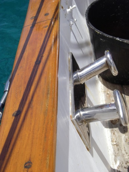

  7. #382
    1,439
    Hey Ebb, it looks like Deep Blue Yacht Supply carries chocks similar to Tim Lackey's. I got my mooring bit from them and was happy with the company. Buck Algonquin - you can get them in various sizes and bronze too.
  8. #383
    Northern MN
    1,100
    Geeze, Mike. I wish I had known about DBYS before I jumped... Those mooring bits look much more substantial than the one we bought. And now I'd feel bad selling it to someone else because I know there is a better piece at a better price out there. Who ever would have thought it would be this tough to have a conscience.
    Ebb it's dang near warm enough for me to break into deep storage. I'll take some close ups of the mid-rail chocks so you can get a feel on the curves. They are not as smooth as the locking/captive chock Ben posted above. Thems smooooth! I wonder, can one file and polish burnished bronze? That may be a way to 'soften' those edges (which are getting progressively knifeier with each passing minute in my mind).
    My home has a keel.
  9. #384
    3,621
    skenes with pains
    Mike, Good BuckAlgonquin source there. Thanks.
    Tony, imco you definitely can mess with bronze.
    Can file and grind hard edges rounder and buff them back without sneezing.
    I wouldn't try it with stainless.
    Thing I discover is it is too easy to think up an upgrade.
    When I get into the new project, IT takes over. I stop thinking. Little problems happen.
    And the unretrievable seconds disappear into months and years.
    Tim Lackey's skenes are almost perfect. All he did was get lucky and bolt them in place.
    There is nothing he had to do to make them better.
    The HA Rostand shenes are fine for casual tying up.
    Without a straight-on view of the fitting the dimensions can't be extrapolated. But they seem rather flat. (While Mike's Buckaroonie looks quite round inside like Tim's.) Casting looks strong and handsome.
    BUT there isn't much room in the Skene Bow Chock for a chaffing wrap on the line, maybe the 6" size has to be used.
    I'm convinced that warps and rodes should be at least 5/8" six or eight braid specific anchor line.
    And the type of chaffing stuff should be something that disapates heat and lets in cooling waterm - not sure what that stuff is.
    It isn't hard garden hose but something more porus and probably thicker.
    The bollard looks OK - in the straight on picture - but what happens to the space between the horns when you turn the fitting? If a line is coming off a cleat at an angle to the chock, how much
    of a twist in the chock cancels out the space for the line, wrapped line? The line can't make a jog through the horns. Has to be fair.
    I'm serious about decent leads off the boat and I may have to take the TIME
    to make a clay model from the photos because vendors don't ever give compleat dimensionss of fixtures. Probably because the manufacturer doesn't think e nwant it either.
    Have a picture on the kichen wall that came from the cruisersforum site years ago.
    http://www.cruisersforum.com/attachm...0/cleat_origin..
    That won't come up, but it is a cleat/chock combo that is attached at the RAIL.
    The cleat is on the inside, lower than the chock, and sideways, horizonal with the deck - the chock is on top of the rail. It is a single molded bronze fitting. The base of the cleat turns the corner up onto the rail and becomes the rounded throat of the chock. Nice. Sculpting coud be bollarde/rounded better.
    The rail on the A/C is probably too short for this fitting from a larger boat - but it's clever. If you are onboard with the concept,
    our rail (with maybe a wood cap) could have a nice rounded bronze skene-chock on it - and a strong cleat mounted somehow very close with the chock but bolted through the deck. Wanna try it? Problem is the pull is UP on the bolts rather than in shear as in the mystery dual fitting.
    The mystery fitting is shown with a rope eye around the cleat led thru the open chock.
    The plaits of the eye splice are overboard, free, and not rubbing on anything.
    No wad of chaffing gear is needed except for, say, leathering the eye maybe
    because there is no line to stretch and wear from mooring cleat to a rail chock like we normally have.
    What's great is that the line is instantly available by slipping the eye or undoing turns off the cleat.
    It's impossible to imagine the line crawling out of this fitting. Somebody was thinking here!
    The A/C bow could have nice rounded bronze chock/cleats if you can find them. Warps could alternately lead from inboard mooring cleats or samson post to opposite sides: EG port cleat to starboard chock, to get a better fairer lead off the boat.

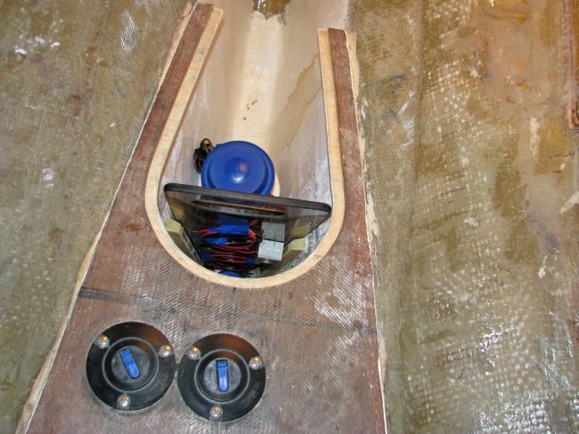

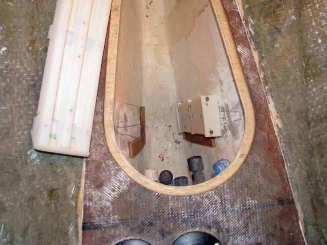

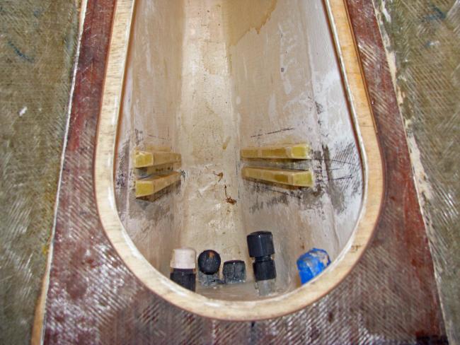

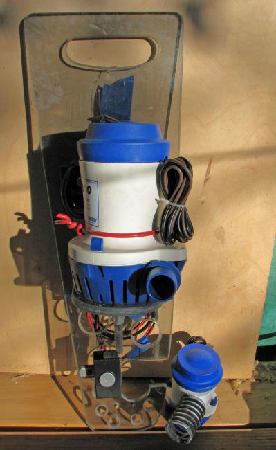

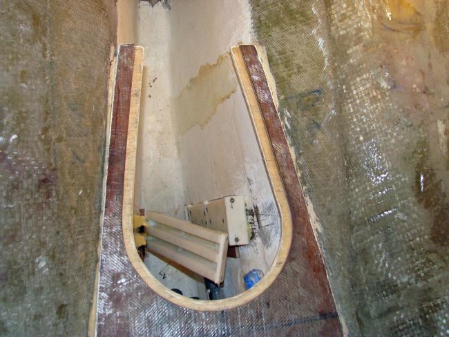

  12. #387
    2,311
    Post Removable bilge pump assembly
    Hey Bill et al,
    Here, finally, are some pics - in series - showing the boat's new pump board installation.
    A piece of leftover 3/8" Lexan with a shelf added to hold the high water Shurflo 1500 8Amp,
    and a couple small bronze screws (can't be seen) to hold the screen clip bracket on the small Shurflo 1000 3.75 Amp.
    The small pump is mounted on one side and at the very bottom with its hose pointing aft "through" a 'L' shaped hole in the pull-board.
    The pump and attached hose can be lifted off and removed from the unit.
    The large high water pump is fitted to the board with its hose also pointed aft and held on tightly with a nylon tie.
    Assume the small pump to be replaceable - and the large expensive pump never used.
    The WaterWitch digital sensors are screwed on to the board with their wires blue taped.
    There is no room in the Ariel's narrow bilge/sump for traditional float switches. At least not in what litlgull has behind her ballast.
    For the big pump WaterWitch has a high water alarm with a stand alone buzzer and mute fixture not shown.
  13. #388
    2,311
    Following photos show the method of making a slide holder for the board with epoxy.
    The white rectangle mold is made with polyethylene sheet material.
    The bilge hull sides are prepped. The mold's two ridge shapes filled with epoxy mishmash and glued to the sides. Not much pressure is needed to hold the molds while curing. I used balled up plastic film, jammed down in!
    Because of the truncated mold shape the mold pops right off after the epoxy is hard.
    Turns out there is just enough space to set the board in its place
    It is held quite firmly when housed.
    Now we have to hook up the various wires and run the hose.
    Both pumps use same 1 1/8" Vinyl hose. Small pump hose will exit into cockpit.
    Large pump hose will exit high up on the hull, with syphon break loop. Not sure just where,
    but the hose for efficiency has to be as short as possible.

    Brooksville, FL
    720
    Now that is a sweet setup.
    I was planning on the dual pump setup on Destiny and I really like the way that is set up. Easy to maintain which is something that will be an ongoing thing with the small pump.
    JERRY CARPENTER - C147
