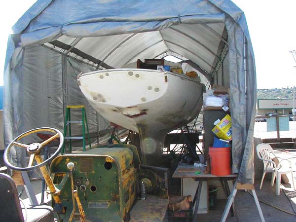

    This thread is dedicated to photos of Ebb's refurbishing of Ariel #338.
    2,279

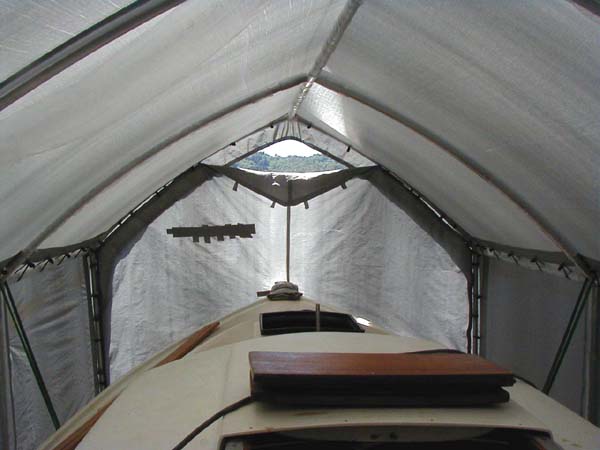

    The first photo is of Ebb's garage. Note the conveniently placed tow vehicle near the door
    2,279

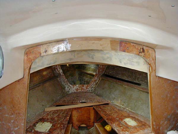

    Inside the garage . . .

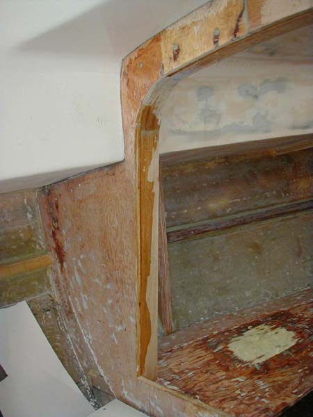

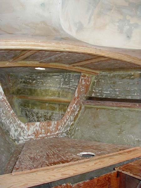

    Here is the replacement straongback as seen from the main cabin.
    2,279

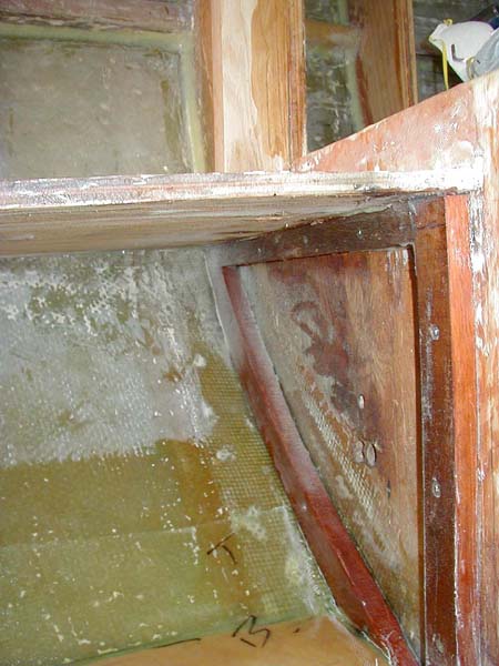

    Another view of the sb construction:
    2,279

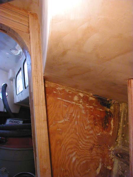

    Another of the SB

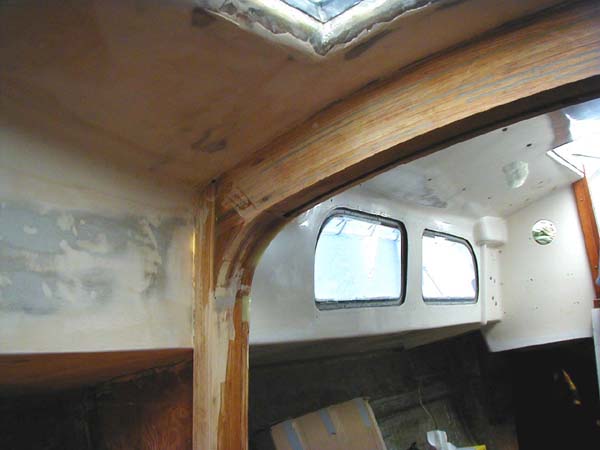

    Last SB photo

    Reinforcing under foredeck

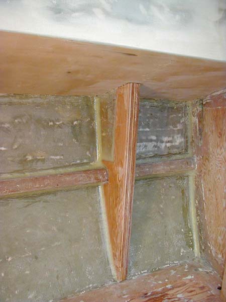

    New knee for the forward chainplate. Note the old Pearson tab inside the new structure.

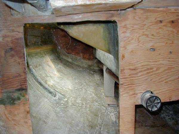

    Looking aft at the starboard cockpti locker from the main cabin. Black pipe is new cockpit drain.

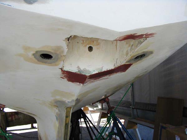

    The cockpit drains exit through the new holes each side of the ob well.

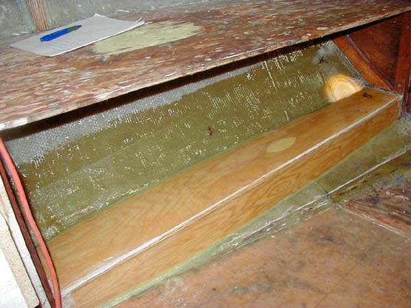

    This is a "shelf" built under the forepeak bunk (gone). Custom water tanks are planned for port and stbd.
