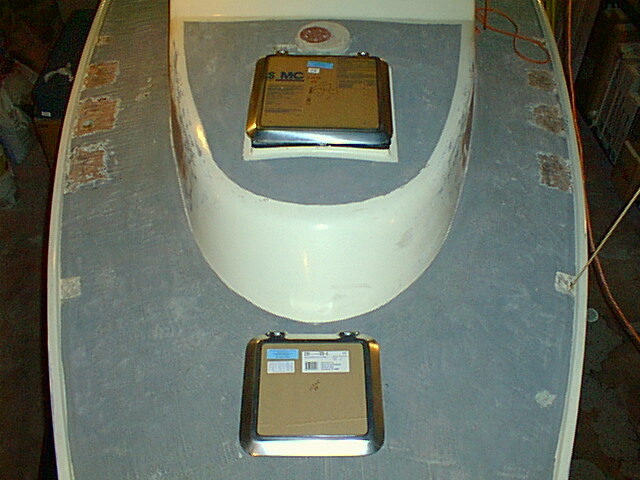

    Thanks Capt Dave,
    points well taken, that splashzone sounds fasinatin! Like something to use on iron plate fishing boats and ferrocement. Smith&Co's Fill-It is really aimed at ruogh service too. Smiths's first love, if it can be put like this, was for ferrocement, when they were hot, he came up with CPES (clear penetrating epoxy) as a sealer. Then the woodworkers and home repair guys discovered it. (But never came up with real finesse products like for finishing off the topsides IMCO)
    I got epoxy back in the days befor it was for 'public sale' - getting it in containers with codes for labels - and played around with it like it was playdough - and became badly sensitized to it where it attacked the fingers around the nails. Didn't heal for weeks. Don't know that I would stick my fingers in that evil sounding stuff you talk about!!!
    I swear latex gloves you get at the plastics supply or hardwear are 2nds or thirds or rejects from the medical suppliers. Gloves will have holes in them or pull apart when pulling them on. They're for dexterity not dipping!
    I get milled glass in plastic jars from the local plastics fabrication store. It's heavy glass dust. And when I added it to the mix it near tore itself off the vertical surface! Add that stuff and you loose sandability, it's for plastic rock. I don't use it much. Jars of 'chopped strand' I get are 1/4". I've heard it comes shorter or longer. That and silica is the mish-mash I make up. Use it structurally. It's hairy. If a surface is exposed and need it smooth I press mylar or visqueen against it. I think (I hope!) it is pretty strong stuff! I believe I would use this for molded in backup pads for fittings. I built up the inside of the stem with it, especially around the cutwater, Crazy, huh?
