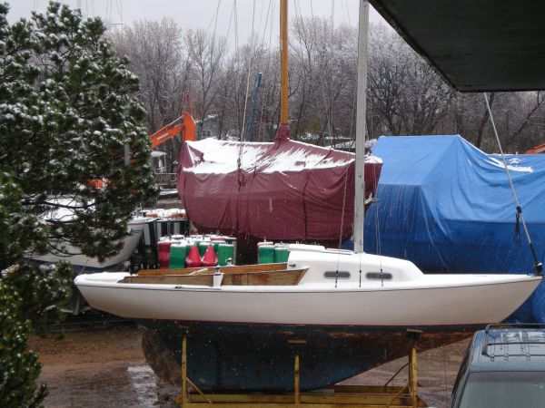

    So sad, pulled The Princess out today. Last boat out.
    Onto the winter list;
    1, Replace compression post and shorty bulkheads with header, full bulkheads and a door to give the head more privacy. (like an Ariel)
    2, Replace porta-potie with real head.
    3, Install inboard motor, I absolutely hate the outboard in a well thing. I intended to install an Atomic 4 I have laying around, but now I am planning on a 48 volt Mars brushless electric motor set up. less weight, no noise, I moor at a dock with shore power so charging isn't a problem. it looks like I will get about 1.5 hours @ hull speed or 4-5 hours @ around 3 knots with 4 group 27 deep cycle batteries. I sail a 14,000 acre lake without tides or currents so don't need even that much range.
    4, Bottom job. We got most of the multiple layers of old paint off with the pressure washer when t was still soft after haul out. VC-17 seem to be the best choice in our climate and waters.
    5, Paint freeboard and decks. Fill in outboard well in the bottom and recore the aft deck without the outboard lazerette to further clean up the lines.
    6, Rudder post bearing is badly worn and sloppy as well as the rudder to shaft bolts.
    I'm toying with the idea of teak decks, hmmmm.... Am I missing anything?

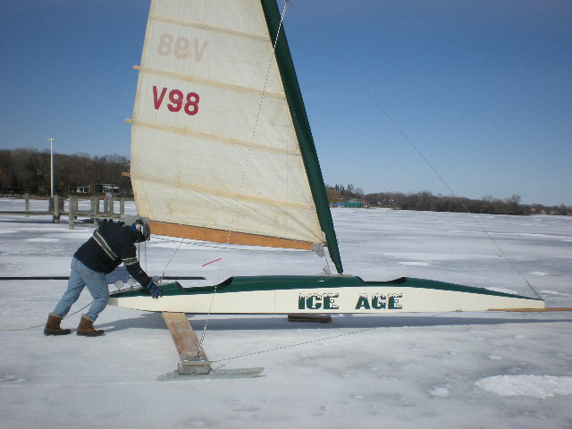

    Here in Minnesota, as we put away our soft water boats, we start dreaming about the hard water sailing. Time to dust off the Iceboats.
    I get my winter sailing fix in my Skeeter. She'll do almost 80mph in a 25 mph wind.

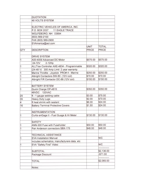

    Have you checked out EVA, Inc.? This link is to the website and below is a quote that they gave me for the same kind of electric motor repower.
    http://www.ev-america.com/EVACatalog.html
