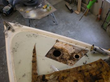

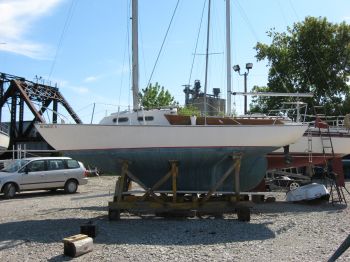

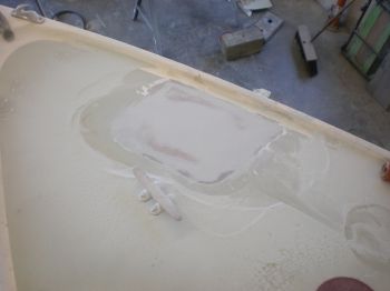

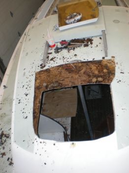

    My wife and I picked up this Commander in Milwaukee a few weeks ago and are doing a "quick and dirty" make over to get her in the water ASAP.
    The sailing season is way too short here in Minnesota to dally. Over the winter we will give her a proper bottom job, repaint the freeboard and decks, install an Atomic 4 to replace the O.B. and build some cabnets in the cuddy. Until then; The glass under all 4 of the life line stanchions was damaged and the core was rotten. The bow pulpit was loose with minor rot. Sailing on inland lakes the life lines, bow and stern pulpits are not necessary and I think they wreck the pretty lines of the Commander so they will not be going back on. The head pump out and the cowl vent looked like they were never sealed and the core around them was very rotten. The cabin top was also quite soft and I think the forward hatch also wrecks the lines so we have to recore most of the cabin top. As we are going to be repainting the decks over the winter I'm not to concerned with preserving the original nonskid so I am doing most of the repairs from the top. I step drilled and filled nearly all the old hardware holes as We will be replacing most of the original hardware. Amazingly, the core around the chain plates is dry. The cuddy had to be completly sanded down as there was a badly peeling paint job inside. I'll post pics in allittle while.

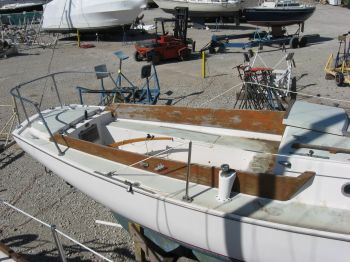

    Some "before" pics
    Some "before" pics

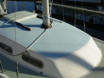

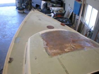

    Coach roof
    Heres the hatchless coach roof with new balsa core. I'm not sure if I want to reinstall the grab rails, I think I prefer the clean look.Name:  phpYCJSVVAM.jpg

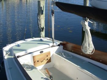

    New traveler
    New Traveler with mid boom sheeting (just gotta rig it like my Ensign)
    Yeah, O.K.,... the outboard controls are a little hill-billy. Just temperary till I can get the A4 in.

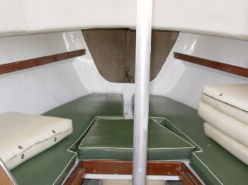

    Fresh cuddy
    Had just a ball sanding out and repainting the cuddy. But the end result is worth it. I have new cushions being made.

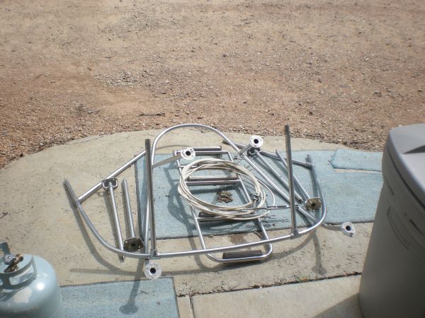

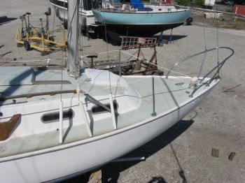

    Pulpit etal availible
    The pulpit, pushpit, stanchions and life lines off 227 are available to anybody who may need them within the Ariel/Commander class if said party is willing to arrange for (and pay for) packaging and shipping.
    The bundle as pictured measures about 5.5' X 5.5' X 2' which is probably larger than UPS or Fed Ex will handle. Pick up Zip is 55331. All parts are in really good shape, not bent up or pitted. I would love to see them go to good use within the Class so if you can figure out a way to get them to yourself without complicating my life too badly their yours.

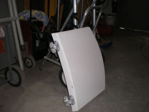

    Hatch too
    Same goes for the hatch. Its in pretty good shape, it does however appear to be painted with house paint.

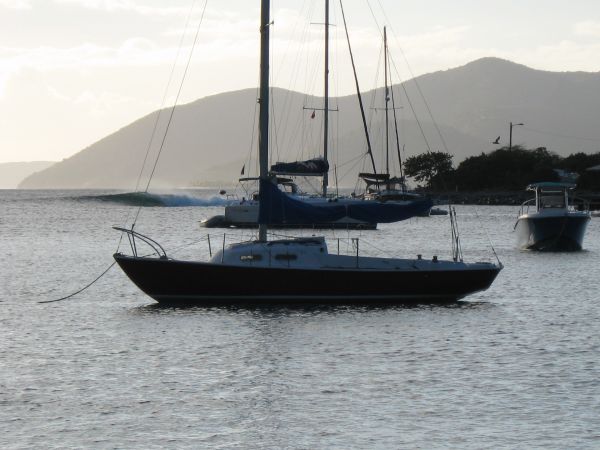

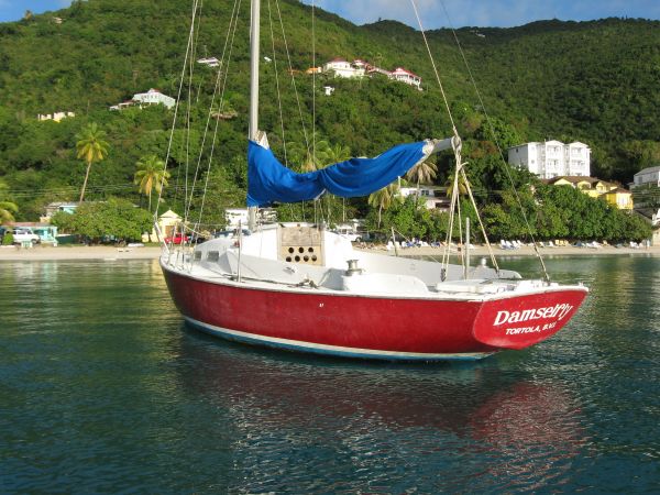

    Commander in the BVI
    I just ran accross these pics of a Commander I see when sailing in the Virgin Islands. What fun it would be to bang around the islands in a Commander instead of the sailing houses I'm always in.

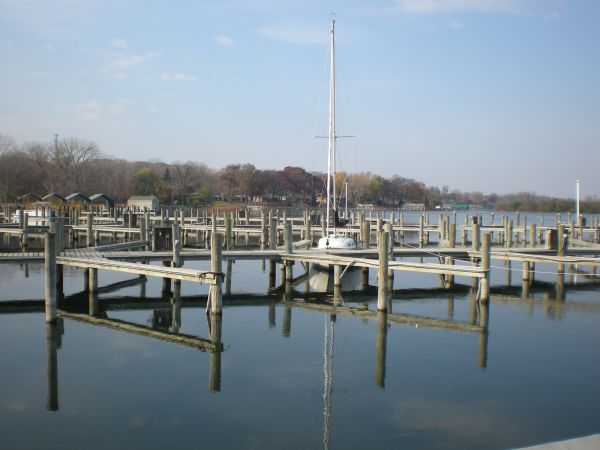

    Getting kinda lonley around here
    The end is nigh
