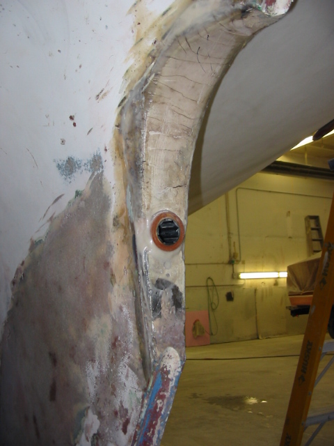

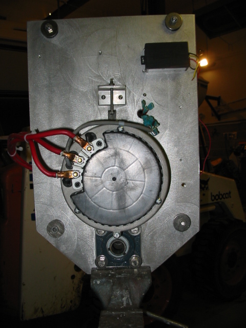

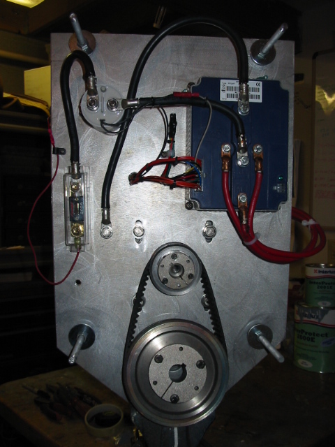

    Pic #1 Motor assembly forward side ready to install
    Pic #2 Motor assembly Aft side
    Pic #3 Stern tube and cutlass bearing

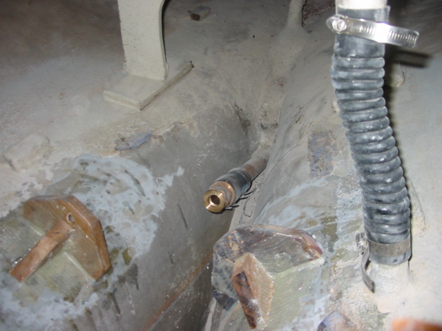

    Pic #4 Ex-outboard well
    Pic #5 stern tube, shaft log and lower motor mounts

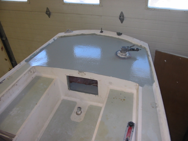

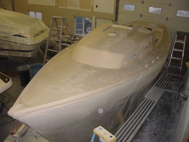

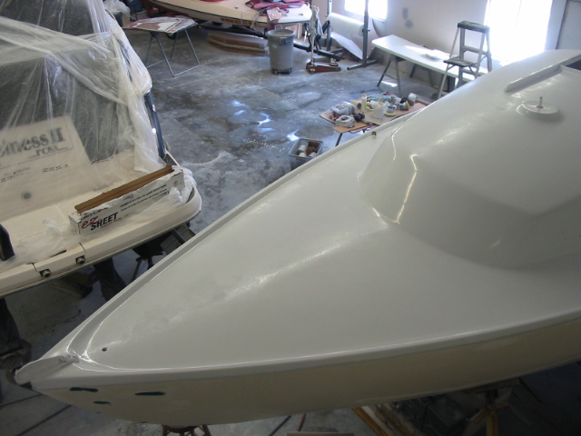

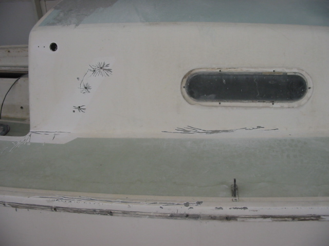

    Pic #1 New aft deck in gel primer

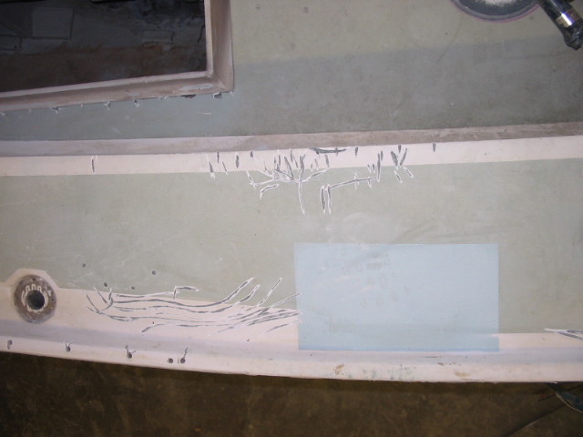

    Pic #2&3 routing out gel coat cracks (their endless)

    Looks like you are working steady at the mods and making good progress. Are you able to work on it during the day? I would guess the marina business is slow in your part of the world at this time of the year.
    The 4 large bolts on the corners of the plate that the motor and controller are mounted to I assume are to bolt the plate into the boat. Did you glass in another piece of deadwood to the bottom of the cockpit floor to bolt the top of the plate to?
    I can't wait to hear your final report on how well your setup works.

    Quote Originally Posted by Commander willbe View Post
    Yes, exactly, I glassed in a white oak 1 x 3 under the cockpit floor for the top mounts. The 4 long pieces of threaded rod with a nuts and washers on either side of the mounts will give me all the adjustability I will need to align the motor assy. to the shaft.

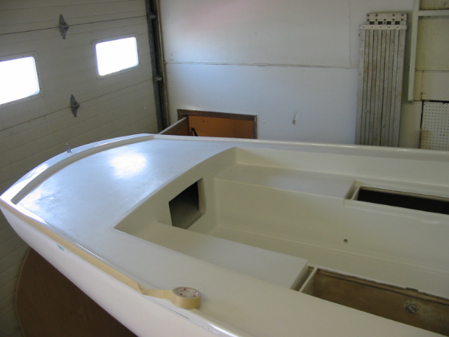

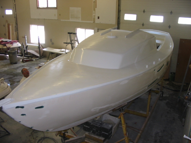

    Decks

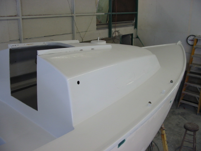

    It's funny how much work can get done when you're willing to cross a few palms with silver!!!!!! while I was away screwing around in the BVI look what happened to the Princess. The decks were primed with Duratech, sanded out, then painted with Awlgrip. The finish is beautiful and it hasn't even been buffed out yet. The non-skid is Awlgrip course additive.

    More pics
    The freeboard was sanded today and they will prime it tomorrow.

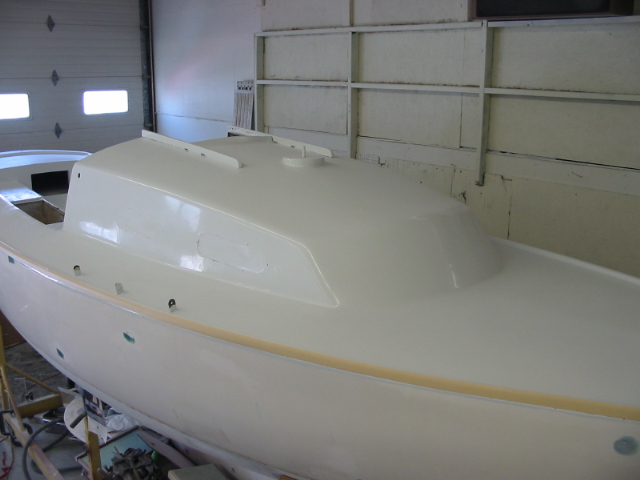

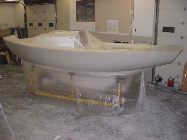

    Primed Freeboard
    The Princesses freeboard was primed today. she will be sanded out in the morning and will hopefully be sporting her new topcoat by the afternoon. Then the fun of trying to place the waterline and make straight tapelines. The color? You'll just have to wait and see.
    Willbe- Yeah, to me the trick is doing what I can and just bucking up and paying for what I know I can't do well. I know I don't have the patience to paint... I fall into the "Beat it to fit, Paint it to match" category. I'm trying not to think about what I'll have into this boat, but I'm certain it won't be anywhere near the $95,000. they get for an Alerion 28 or even the $42,000. for a new Ensign. I think it will be closer to the $7,200. they are getting for a new Laser.

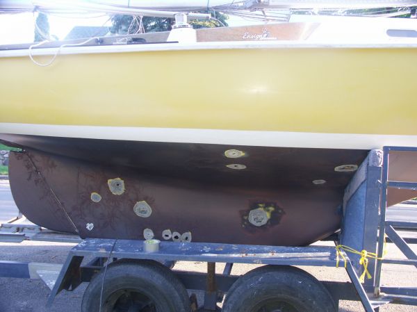

    Quote Originally Posted by carl291 View Post
    Commander227,
    Nice work, and for only a few pieces of silver? It would appear you are going for the "biggie size" Ensign look! Speaking of the Ensign, could you post some eye candy photos of the Yellow hull Ensign you were repairing, that's a beautiful boat.
    Good Luck
    Carl
    You're right Carl... Deep down I just want my Commander to be like my beloved Ensign. My Dad bought Ensign #1117 new in 1965 and has sailed and raced the boat every year since. He turns 80 in a few days and he still kicks my butt every Thursday night. All six of us kids learned to sail on Tranquility and developed a love for the sport.
    I bought Ensign #1525 over ten years ago and am shocked to only find these few pictures of Serendipity. I love the boat and plan to continue to sail and race her. there are nearly 50 Ensigns here on Lake Minnetonka and they are raced at three different Yacht Clubs on the lake.
    My wife and I decided to add the Commander to our little fleet so we could have more creature comforts such as a head, roller furling, inboard motor and stereo for daysailing with guests and our relaxing night sails.

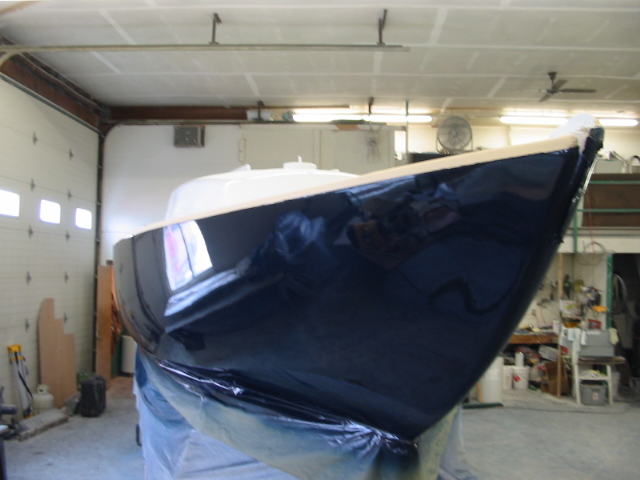

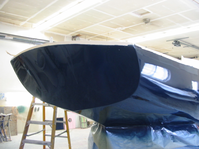

    326

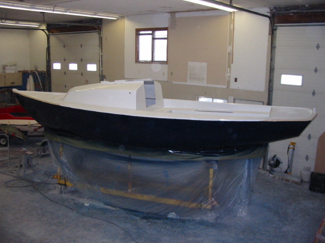

    Freeboard
    The princess was fitted with her party dress last week but the third coat had some minor problems with fisheyes. after the finish had cured enough she was wet sanded and two more coats were applied. My painter recommended not buffing her out for a month to allow the Awlgrip to harden up. I will let the finish harden up until the weekend then try to sight in the waterline and have it painted. Bob and Tim did a great job with the decks and the freeboard, it really looks good!!!(the pictures don't do it justice)
