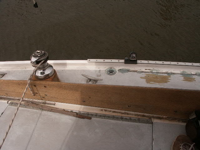

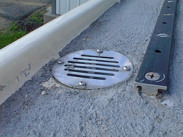

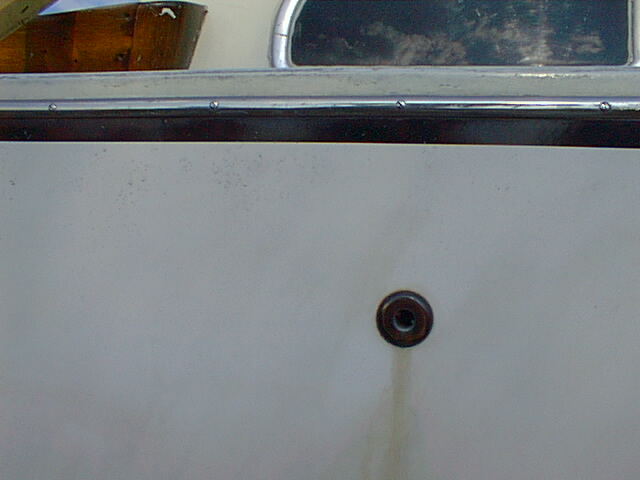

    Somewhere along the line one of the previous owners intalled deck scuppers. At least I believe one of the POs did it because I've never seen nor read anything about them on any other Ariels. I like the idea of ridding the decks of trapped water but I loath the big, ugly water stain on the topsides. Placement is questioable too. I have leveled the boat by the boot stripe and when it rains(or worse yet snow melts) water pools aft of the scuppers! If you notice they located them forward enough to go through the cored section of the side decks. Everything seems solid there but locating them aft alittle further would have made more sense to me. When I look at this pic I see three things I'd like to change. We're open to ideas and criticism(gulp)-Tony G.

    Hold it! That's the wrong picture bvut I can still find three things I'd like to change. Let's try it again.

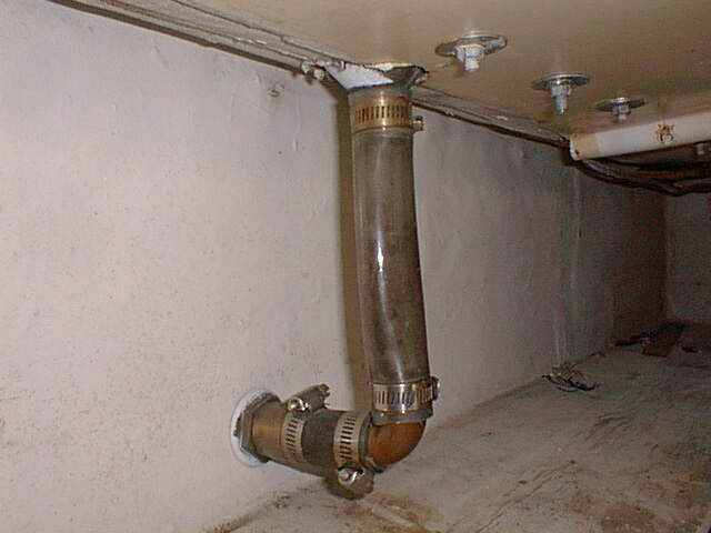

    that's the toe biter! Here's the inside(I know you're on the edge of your seat by now).

    I agree, that is about the ugliest scupper installation I've seen
    On higher numbered boats, the factory appears to have moulded in deck scuppers aft of the cabin trunk. The outlet is at the waterline. An earlier owner added scuppers to #76 and used flat faced bronze through hulls at the deck and rounded through hulls at the water line. Hole diameter could have been larger, but is ok.
    Also, in the case of #76, the scuppers were placed ahead of the boat's low point where the water collects. I'm sure it was the low point at one time Just another reason to keep the weight down in the after most part of the boat.

    Yeah, without a doubt I'm with Bill, I do have the ugliest scupper intallation. I had planned on removing the original through hulls for the head which would include some grinding and laminating and filling and fairing and fairing and fairing. So maybe that would be an opportune time to move those deck scuppers. I really wanted keep it( the work) below the waterline but I guess I'll just have to do better work topsides.

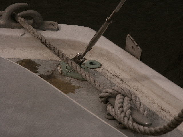

    And here is the one in the deck corner ,

    You've lost me on the second pic. Is that your lazerette hatch in the fore. Maybe the starboard corner?

    Port corner of stern, stainless plate is new chain plate for split backstay , there is an identical drain in the STBD corner .
    2,267
    Mike, I wonder if that part of the boat's stern was re built (maybe when the split backstay was installed?). Most of the boats have a break in the toe rail at each corner to allow for water egress.

    I split the backstay myself last summer , all the glass work in the lazarrette looks original ( except for a spot in the center of the transom where she got rammed ), I have been standing on my head in there several times in the past year .
    The 2 drains above the transom drain into hoses that go to the outboard well .
