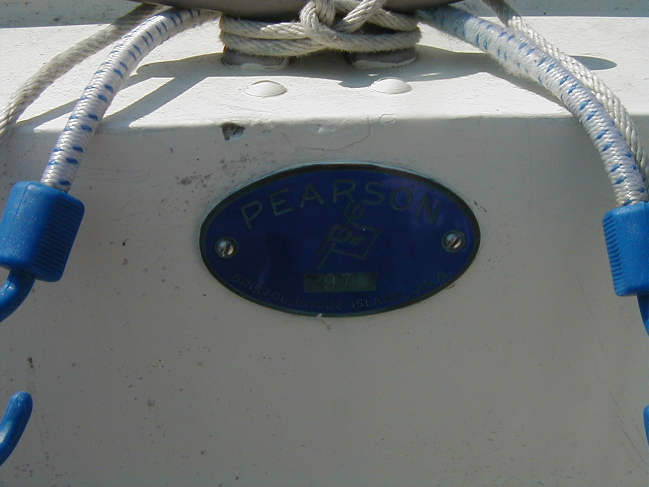

    Went down to see her today, probly start on pain next week, but I was looking for the plaque that would have her hull number, If you on you way up the campanion way would it have been on your left next to the hatch door tracks? If so it's gone!
    2,307
    Quote Originally Posted by tha3rdman
    Original location is on the aft bulkhead in the cockpit just below the traveler. If not there, look around. Maybe it's in a drawer? Otherwise, is there a number on the main? If not, find a former owner

    Ariel #97

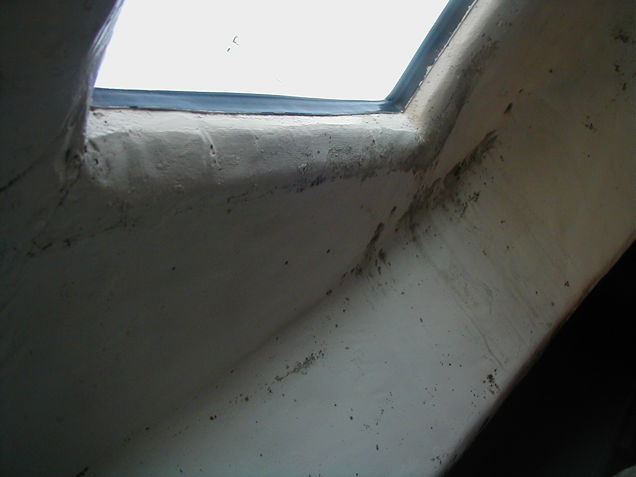

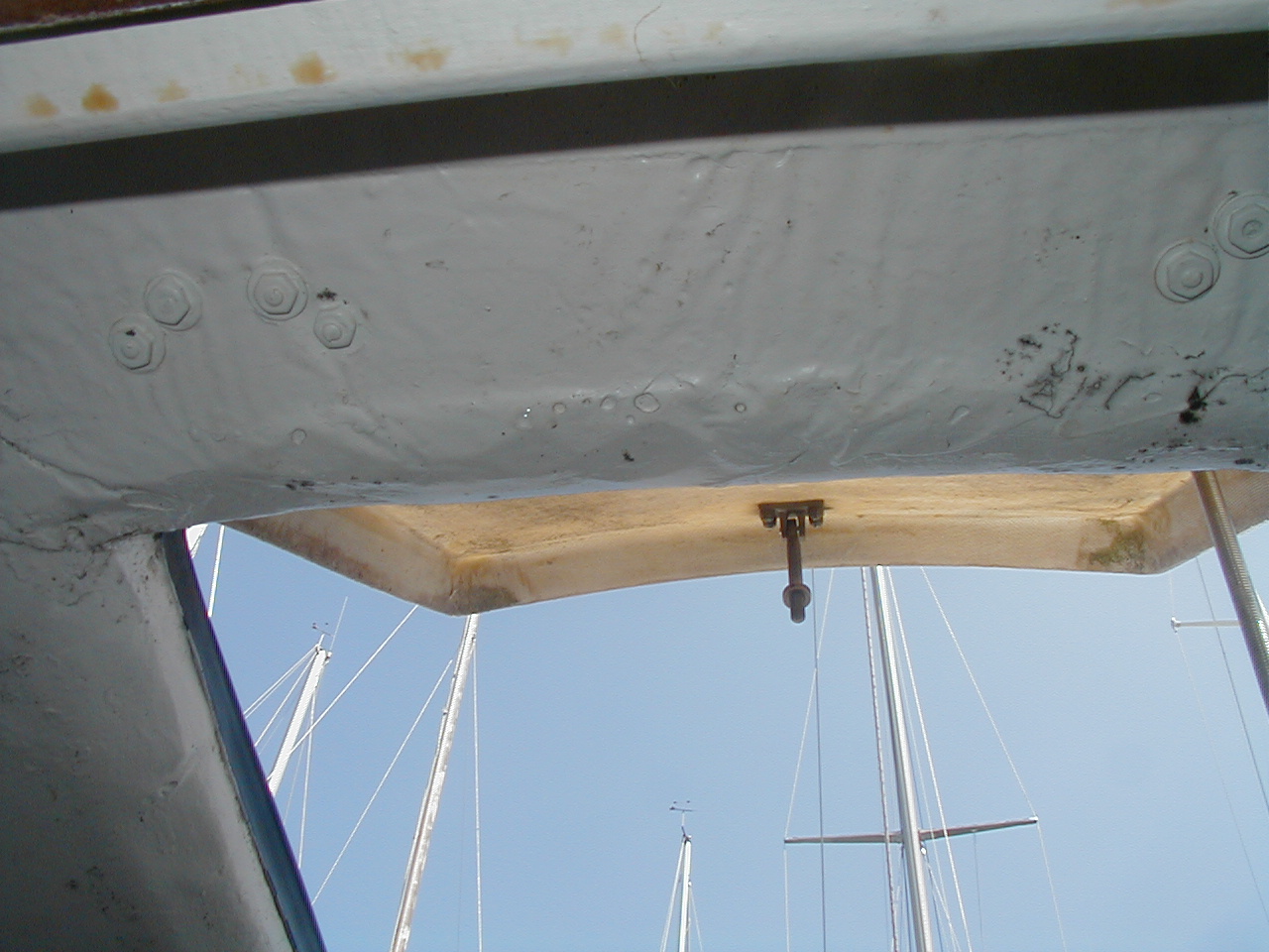

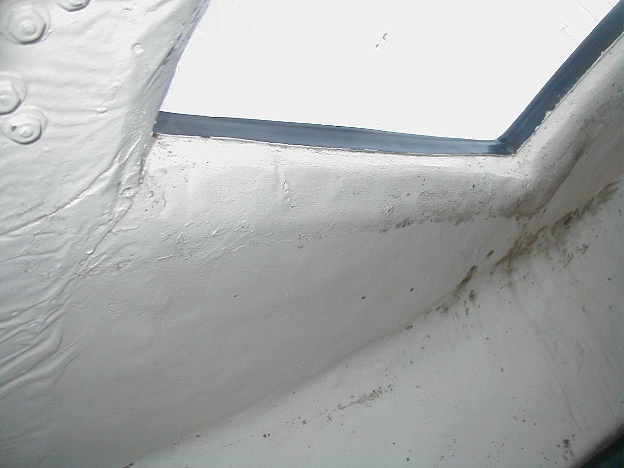

    I found it, was hiding behind the tiller, any how here are some base line shots.
    All the dark stuff in P3300037 is Mold

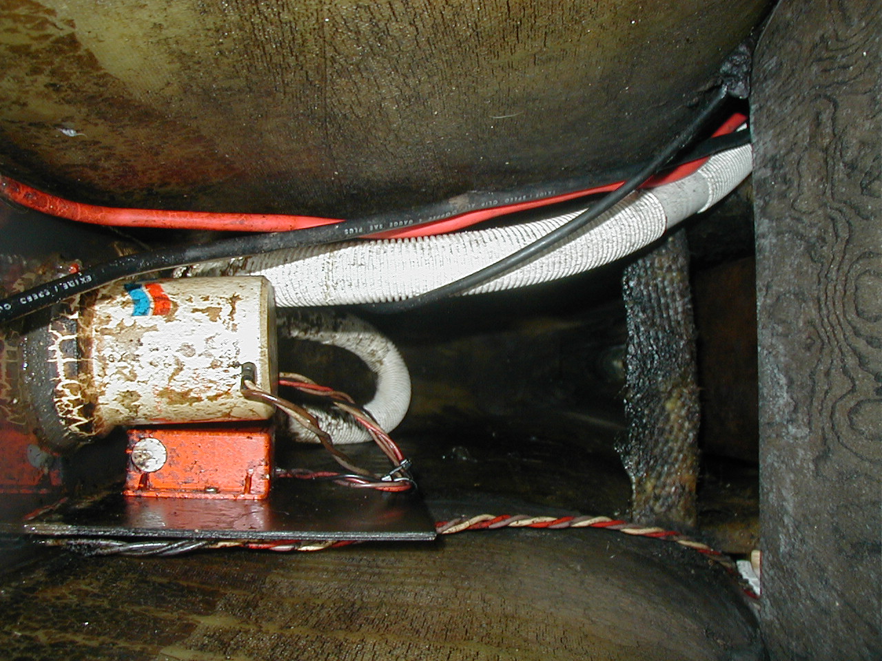

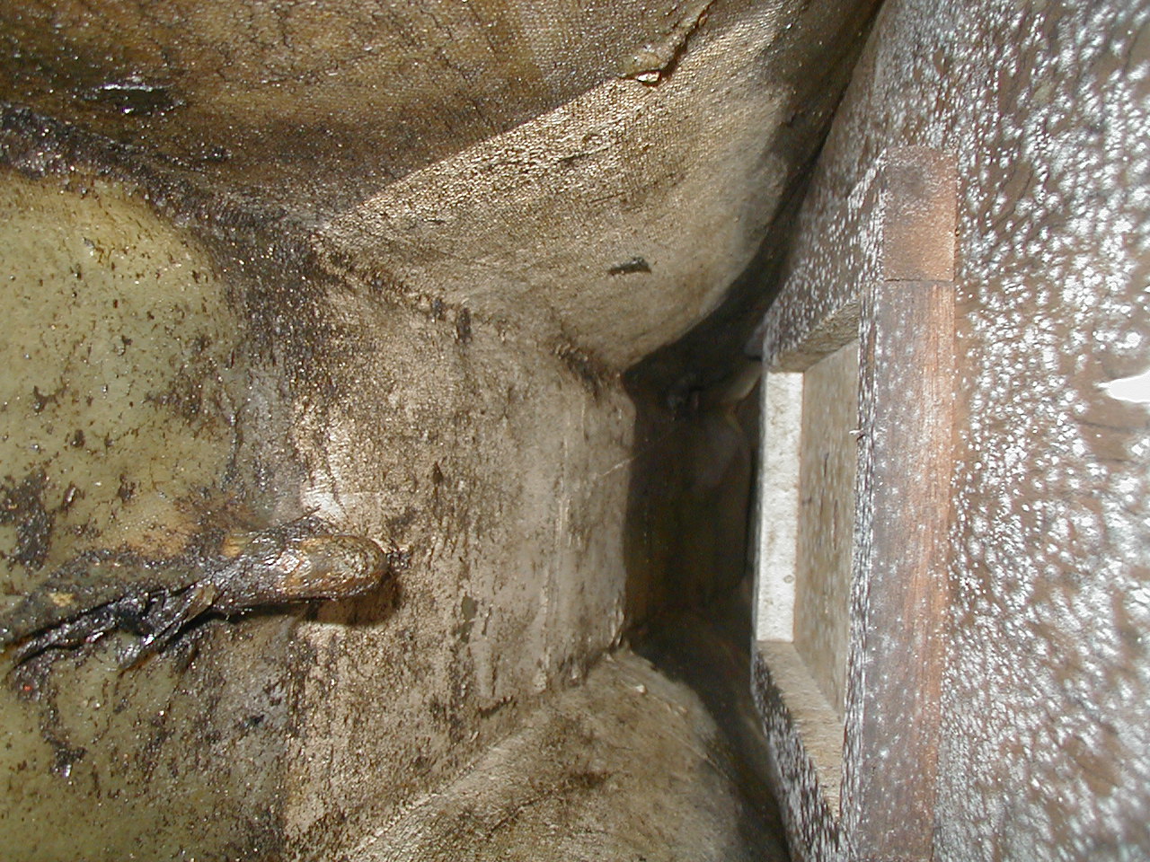

    Bilge pictures.

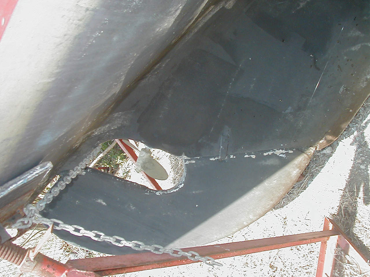

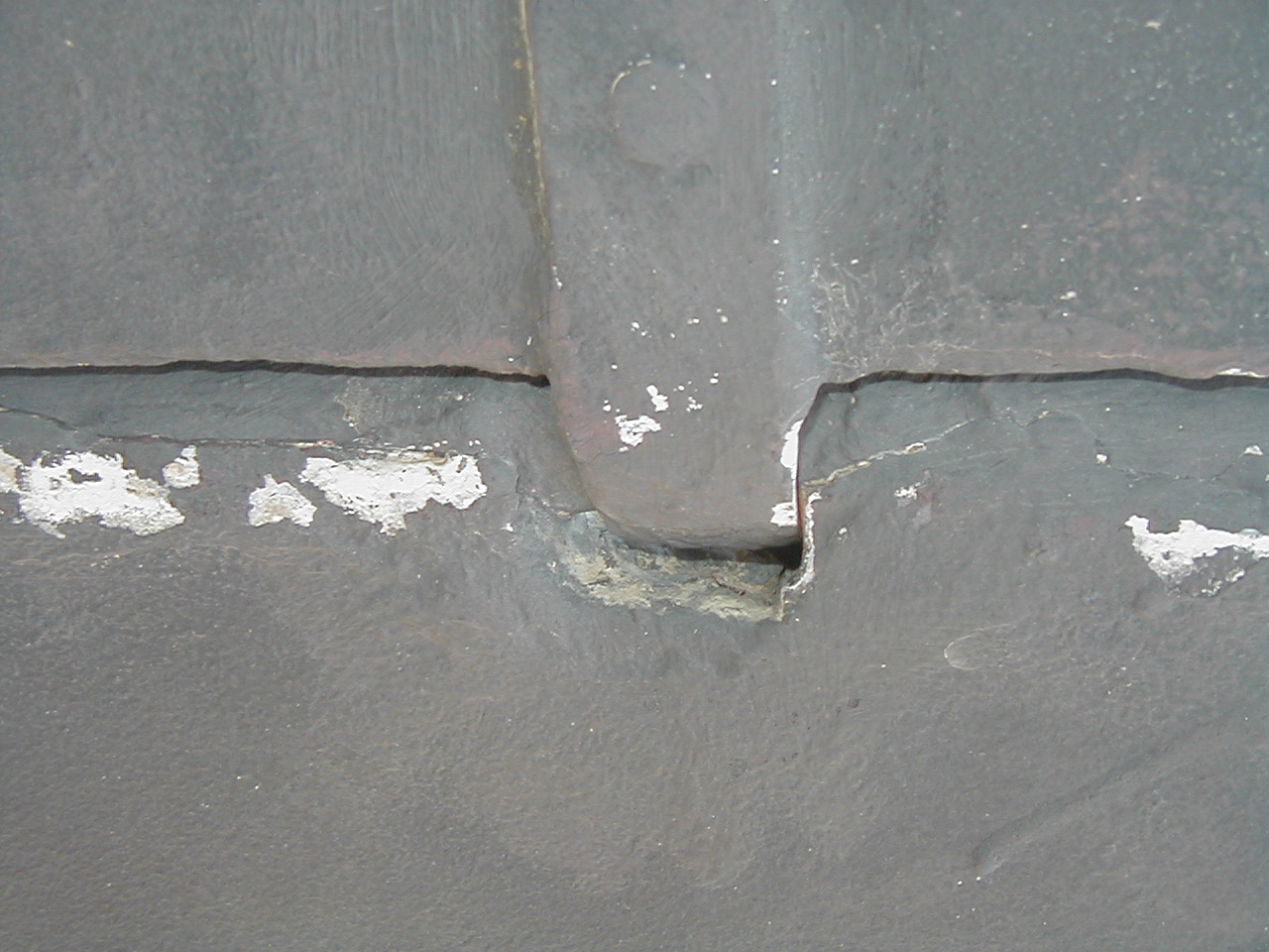

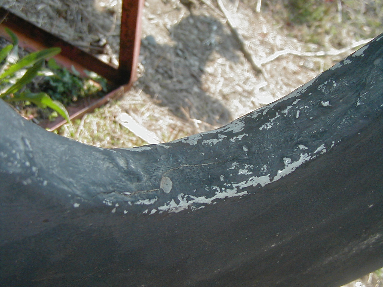

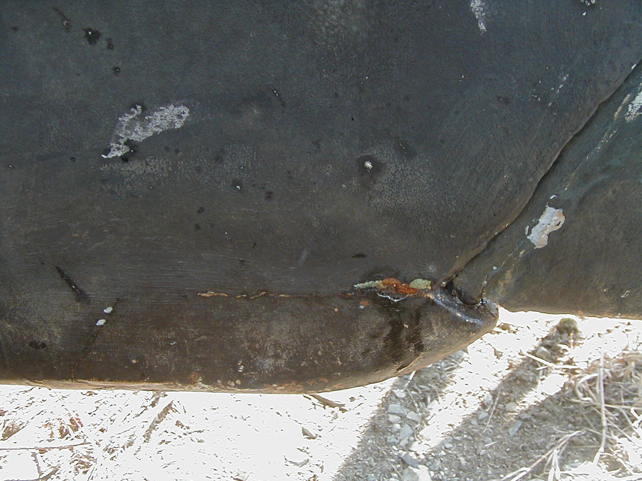

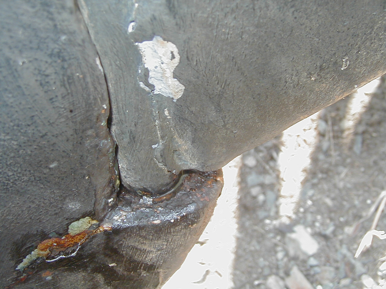

    Rudder concerns . . was thinking a little glass would do well here.

    IMHO, the rudder pics you show don't look too bad to me. Keep in mind they are wooden rudders that some have later covered with glass. The stuff I noticed in the pictures looks (to my eyes) to me cosmetic.
    Those here that have had issues, usually talk about the rudder shaft. Of course you would have to pull the rudder shoe to get an idea of where you are on that.
    (others will have more insite as to the value of that undertaking).

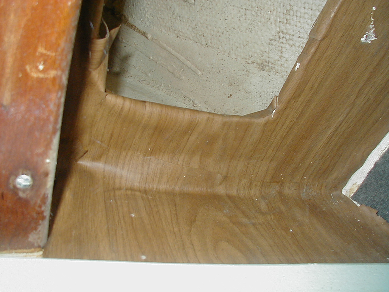

    The main reason for the reply was to ask;
    What am I looking at here?

    that is under the forward berth, looks like some generic paper made to look like wood veneer.
    Previous owners painted the entire forward bunk blue, and patched some other stuff, seen in the pictures around the vent.

    I concur, the rudder looks ok. you might want to strip back the paint in the area of the rudder shoe and the bronze strap in order to check for wear and fractured fiberglass.
    The trail of water coming out of the rudder shoe may be worth investigating. My boat showed that symptom when there was water in the keel. A series of cracks around the rudder shoe was one of the sources of the leak into the keel void on my boat.
    Looks like you have a worthy project!
