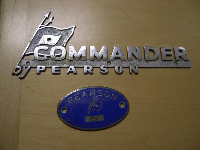

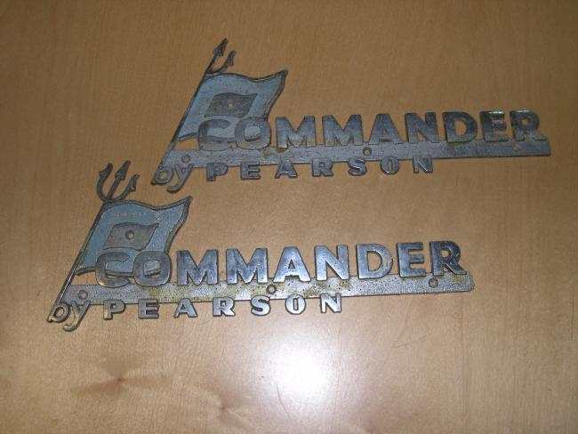

I have a couple questions for the collective wisdom of everyone here on restoring the metalwork for my commander. When I'm done with her restoration I would really like to install the Commander emblem on the combing so when she is at the dock and people are strolling the dock looking at boats (like I often do) and they see this beautiful boat sitting there but don't know what she is they will be able to figure it out. But both of the emblems are corroded and one of them has a tine broken off of the trident. Also my hull plate is corroded as you can see in the picture below.
What are my options to correct my issues? Ariel 109 (Ben) I know you are really good with metal work. I hope you will chime in but I would also like to hear from anyone with experience restoring these parts.
Can these parts be restored to like new condition? Am I better to have them remade? I need advice.

They are available new I think from Bristol Bronze, but not finished.
What you show in your photo looks to me in very good shape.
That's the two pronged Triton spear there, isn't it, on top of the blue peter?
Couldn't you have them plated? Chromed? Nickel would be perfect schmaltz.
Left plain would be cool, but the blue background could be painted in after and clear coated.
I believe some threads also had photos of restored and/or new emblems and builder plates.

That Pearson logo flag is also found as a burgee, but not 'authentic'.
>flag chick< on ebay features the burgee on the page that came up with a three-prong staff and navy blue,
but she advertises custom - and I think reasonable.
Maybe she could be persuaded to do it correctly???
All the other Pearson yacht owners might appreciate it.
I think the Pearson blue on the plate is called MEDIUM FLAG BLUE
OK I spoke to Roger this morning
And all of the parts you listed Bill appear to still be available and based on the fact he told me the Commander logo was $105.00 each I think the prices are the same also.
I asked him if he was going to update his catalog soon and he said he had no plans to do it soon.
Roger is very interested in getting any original parts from our boats so he can make castings from those parts. He will return the original to the owner and then he can include these parts in his available listings going forward.
He said he had the large port lite available (I assume for the Ariel) but then he said it was 2 feet by 3 feet which did not make sense to me. I am contemplating sending him one of my fixed port lites so he can make a mold while they are out of the boat.

Bronze Builder's Plates for Ariels and Commanders
The Pearson Oval builder's plate that came off A338 is some sort of dull silver pot metal that hasn't corroded in any way I can see. Looks almost crisp and new.
It does NOT have the BluePeter color background and there doesn't seem to be any sign of scraping or wire pad marks.
There is around the letters tiny pits that look like what you'd see if the piece were sandcast and too close to the embossed letters to be buffed away.
It's obviously not pressurecast pot metal.
Across the bottom of the oval it stands embossed as BRISTOL, RHODE ISLAND, U.S.A.
(Trip to the Jersey Shore thread - post 124 - the S-boat oval Herreschoff builder's plate is a dead ringer for the Pearson's. Assume except for size and material, the proportions and lettering exactly the same!)
The drawing in the Bristol Bronze catalog also shows an oval generic builder's plate that has PEARSON across the top
and PORTSMOUTH, RHODE ISLAND, U.S.A.
Assuming Roger has not made any of the Bristol plates, is there any interest in this Forum in having a bronze plate made?
My (assume original) pot metal plate looks in pretty good shape.
I might be persuaded to mail it to Roger
so he can use it as a casting model
IF I get a written promise from him to return it. And a bronze one that I will of course pay for.
Anybody interested in a bronze BRISTOL, RHODE ISLAND builder's plate?
