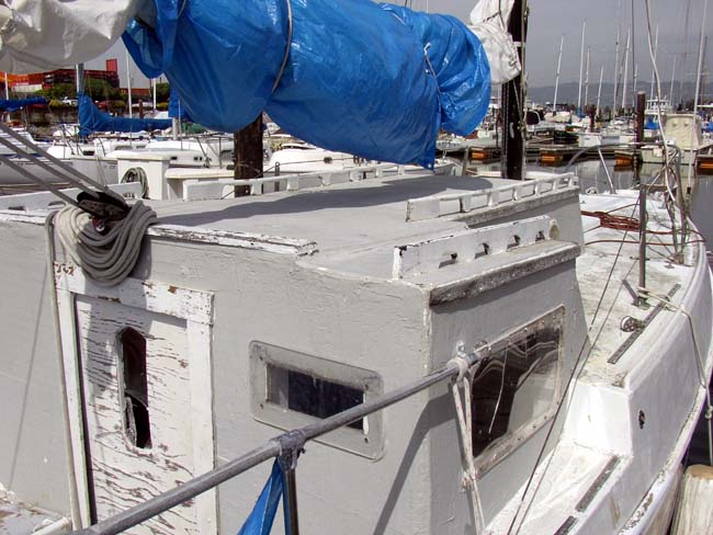

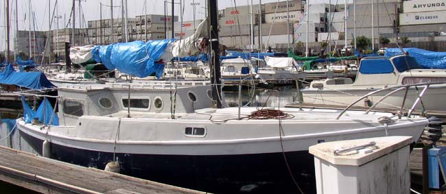

Hard Dodger Example
Hey Ebb, here's a Cal 25 sporting a hard dodger similar to what I understand you are planning . . . :p
In this hard dodger
the juxtaposition of circular deadlights with the angular is particularly gratifying. The designer, obviously with safety in mind, has kept the openings quite conservative in the event of boarding seas. Hard edges and flat planes will cut any comber to pieces thereby shrugging off and canceling the weight of the water.
The multi-purpose flat top will be useful for solar panels, sunbatheing or keeping a goat tethered. Clever use of WWII mindsweeper grey is in keeping with the whole nautical theme. And the crawl-thru entrance with its centrally located recessed latch is curious - but safe, no doubt - as is the paucity of dangerous vents. Everyone has his own limits. All in all an interesting effort!

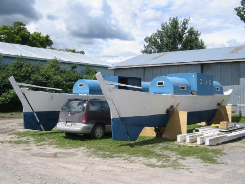

Boat Porn
Hey Bill, Enough of this boat porn ! 1st Commander Pete and now you when will it stop . I doubt if even one of Pete's gals would make that boat look good .
If you're gonna do it, do it right.
As a kid we had a double ended steel lifeboat painted black and gray. It was about an ugly a boat as you could want;however, we had more fun motering up and down the Delaware River and Bay. I bet the owner of the sail boat pictured thinks it beautiful,looks like its used alot. I must have bad eyes or am having somekind of 60's flashback but are there really two identical boats pictured above, who would make such things and what are they used for? At first I thought they were some mass production pleasure craft for patriotic workers from the old Soviet Union or East Germany untill I took notice of the American auto. :o
