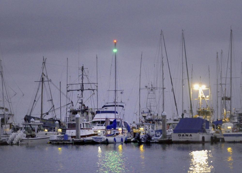

Can't find an all-round-red/all-round-green combined lamp - in the market.
....imco an all-round mast-top lamp must be combined with all-round white 'anchor' light.
As well as a strobe for the white. Freighter at sea - no can see me - no can me see.
(I can 'see' the lamp... stack of LED hockey pucks. The NewSealanders (Hella) can do it.)

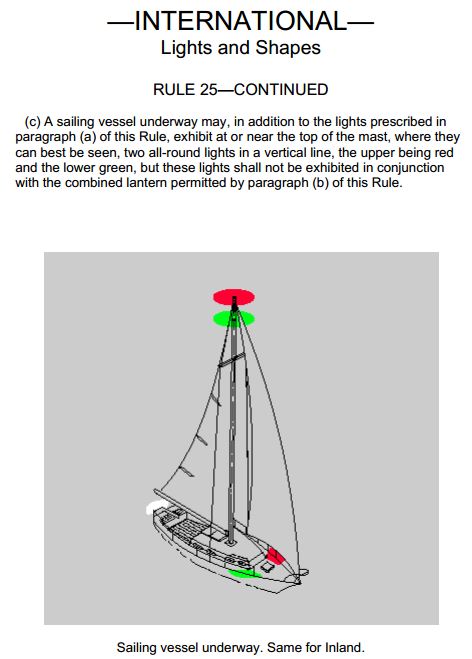

SAILING VESSEL UNDERWAY. COLREGS Rule 25:
(a) a sailing vessel underway shall exhibit i) sidelights and ii) sternlight.
(b) In a sailing vessel of less than 20 meters length the lights prescribed in paragraph (a) of this Rule, may be combined in one lantern carried at or near the top of the mast where it can be best seen.
(c) A sailing vessel underway may, in addition to the lights prescribed in paragraph (a) of this Rule, exhibit at or near the top of the mast, where it best can be seen,
two all-round lights in a vertical line, the upper being red and the lower green,
but these lights shall not be exhibited in conjunction with the combined lantern permitted by paragraph (b) of this Rule. [tri-color]
We can therefor exhibit a combined Red Over Green mast-top light in addition to the required red and green side lights and white stern light at the gunwale (boat-deck) level. Can not show masthead tri-color together with deck side lights. Or tri-color with R.O.G.
Assume we have legal deck lights showing when maneuvering near shore under sail after dark.
We are permitted at this time to ALSO exhibit a mast-top Red Over Green. [imco, the more moving colored light you can legally show over a dark backdrop - as when approaching the marina at night, with confusing dots of white light from dwellings, streets and freeways - the better!]
PLEASE CONFIRM THIS INTERPRETATION.

RED OVER GREEN - what does it mean? When sighted, it will instantly ID the light as SAILBOAT. A good thing offshore.
Why not integrate this exceptional SAILBOAT SPECIFIC navigation aid with our little ships... before Rule25(c) is removed from Colregs for lack of use?
