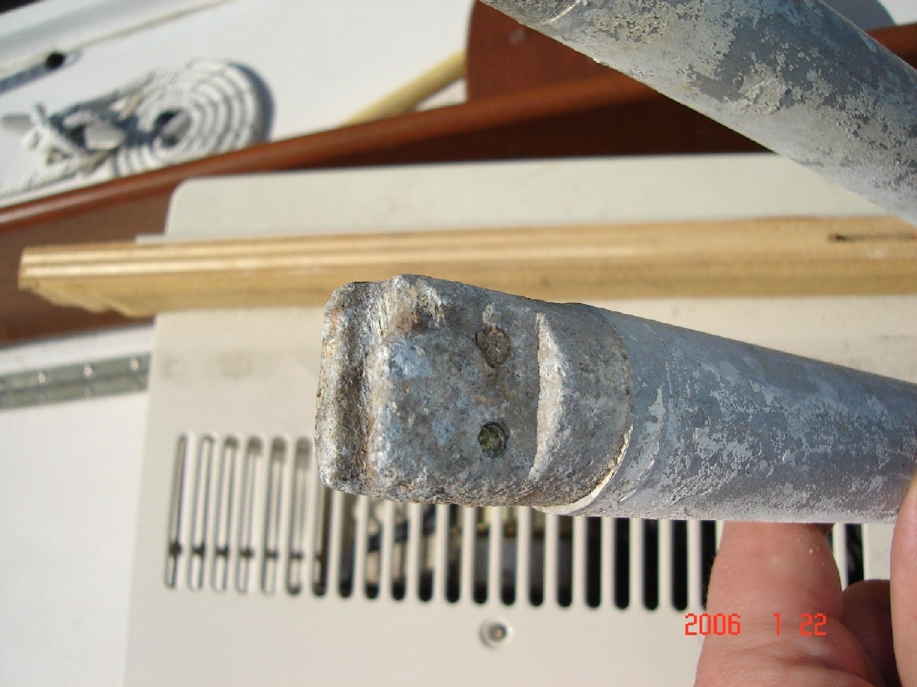

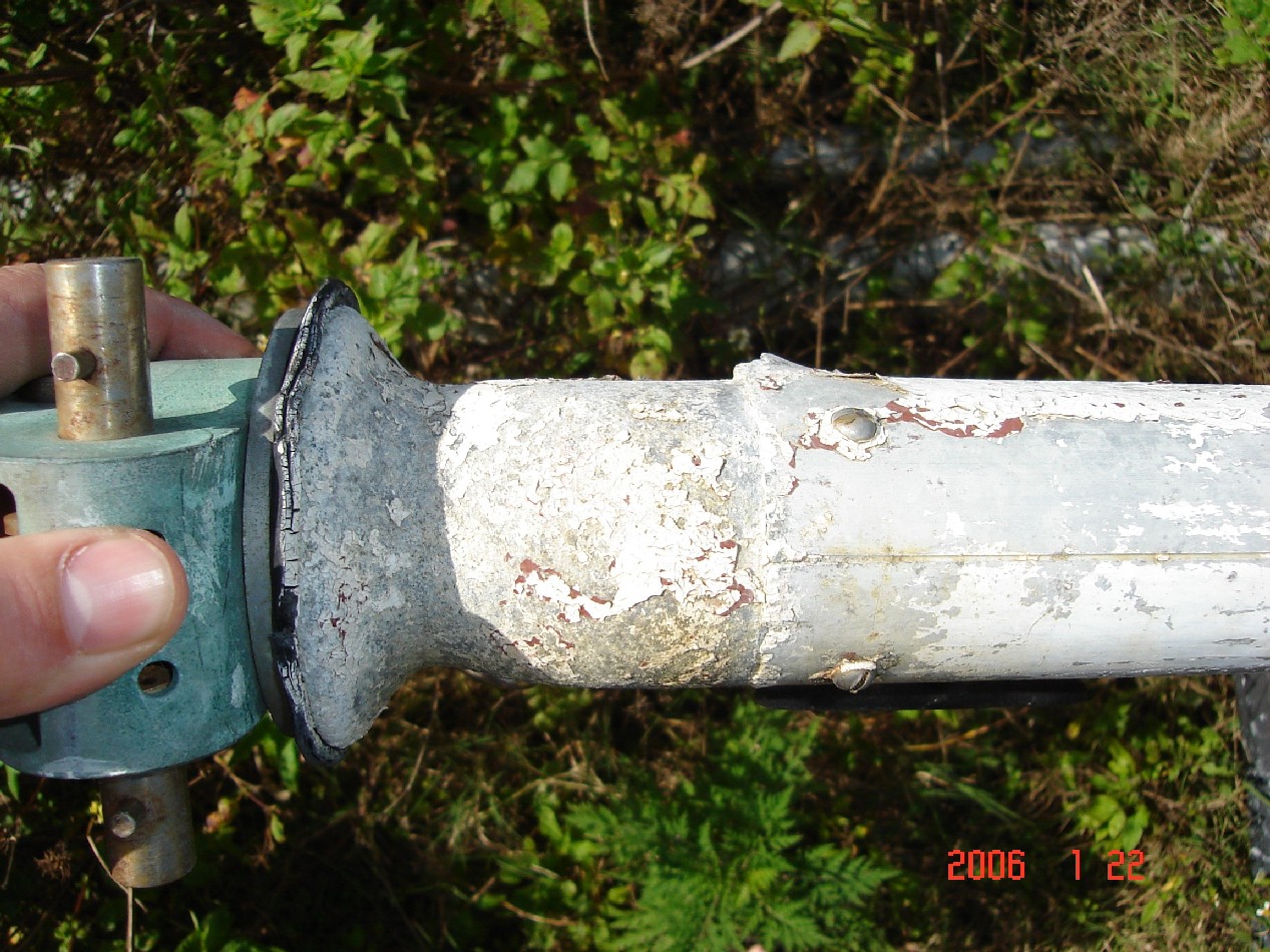

When I took over "Althea" last weekend, I noticed some pretty extensive corrosion on the spars. Spreader tips were toasted, and the boom has a nice bulging spot at the head fitting joint. Spreader tips seem pretty straight forward, I should be able to find a local machine shop to spin me up some new ones from the old samples (unless someone has another suggestion), however in the case of the boom I'm stumped. I've contacted the OEM spar supplier from the manual, and also a few others...and of course no one can match the original extrusion. So here I sit with these perfectly good heads and I can't get an aluminum stick to fit between them...I've though of shortening the boom by a few inches but I'm a little trepidatious about sawing away on my Alberg beauty without asking some of you knowledgable fellows first...so how 'bout it?
I believe Robert bought new spreaders from Dwyer

I'm not familiar with that gooseneck casting. Anybody seen one of those?
Looks too large for the boom, like it was pounded in there
Checked those spreaders out today Pete...they look great, and for a good price too! So, the spreader issue seems resolved...
I spoke to the fellows at US Spars today...they quoted me a good price on a new complete boom, but of course...good or no, it's still too much bread for me. I just can't see shelling out for a whole new boom set up when I've got perfectly good fittings on it.
What you see in the photo that appears to look like the head fittings are oversize and jammed into the boom, is actually just corrosion product that has bulged one side of the boom...the other side (on the same end) appears perfectly normal and corrosion free.
Everything I've been reading says that cutting an inch or two off the boom extrusion and refitting the heads should not cause any trouble, other than possibly having to slightly modify the cut of mainsail...and the obvious performance effects there of. Still just don't know...but I guess the worst case is, it doesn't work out and I have to buy a new boom anyway?!? As long as I take a set of pre and post measurements and document well...

In the first few years of production, Pearson used a roller furling gooseneck similar to your's.
I just don't think it looked the same. Didn't stick out so far.
Anybody???
Anyway, there's no problem cutting the boom back an inch.
