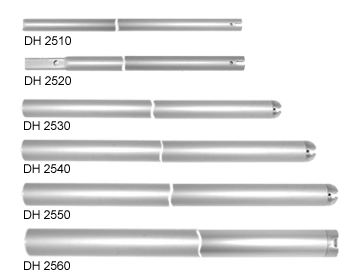

    I recently purchased two spreader bases to replace the old damaged ones. What I need now are the aluminum alloy spreader tubes and end fittings, D&R does not seem to have them and our local pipe and tubing supply places don't have sutible replacements either. It seems that the outside diameter of the tubes are not standard. I could however make some sort of hardwood replacement for the end fittings or have something fabricated from aluminum block. Does anyone have any experience or suggestions?

    You should be able to find some aluminum tubing of the right size. Check mcmaster.com or onlinemetals.com
    They might have it at Rig-Rite
    http://www.rigrite.com/Spars/SparParts/Spreaders.html
    You may need to look around the website. They sell some spreader tips.

    Might also take a look at Dwyer Mast. Prices don't seem bad.
    http://www.dwyermast.com/items.asp?c...ts+%28Round%29
