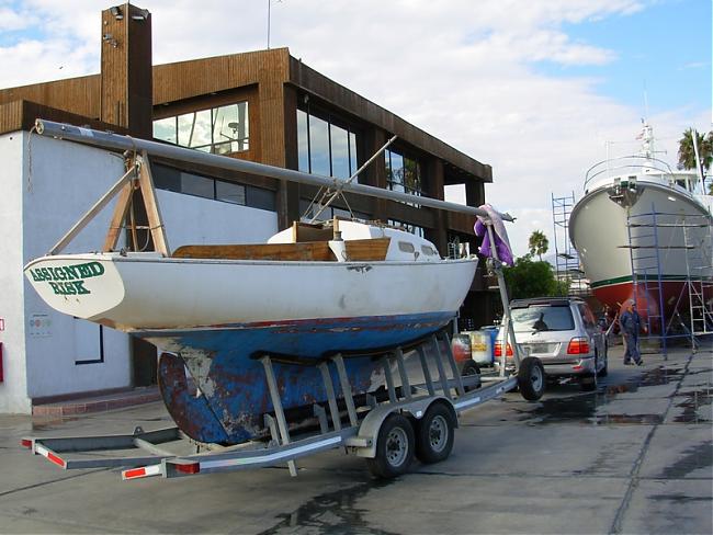

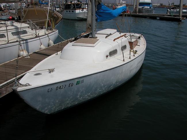

    Well here she is C-187... The photo (Photo 1) was taken at our first meeting in Mexico... taken July 2008.
    (I did not know the hull number until I checked in with Bill’s database which showed the CF number and I can now confirm this with the actual paperwork – there is no number plate in place…)
    She was patiently sitting in the marina at the boatyard where I put C-155 'Mephisto Cat' in the water in July of 2008 for the sail North. (Details on the Mephisto Cat here: http://pearsonariel.org/discussion/s...ead.php?t=1552
    I was assigned a slip at the boatyard’s marina where I was to set the boat up to step the mast, and much to my surprise there was this Commander sitting in the adjacent slip...
    She is in pretty good shape, with all the bits & pieces in the right place, but she was obviously sad & dirty due to being neglected. The only things actually missing were the Hull number plate, the original navigation light fixtures (there are some cheap modern ones in the front of the cabintop), and one of the two little steel plates that surround the opening in the top companionway slat where the lock plate goes through. Otherwise it is all there...
    She is an outboard model with an original-looking well in the lazarette, but there are also some indications that she may have had an inboard out of the factory. There is some post-factory looking glasswork where the prop opening would have been and then the opening in the rudder itself… This filler piece may have just been lost over time, but it is hard to say… I’ll have to look at the area where the inboard would have been to confirm. The rudder, rudder shoe and rudder shaft are in excellent shape. The decks are solid and without stanchions – likely the reason why they remain solid!

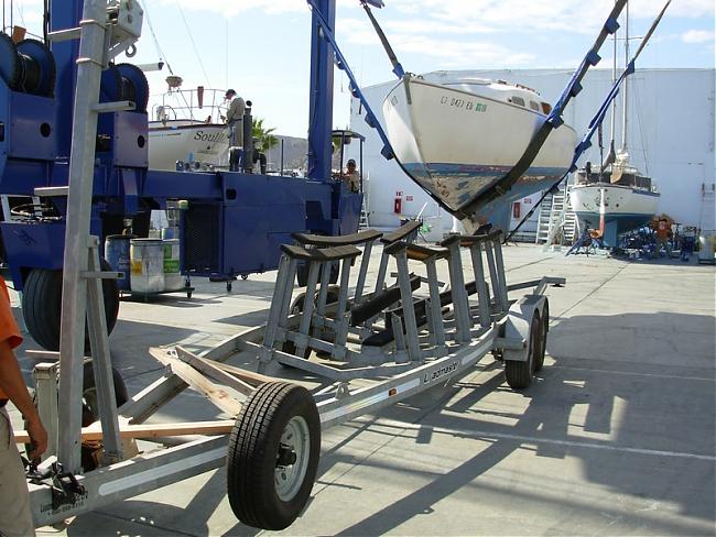

    Picture 2.- Getting ready to unstep the mast & haul her out after a painfully slow row to the travelift... It was only a couple of hundred yards, but with all that junk on the bottom she was hard to row!

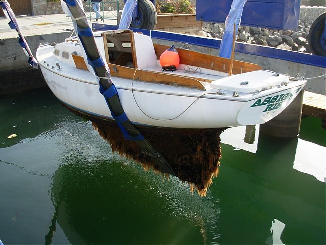

    Picture 3.- How often do you guys scrub your bottom and do your bottom paint? I think I can go a few more weeks, no?...

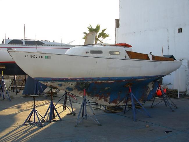

    Picture 4.- Ahhh... The mast is off and the bottom is clean and prepped for new bottom paint... But we'll wait for prep & bottom paint until she is ready to go back into the water...
    I has happy to find the bottom in good nick... no blisters and looking pretty good for being so thick with growth! I guess the salad just sticks to the surface...

    Picture 1.- Surely the straps won't slip with all that mess on the bottom! But better safe than sorry!

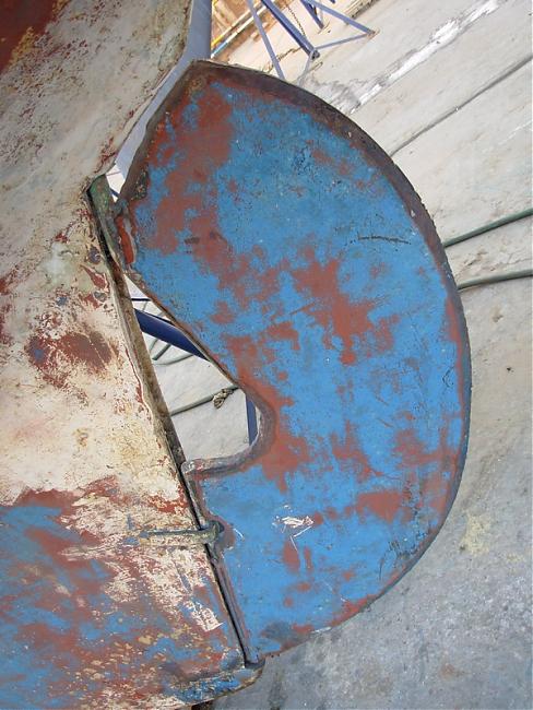

    Picture 2.- The rudder is very solid and in good shape. So is the shoe (barely any wear on the shoe and post connection). I'll have to fill in that prop hole. This will be an O/B Commander!
    Picture 3.- Going onto the trailer...

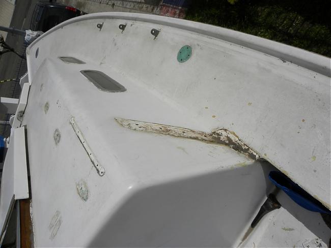

    Here are the first few photos of C-187's refurbishment.
    The disasembly work os completed and prepping for New Gelcoat is underway.
    Due to the ridiculous amounts of Silicone on this boat; I would like to remind everyone that the use of Silicone is hereby prohibited...
    Silicone was used on this boat as: bedding compound, Electrical fixture fastener, sealant, glue, paint, backing plate, Nav-light lens, miscellaneous fastener, filler, flotation device, snack - everything everywhere was coated with the stuff!
    On the other hand, perhaps silicone is a good perservative... - I can barely find any evidence of use on this boat! It must have had a very easy life, or just not used much! It is clearly old and weathered, but the usual wear items; Rudder post, rudder shoe, etc. seem as new! (I do not think they have been replaced, but who knows!
    In any case, the silicone cocoon is gone, and none will return!

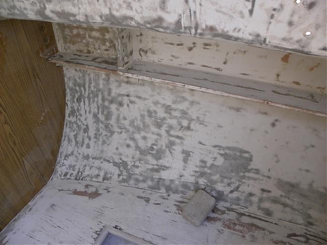

    Stripped of all hardware & brightwork. The portlights, Hatches, chainplates etc, are all off now as well. Not a sailboat any longer at this point... just a bare fiberglass shell.
    Photo #2
    The inside is completely stripped as well! Getting ready for a nice, clean, and easy-to-clean new gelcoat!

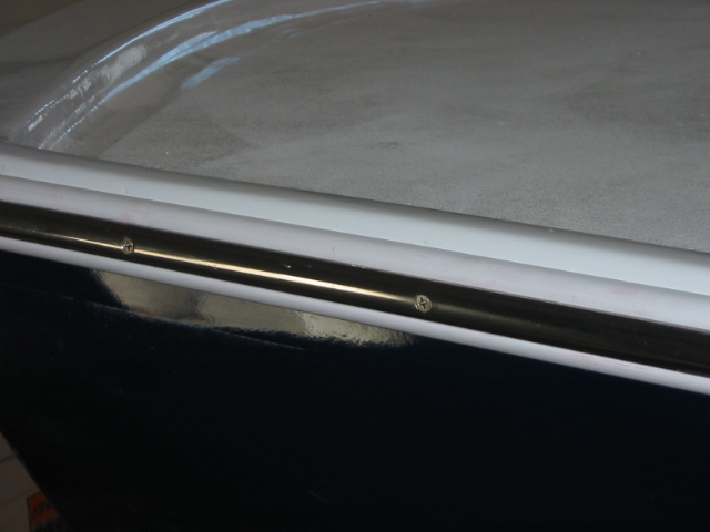

    The Hull to deck Joint. No movement here! Everyone worries about hull to deck joints on sailboats... Never heard of any problems with these Alberg boats! These are pretty-well built boats... but I cringe severely everytime I see the rubrail fastening concept used by the factory...
    As I've mentioned previously, I do not think that a rubrail is much use other than to introduce holes right into the joint, and also a great way to spread the damage as much as possible if you do rub against something... But I am tempted to install it as people expect to see it... (*) Hmmm...

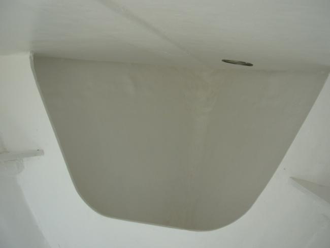

    A bit slower than planned - but coming along nicely...

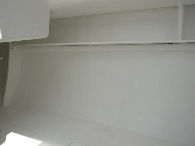

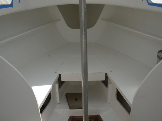

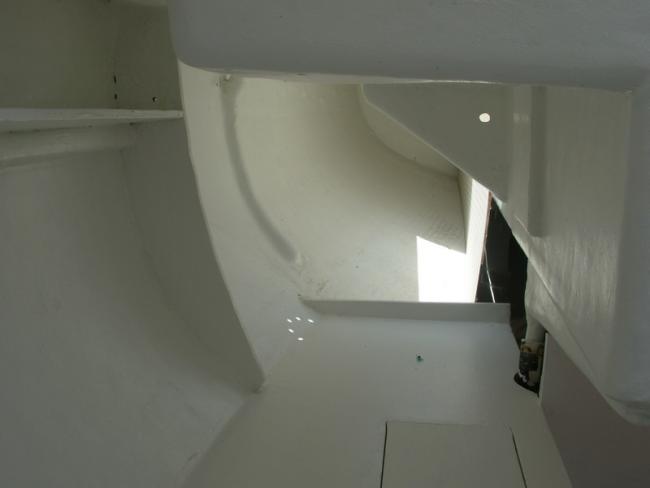

    The interior was cleaned out and the old coating removed as shown above. The gel-coat is now in place and the boat looks and feels much better...
    The chainplate supports have been reinforced, and the area located at the point of the bow has benefitted from Guillermo's attention of some ding suffered in the past. It was not readily apparent, but it became obvious during the prep work.
