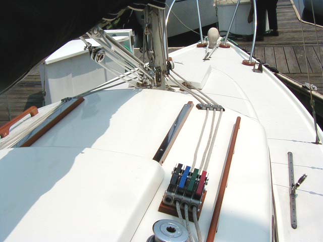

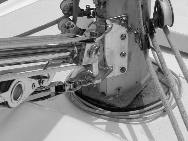

    Here is a photo of the vang attachment at the mast.

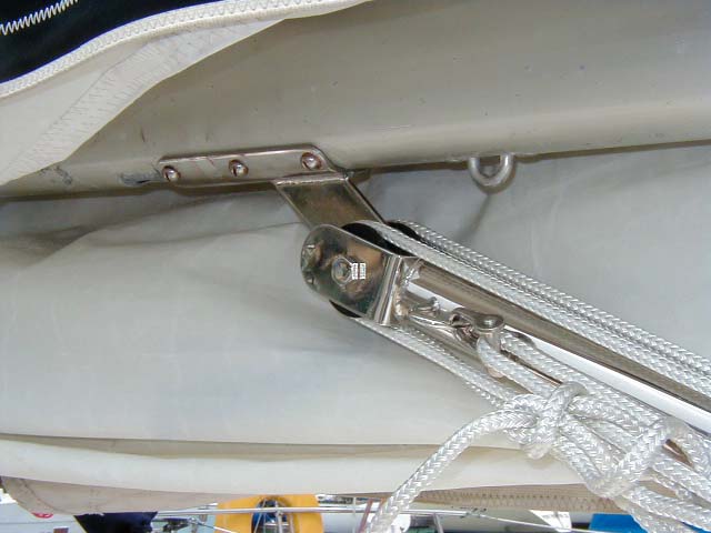

    Boom end attachment:
    View of line controls:

    dumb question:
    there is a nice solid piece of stainless steel there, why the lines that look like a non-rigid boom vang?
    what is their collective purpose? backup?
