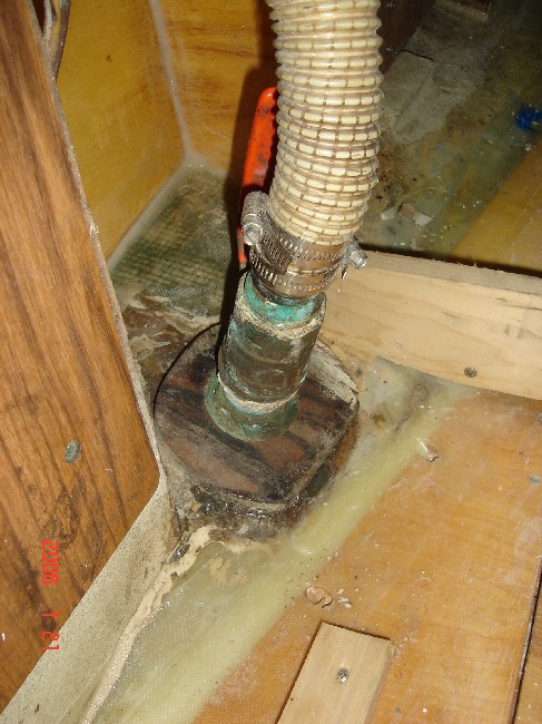

    I know this topic has been covered in several other threads, I just wanted to get some feedback on my particular issue with Hull 387. My forward drains are run to seacocks (which are not properly installed and will be replaced or filled in at some point) and I'd like to know if this is even "safe". They appear to be below the waterline, which raises some trepidation if I ever take on some big water in the cockpit.
    I plan to install aft drains and run them out to the transom at some point, and I wonder if I shouldn't do something to change the arrangement of these when I do that? Perhaps elbow toward the aft and run a length of pipe to a rear exit? Or is it possible that this configuration is "ok" and I'm just a worry wart? My concern is hydraulic forces when the hull "see-saws" forcing water up into the cockpit, and/or preventing it from draining after taking a shot from a rogue wave...the other concern is perpetually having seacocks in the open position that could potentially cause a flooding risk.
    Does anyone else have this current set up in place on their hull, and if so what effects have you seen...or if anyone has suggestions on modifications, I'd love to hear them...

    Hope somebody has pics of a proper install to post here. Scott...?
    You might try the SEARCH mode in the bar above.
    Your pic shows a dead wrong install with a ball cock and what looks like above waterline sanitation hose. Imco only black rubber heater/type marine hose (or better) should be used where a thruhull is below the waterline.
    If you are going to use bronze for thru-hull and SEACOCK make sure the two pieces come from the same maker. Grocco, I think, supplies a set. 338 will be installing Marelon.

    Quote Originally Posted by cjackson
    . . .My forward drains are run to seacocks . . . and I'd like to know if this is even "safe". . . . is it possible that this configuration is "ok" and I'm just a worry wart? My concern is . . .a flooding risk.
    The only difference to your drains is that the original factory installation did not include seacocks. Yes, this is "safe," but adding drains at the aft end of the cockpit might be a good idea for one planning an ocean crossing. That said, the stock arrangement has made a number of ocean crossings without a problem. Zoltan's Commander (see thread Commander in Greece) even used the open engine well as an effective cockpit drain!

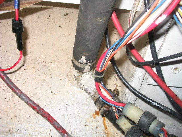

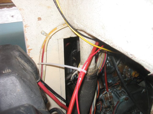

    Here are a couple of my survey pics of the port side cockpit drain. The second shows where the sink drain is tied in at the hull.
    I have to add a couple of drains in the after part of my cockpit before the boat goes back in the water - it's either that, or plumb my cockpit hatch to a through hull. But I'm thinking I'll try and drain those from the transom...

    Don't believe that hose should be used for any below waterline connection, unless there is a seacock. (A ballcock is not a seacock.) Putting drains in the back of the cockpit is a problem as the distance between cockpit and hull is so short. Because this is an inaccessable area hoses should not be used. Even an access hatch would not get you a good look at corner drains. The rudder tube would also limit access - but it's not a bad idea to have access via a hatch into this area. Might consider it mandatory if you have an inboard or have made it difficult to get back in there with cabinetry in the cabin.
    Better would be vertical drains going thru the rear bulkhead and then thru the transom. Since the function of the extra (oversize) drains would be to empty the cockpit quickly, they can be reasonably above the cockpit deck, letting the forward drains empty the cockpit completely.
    The cockpit in the Ariel HANGS unsupported into the space it occupies. Hose has to be used for all cockpit deck drains because of movement and flex.
