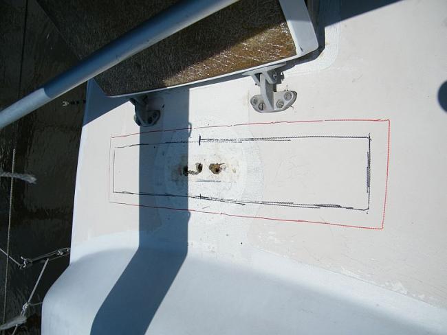

    The area of deck to cut away - added about 1" all around the tabernacle base. Cut on the red line with the SoniCrafter tool, using the half-circle blade. Hey Tony - see how close I was to the hinges? Maybe 1/2". I have even more aprreciation for this tool after today - more on that in a bit.

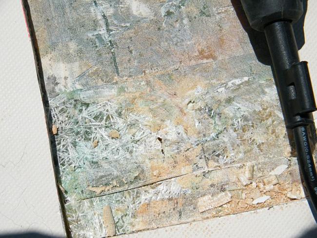

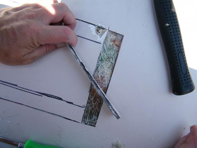

    Outline cut, & first try at top skin removal. I was really hoping I could manage to peel up this whole piece and then re-use it elsewhere, but the 40 year old FRP was just too tenacious. I wound up cutting with the tool and fighting to get this little piece off. Going from this point, ripping about 1/3 of the skin off, it came off very irregularly, tapering up from the edge to just a last, 1 thin layer of glass at the end. Hmmm...

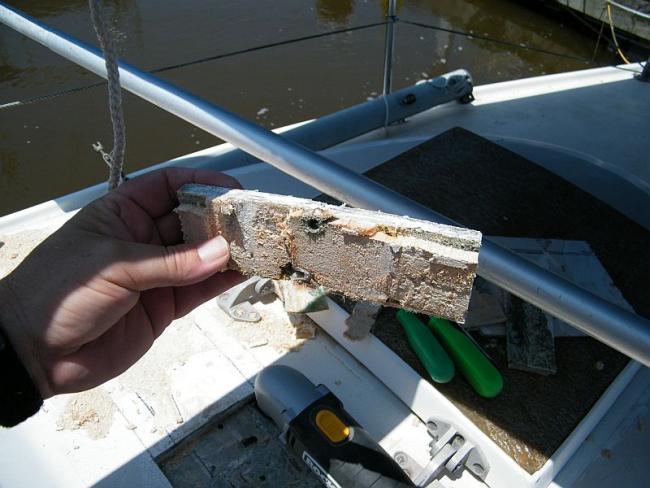

    Broke out the SoniCrafter, and BAM. Perfect tool for this. Use plunge blade, Insert into core, cutting that free all the way across, then cut across the skin at about the point which would have been maximum plunge, and you get nice clean blocks of skin and core.
    A 6"x2.5" block takes maybe 1.5 minutes to remove, and the surface underneath you can almost eat off of. You can use the blade to clean off the underskin.

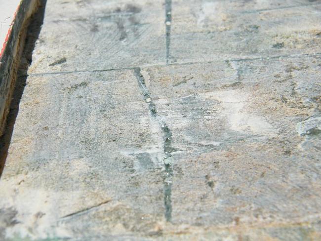

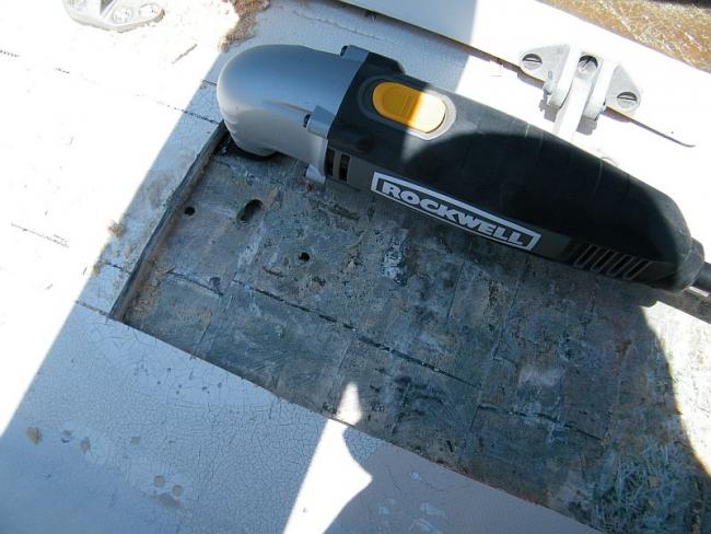

    This shows the first area - where you can see ripped mat at the lower part of the pic, from me pulling the skin off of the core (or trying to, at least). Contrast that with the SonicRafted area in the upper part of the pic, and you can see the improvement.
    An example of a cut block using the tool. This was one of the first, they got even cleaner.

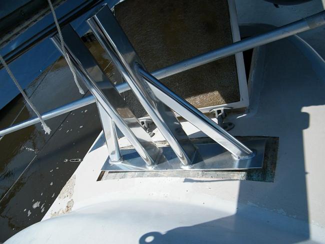

    A couple pics of the tabernacle sitting in the deck hole....

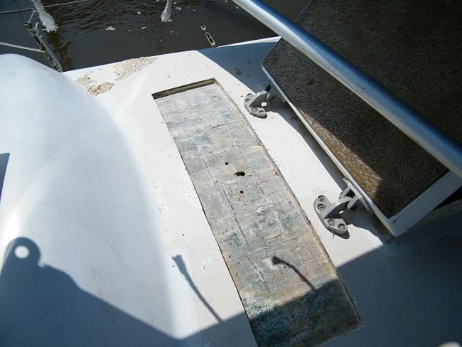

    The deck hole itself, in all its glory...

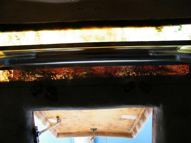

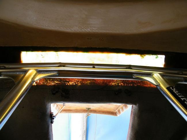

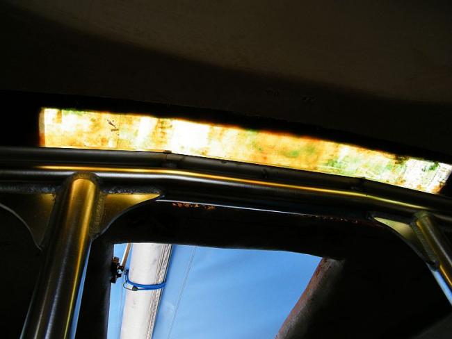

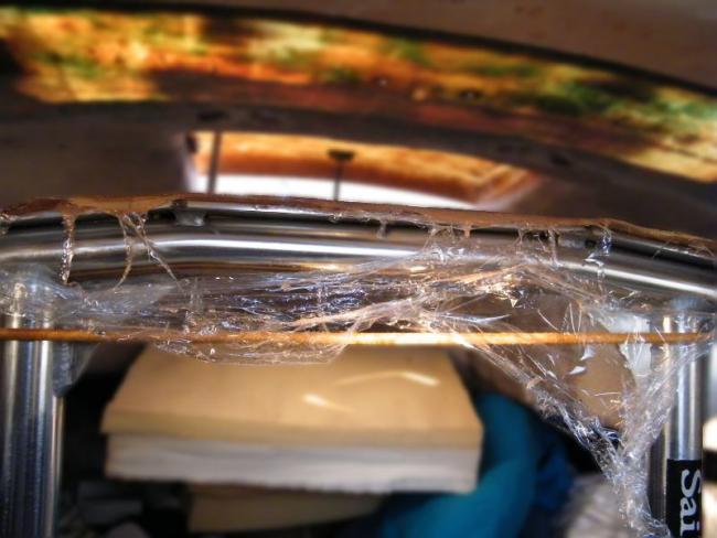

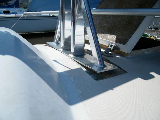

    Last for now, these 3 pics show the strongback against the overhead, where the light is shining thru the 1 layer of skin left there.

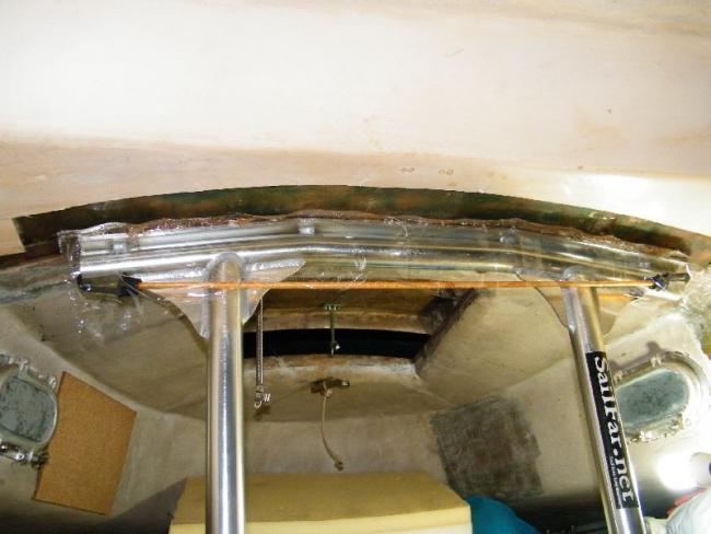

    A lot of those pictures were on my old, now-defunct 'liquid-epiphany.com' website. Posted 'em there, with the good intention to save some bandwidth for *this* site/Bills wallet. Best laid plans, gone awry - as is not too uncommon... :/ I still have the pics, around somewhere, probably in several places. Which ones in particular were you looking for, Ebb? I could start by taking requests...

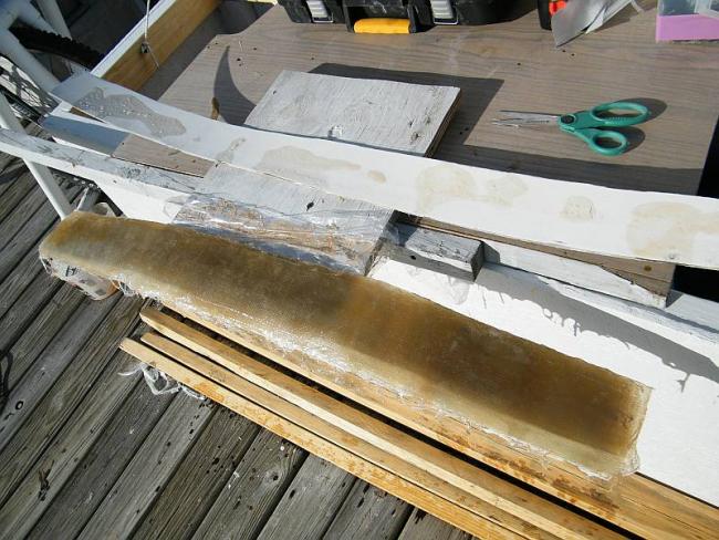

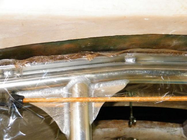

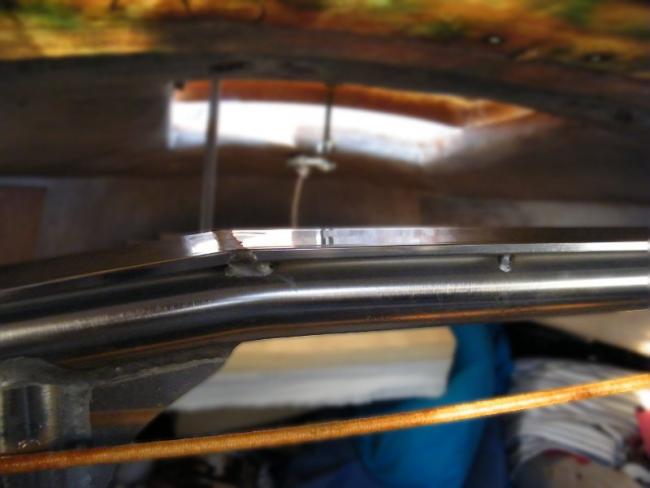

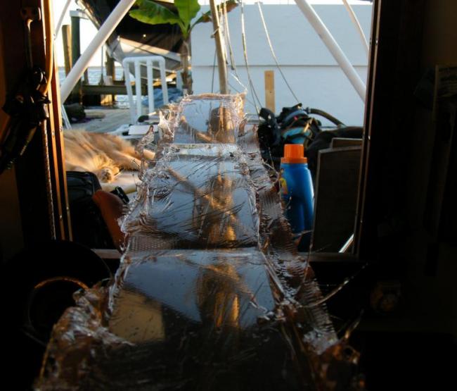

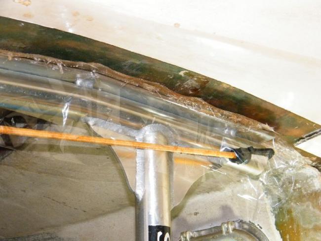

    Attached are some pics of the beginning of the under-deck strongback area work I'm doing. Started by wrapping the aluminium strongback with plastic wrap to keep epoxy from sticking. Then cut lots and lots of strips of glass cloth, 2.5" wide or so. Between the flat top of the strongback and the curved overhead, were gaps approaching 3/8" at the widest (mid-point of the 3 flat areas across the top. Also, the gap is wider at the after edge, by about double of the front. After much thought and consternation and constipation and, well, delay I am just cramming glass up there until the gaps get closed with a solid layer of cloth. The last layer will get plastic wrap over the top to avoid it sticking to the under-deck skin. At that point, I'll do some cleaning up of this basic structure, grinding edges to make them purtier and fit better, basically get it 95% done, then apply it to the overhead, perhaps with a last layer or two of cloth for that last lil bit...
    On to the pics...
    This is detail of the top of the strongback, you can see the flatness...
    Here's what it looked like after the first layer of goo was on, I started pulling plastic and then thought "Oops, pics...", so replaced it somewhat for this shot..
    And here you can see that the new structure base has conformed to the top of the strongback - 3 same reflections, 1 for each plane. After this pic, I re-wrapped the strongback, and replaced this structure there as it was still a bit 'green' and flexible, so that it will harden to the true shape. You'll note some dry spots in the fabric - my resin was *cooking*, and I had to rush a bit more than I would have liked, to get things into thin layers so it wouldn't be shot too fast/hard. Good thing is that I will be able to wet that out easily later on...

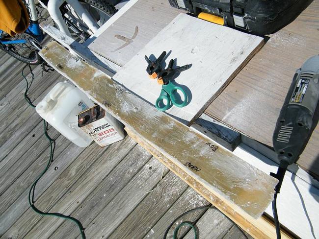

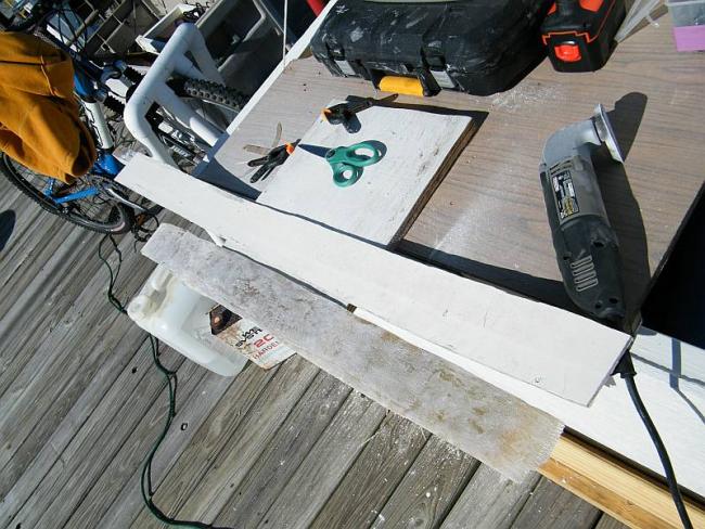

    Built up the 'strongback mating' piece somewhat more...
    Trimmed the piece previously shown using the Rockwell tool (which is fast becoming my 'go-to tool' for this job...).

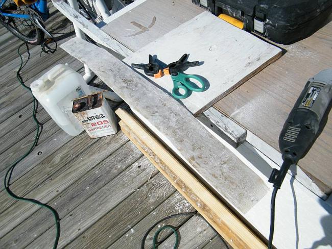

    Shown with the mating piece is the scrap cutout from the cabin overhead liner. I intend to use this at the last layup in order to provide a nice flat surface for bonding against the overhead skin.

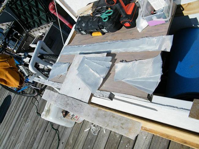

    Glass cut and laid out for easy access. I positioned every full-width piece against the forward edge, smaller width pieces I laid slightly past the after edge in order to build a thicker section there.
    Two resin mixing sessions later (the first one went off *fast*, too fast for me to layup all the glass at once), this is what i now have to work with. Have to trim it and measure, but I believe it is thick enough that I can lay on a paste of resin and colloidal for final forming, and then bond the liner scrap to it just prior to in-boat mounting. I put the overhead scrap piece against the resin when wet to make a 'pattern' of sorts so I know where to build up a bit more resin in the next step.
