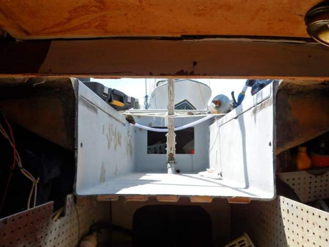

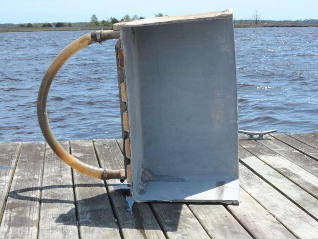

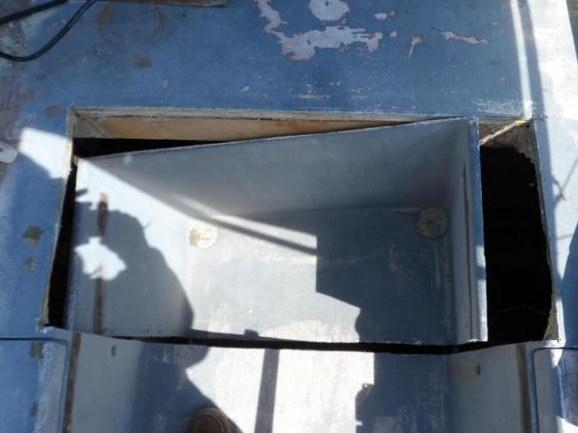

    Howdy, fellas! Back from another hiatus, since I hadn't been doing much on the boat, there hasn't been much to post, but now with warmer weather that's a changing.
    Here's some Ariel bits you probably haven't seen like this before. It's the first part of the process of expanding the cabin back a bit under the bridgedeck, about 14", for the big berth. I've some other pics of the process, but not handy right now, so these will have to do. Last week I pulled the cockpit drain tubes from their thru-hulls and stoppered them up. Figured out the best way to do this while in the water was to cut white EPS (styrofoam) into plugs about 1/4" larger diameter than the thru-hull holes, mist them with water then smear Gorilla Glue on them, wait about 2-3 minutes then pull the tubes and shove the plugs down in. I knew from experiements a few years ago that the GG would foam up when treated like this, and it worked a charm. I shoved the plugs down far enough that there was an inch or so of space on top, and into that area I stuffed some epoxy putty, the 2-part 'stick' kind, keeping an eye on it while it kicked so that I could cover any leaky bits. Once I had all three holes done (drains + sink drain hole), I gave them a good covering of Great Stuff expanding foam, just as a little extra protection. Not a bit of leakage since.
    So today I cut out the front end of the cockpit, a bit more of the ex-aft bulkhead, and the pegboard in the area where the footwell no longer exists. This week I'll be re-glassing over the hole, creating the new bulkhead there at the forward locker drains, and starting in on the berth base.

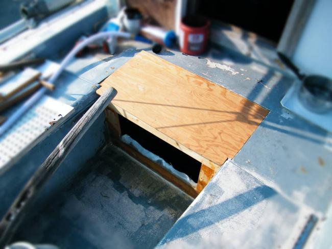

    LOL, Mike I made a concession only cutting away as much as I did - initially I was going to take it back another 6" or so, but that would've involved the lockers and locker drains and such, so I am holding it just forward of there for 'testing'. Initial impression is that it is enough, interior-wise. Half of this project though is that I wanted less area in the footwell, a good seaworthy attribute, and one which I'd bet the Old Swede would have made himself, had he not had to bow to consumer requirements to "Sail 6, dine and sleep 4".
    Here's a shot showing the hole getting filled back in. How exciting!
    BTW - The gray stuff all over the place is high build primer, a somewhat-failed and thus far abandoned attempt to fill in all that crazy gelcoat crazing.
