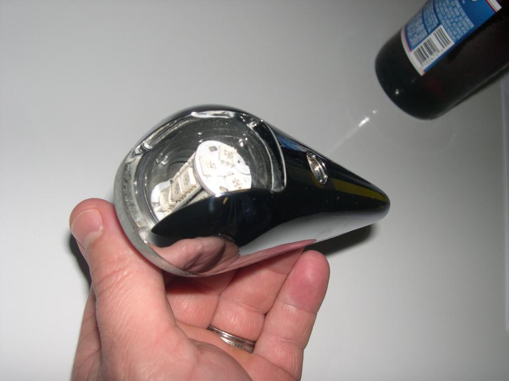

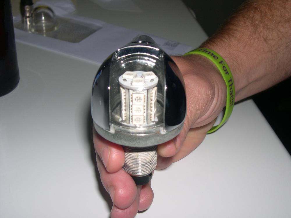

    Recieved my new nav LEDs from Dr LED and they are very cool. One problem though the green and red would not go deep enough into the socket on the old fixtures. Waiting for a reply as to the best bulb for the old pearson sidelights. The stern light fit just fine as it is not as deep, bright as a lighthouse. Also put one of the 12v medium base (household style) bulbs in for the cabin lite and it is also very cool. Will be buying another. On the packages it says Zero RF.
    I thought about trying to push the sockets up into the fixture but was afraid I would screw em up. Anybody ever try that?

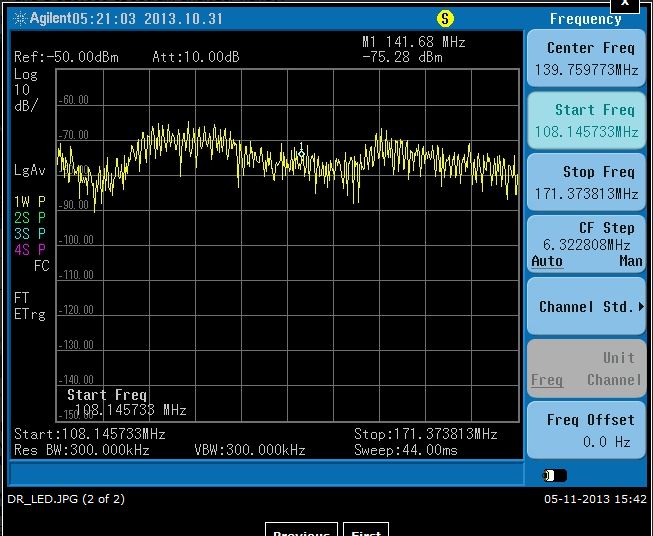

    Careful... The Dr. LEDs I tested didn't have the required width of vertical light emission. If you heel past 20 degrees, the sidelights will disappear. The COLREGs require +/- 25 degrees. Here's my letter to Dr. LED and their reply:

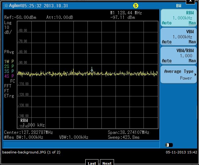

    Also, "Zero RF" is an unattainable pipe dream for LEDs that operate at a wide voltage margin (12 to 24 volts) because they incorporate switching regulators that will produce some RF interference (RFI). They all produce some RF interference, although there is a great variation in how much. The only way to achieve "Zero RF" is to encase them in shielding.
    Here are spectragraphs of the RFI noise from the red Dr. LED I tested.
    The first image is the RFI noise level from the Dr. LED.

    The second image is the baseline (background) noise levels (LED powered off) taken inside the RF shielded (several feet of steel and concrete) Screen Room I used for testing. The Dr. LED's RFI was more than 30 decibels (a ratio of 1,000 times) higher than the background noise.

    Placed near your VHF antenna, this noise level from the LED lamp would practically obliterate your VHF reception.

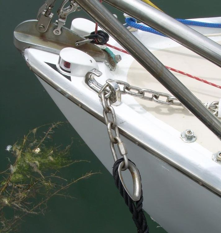

  9. #129
    Thanks for the insight on the LEDs, never would have considered those issues. Wow, you got some forward firepower, what ya got to cover the stern? And say... What kind of game are we playing with the blue line in your deck? Asym tack?
    How about the red line that goes thru the block on your stem fitting, jib douser?
  10. #130
    Nov 2010
    Sunnyvale, CA
    104
    Quote Originally Posted by Commander227 View Post
    I'm using a Hella Marine 2 NM NaviLED PRO Stern Navigation Lamp on the stern. (Order info here: http://search.defender.com/?expression=700834&x=0&y=0, datasheet here: http://www.defender.com/pdf/NaviLED_...tion_Sheet.pdf).
    The blue line is my pendant that I use to haul the anchor rode to the bow while I toss it over from the cockpit. Full details are here: http://www.pearsonariel.org/discussi...6711#post26711. And yes, as you surmised, the red line is my jib douser.
    Note that Rule 22 of the COLREGs requires that the minimum visibility of the stern light for a vessel less than 12 meters (I count an Ariel as being 8 meters) is 2 NM. That minimum is met with the light above. The sidelights (red and green) only need to be 1 NM to satisfy the COLREGs, but I opted for 2 NM lights. I reason that, considering how little power the LEDs draw, there's not much gained by using less-intense lights.

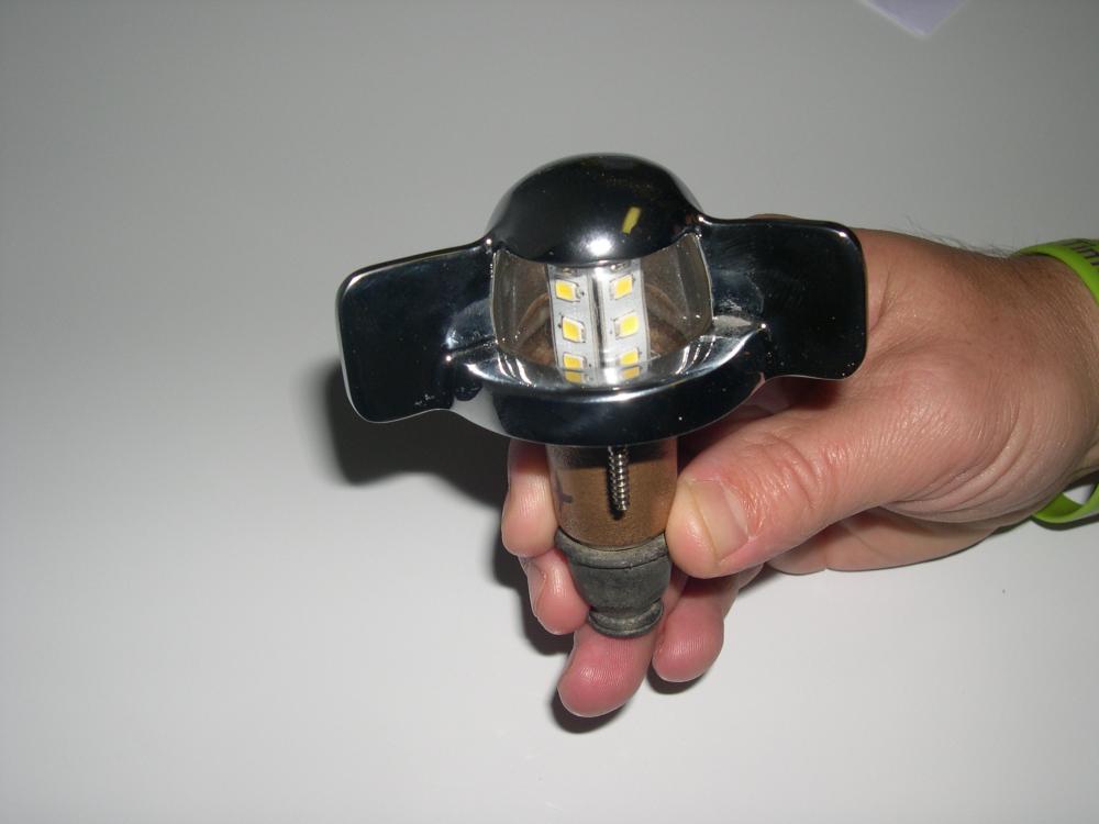

    > Looked around for those honkin LED headlamps on your pulpit....are they commercially available ?
    The larger 6 LED assembly is Larson Electronics model LEDP3W-6-F-WHT and the two smaller 3 LED assemblies are model LEDP3W-3-F-WHT. The clamps are model BC-3-WHT-1. Put lots of anti-seize grease on the stainless steel screws before you install them in the aluminum clamps. I didn't, and regretted the omission.
    Be sure you're sitting down before you see the price on those lamps. They are pricey, but they've held up to years of being struck by boarding waves and still continue to function. They are very, very bright. Since I've had them, I haven't had to untangle a crab pot line from my outboard prop, and they sure are nice when coming into port and docking.
