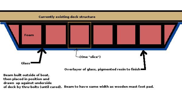

    Included is a quicky graphic* I did up to illustrate my current thinking. I'm with you on the stiffener thinking: Since the vertical component of an I-beam is what makes it resistant to downward bending, I have been trying to figure the best way to incorporate that into a 2" thick structure which could resist the compression forces put on it by the mast. I've ruled out wood, because I think that in what I'm going to do it will only add extra weight, w/out adding any extra strength. I'll be relying on glass for strength. Too bad, I like the look of wood! But it will be elsewhere in the cabin, so...
    In a nutshell, to build the beam: Lay up the glass onto a sheet of 3/4" thick foam (one side at a time), putting a total of 1/8" thickness glass on each side of the foam. This can be done with the foam in a horizontal position, making it easy to control wetting out, and to control alignment of the glass fibers in the cloth to achieve maximum strength in the finished beam. Once both sides are glassed and cured, carefully cut the 1" thick individual "slices" of the beam to a template taken directly from the hull, then bond the 'slices' to each other. After the slices are assembled into a unit, glass on the outer layers (top and bottom skins of beam).
    When this entire beam assembly is cured, it gets bonded into/under the deck, bedded in glass and "ebb's mishmash" , drawn up into place with screws and/or bolts until cured. Use more mishmash to filet the edges of the beam to the deck for smooth transitions, and then, last, laminate on a final overskin of glass.
    I plan to put 2 vertical stainless poles in place where the old doorframe verts were, they should give additional support and handholds. I 'mocked this up' yesterday to see how they would look visually, and they don't detract from the 'open' feeling the cabin has with most of the bulkhead removed (which I am loving!). At the bottom, they will tie in to reinforced floors similar to what you have done.
    Whatcha think?

    Indeed. I do like the multiple I-Beam composite, great graphic. It's an engineering challenge! EG how thick do you make the webs? The more you think about it the more feasible it becomes.
    The verticle supports inside, two placed about where the original doorway is, should do it. Could also buildup wide pads on the beam to spread the 'point load' of the supports.
    Mike Goodwin introduced us to maranti "Aquaply" and "Hydroply" which are superior in every way to American fir - that stuff would make a good arch - ala Frank's post. Thanks, buddy! 3/8" of maranti equals 3/4" american fir. I would not use FinnPly. Would caution that cutting the 2" wide curved pieces out and gluing those together side to side to get your width is not such a good idea. There still will be flex don't you think? Could you put it on the floor and jump on it??? Even with the extra wide width I think there is not enuf 'meat' in 2 inches. Would like to debate this. I'd be happier with 2 1/2". Plus the two columns inside. As you know it's imco. Frank, though, of course meant bending 1/4" over a form and gluing up a 2, er, 2 1/2" stack! Only with meranti.
    A composit structure composed of two skins separated by foam, endgrain balsa, honeycomb -essentially a nonstructural filler - will be stiffer than a solid lay up. Also lighter of course. But we can't forget that the load on the beam is concentrated in one place. Spreading out that point load is very important. Correct?
    What we learned about an unrestored Ariel with a flattened cabin-crown under the mast is that the original Pearson structure (beam, strut braces and bulkhead) while funky was still working and in good shape. (On 338 anyway.) The structure had probably 'settled' or shrunk over the decades allowing the rigging to pull down on the mast. That is, it was more of a result of aging materials rather than the weight of the mast, or rot. After the two screws that hold the round wood maststep to the beam inside were removed, the composite cabin top popped back up to it's original crown!! Or pretty close to it - how about that?? That's the challenge confronting the renovator. We need to make some structure that will not move over time. This time. Or one that can be adjusted up when needed. I'll take the immovable, with some redundancy built in. And everything GLUED IN. We live in the age of incredible glue.
    If one had the time, testing various structural ideas would be revealing. We'd need the various arcs and a carjack and some sort of meter. But doing this in the imagination is a good alternative. One can 'see' the various ideas and how they might be expected to react to a carjack (or an unmetered jumping attack by a twohundredfifty pounder wearing Redwings!) trying to straighten them out.
    I'm oldfashioned and think solid heavy oak will do. But a well thought out composit of carbon fiber and the best epoxy would be much lighter and more in keeping with the technologic advances of this era......... Would be a curious jig to come up with! Vacuum bagging, anyone?

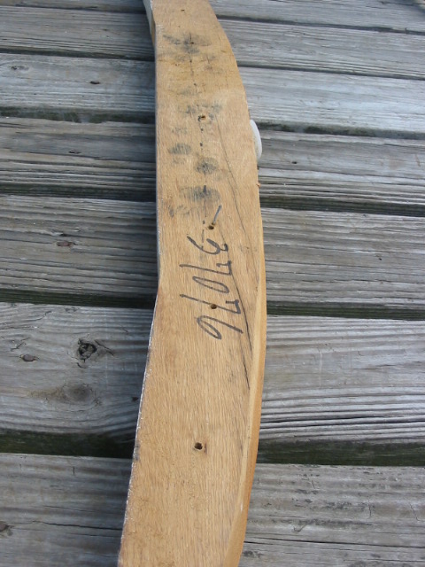

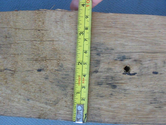

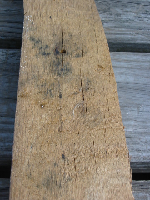

    The original beam is 4 1/4" in the middle tapering to 2 1/2" on the ends. It is 2 3/4" wide. It is a very efficient, nice looking piece as designed. In no way could it be bent by the mast. Unless it rotted.
    The only way the cabin top flattens (and it is really minimal: 1/2" maybe a bit more, limited experience here) is that the wood structures in the boat settled (and/or the balsacore in the composit cabintop rots) - with help from above. The beam remains unchanged. The bulkhead, beam and vertical struts were all carpentered DRY into place by the factory. Designed to move in time!!!
