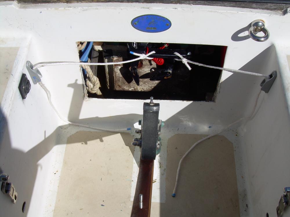

    Pulling the crab pot line aboard, up through my engine port, in ocean swells, or dangling myself in swells over the stern while trying to snag the line with a boat hook, while the crab pot acts as an anchor (requiring hauling the boat astern to the crab pot - provided the pot doesn't haul me overboard first) can be a difficult and dangerous process. And no, I am not going to try to back down on a line astern with the engine in ocean swells - while hauling it aboard through the engine port just inches away from my prop. As much as I might like fishermen, I'm not going to try to haul the line around to the bow or risk falling overboard or an entanglement with my prop.
    I don't mind saving the fisherman's pot if I can do so without risking my life. Provided the crab pot isn't placed in a marked navigation channel, in which case it's as much a vessel trap as it is a crab trap. I have seen many of those around Half Moon Bay. Some clearly abandoned with what looks like years of overgrowth on the floats, meaning there's nothing but crab skeletons inside the traps. Archaeologists will be studying those non-biodegradable floats and line in a thousand years. There should be a maximum amount of time pots can be left in place, after which, people should be encouraged to pull up the abandoned traps, and if they are stuck on the bottom (which is probably why they were abandoned) to cut the lines. Maybe a bounty on cut and turned in abandoned traps and floats would help clean up the mess. By the way, the California Fish and Game code states that crab pots not serviced, or placed in a navigation channel, are a public nuisance.
    The environmental laws prohibit discarding plastic in the ocean. Some of those (plastic) floats and (plastic) lines are clearly discarded. And the people who abandon them without removing as much of them as they can (at least the floats) - aren't fishing - they are littering.
    As I write this, recreational season for Dungeness crab doesn't start until Nov. 1st, and commercial season doesn't start until Nov. 15th. There shouldn't be any crab pots anywhere. But take a cruise around Half Moon Bay, and you'll find enough of out-of-season pots to turn your cruise into a slalom course.
    Maybe someday the technology and requirements will have lights attached to the floats so they can be seen at night. Meanwhile, there is nothing preventing fishermen from applying retroreflective tape to the floats - if they really care about vessels avoiding them at night.

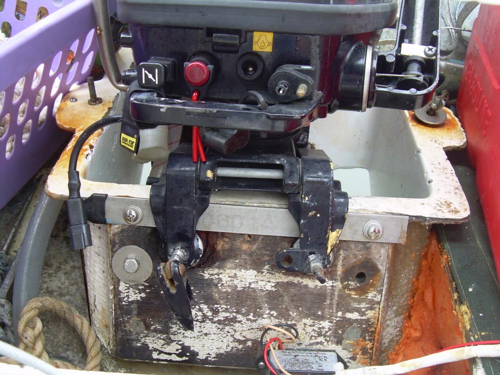

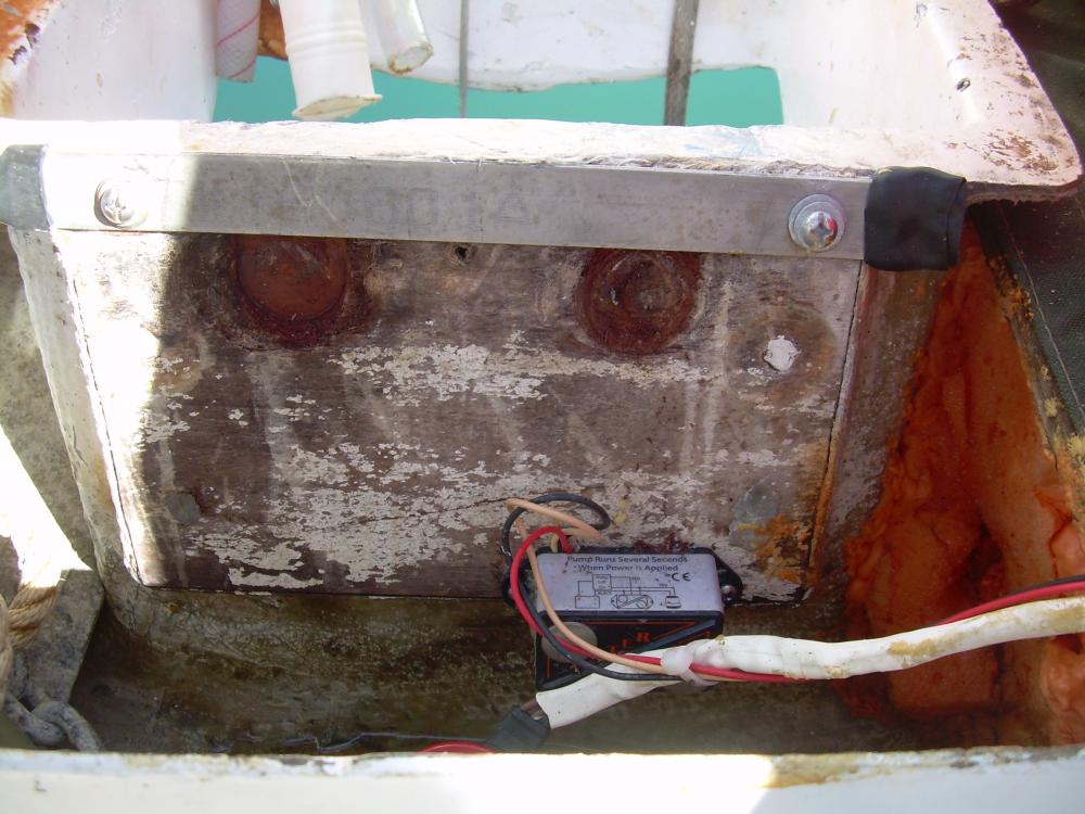

    I have a Nissan 6 HP outboard (model NSF6). There are two annoyances that I resolved.
    1) The Ariel's engine mount, a block of wood, allows the engine to slide up that block and pop off it entirely. It is very unpleasant to have the engine flopping around loose under power. In reverse gear, I’ve had it fly up and nearly slap me in the face. Even though there are deep divots that have been worn into the wood by the mounting clamps, to prevent movement, the clamps still have to be torqued down so hard using tools to prevent slippage, that they eventually break. And swells pushing upward against the engine lower shaft eventually loosen the clamps and walk the engine off the wooden block regardless of how severely the clamps are tightened.
    I solved this problem by installing a stainless steel bar across the top of the engine port mount. Carefully measured to allow the round clamp pads just enough clearance to pass under the bar when the engine is installed, the bar retains the engine while allowing only very slight movement, and I can install the engine and remove it (which I do after each sail) without torquing the mounts excessively. When the clamps inevitably loosen after a long sail, I only have to reach in and give the clamps another twist. The engine stays put.
Size:  104.4 KBName:  DSCN2941.jpg

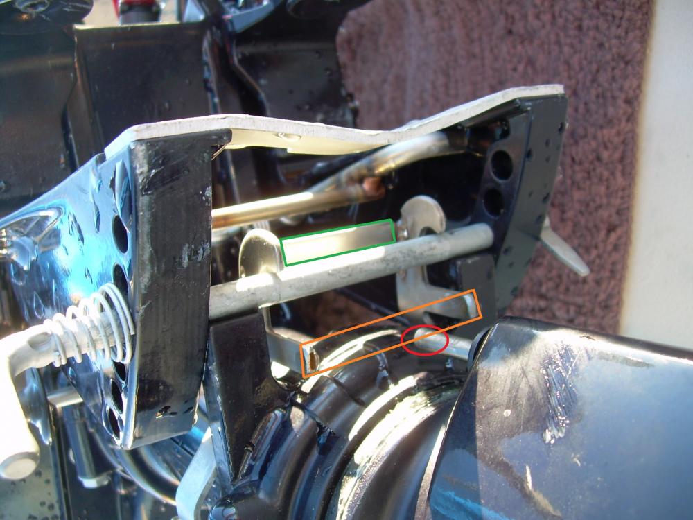

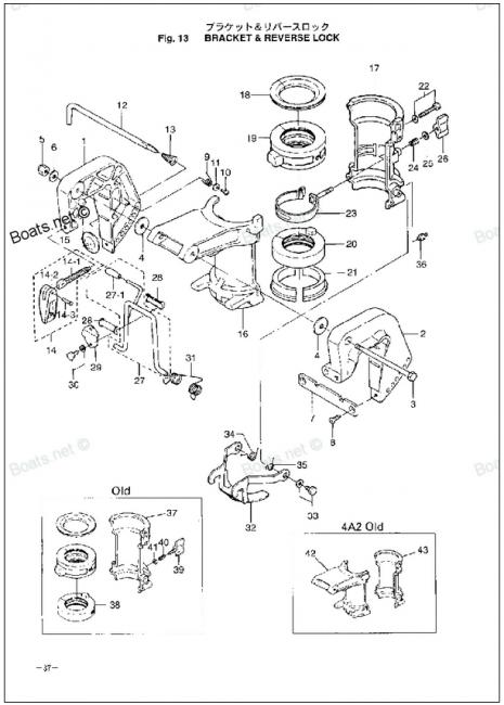

    2) The Nissan has a “feature” that allows the lower shaft to tilt back when the engine is in forward gear. Referring to the attached drawing, the reverse lock arm (32) engages the thrust rod (12), but only in reverse and neutral gears.
    In forward gear, the engine is allowed to tilt back freely. This is a useful feature on a skiff that prevents prop damage when the skiff is run up on a beach, referred to in marketing material as a "Shallow Water Drive." But the free-tilting behavior is completely useless on a vessel where the prop is higher than the keel and will never strike the ground (you’d have to back into something to strike the prop). Plus, the tilt range in the Ariel is too limited to be of any value – only a few degrees before the engine cowl slams into the forward wall of the engine compartment (damaging the cowl).
    This free-tilting behavior becomes a major annoyance when you discover that, after raising sail, your speed through the water causes the engine to tilt and force the cowl (engine cover) against the compartment wall when you select idle thrust while in forward gear, and that there is no practical way to restore the engine to vertical besides stopping the boat.
    When docking, it becomes a major hazard when you try to go repeatedly from forward to reverse. If you have any forward speed, the engine will never return to a vertical position because the lower shaft is dragging through the water. As you throttle down in forward to switch gears, the engine will tilt aft. When you select reverse, the reverse lock arm can't engage because of the aft tilt, and the engine consequently slams and see-saws back and forth in the engine port.
    The kind folks at Svedsen’s solved this problem for me. Referring to the attached photo, they removed the semi-circular swashplate (area marked in orange) so the push rod end (circled in red) cannot engage the reverse lock arm to move it out of the locked position. They then welded a cross piece (marked in green) to the top of the reverse lock arm. Alex in the chandlery came up with this solution. The engine now remains locked in the vertical position in all gears. The modification can be reversed by installing an original reverse lock arm.

    And with a team of Navy divers, I might have accomplished that. If you watch my video (link below), you'll see my predicament. There was:
    • At least 100 pounds of tension on the line trying to pull my engine down through the engine port into the sea. The swells were adding shock loads that were way beyond anyone's ability to pull the engine up out of the port. I would have broken my strongest gear trying to haul the engine up against the shock loads. The crab pot float was jammed between the anti-cavitation plate and the prop.
    • Ocean swells were boarding my stern. I was effectively "anchored by the stern in swells." Boats sink that way from waves boarding astern.
    • I had no way to reach the line, or even see it.
    • The line went vertically down into the water, so it could not be accessed from any angle over either side or the transom.
    I'd been bobbing around for over an hour with swells boarding my stern, pooping the cockpit, while trying every other method to access the line, including keel-hauling a line from the bow to grab the line (the swells just forced the line forward of the stern).
    It was now sunset. With daylight nearly gone, what would you have done?
    And for the record, I don't believe I cut the line, but instead impaled the float with my knife and forced it to slip under the engine shaft, as the video shows. Since there were two floats on the line, the fisherman should still have been able to retrieve it. Not that it would be worth very much, after I dragged it half a mile across the bottom.
    Crab season ends June 30th. Until then, I'm going to add a tree trimmer (http://www.harborfreight.com/media/c...mage_17978.jpg) to my gear. This happened in very mild swell conditions - 3 to 4 foot swells. If it had been the usual 8 foot swells that I sail in, I could have lost my boat from waves boarding astern. I've spent $600 on LED lights placed on my bow to spot crab pots at night. I've done my part. But it's a mine field out there! And I see very few crab pot floats with reflective tape on them. Apparently the fishermen don't care enough about losing pots to add $1 worth of reflective tape. I do care about losing my boat and my life.
