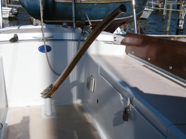

    I bought this tiller off the shelf at West Marine,I like it alot better that the original one

    I see no one still has any comments on tillers,I found the original tiller to be way to small and it was too low ,a real knee banger,when it broke it was a blessing.There are 61 registered people on this web site and who knows how many guest that dont register ,surely more than 10 or so people have an opinion about their Ariels and Commanders.

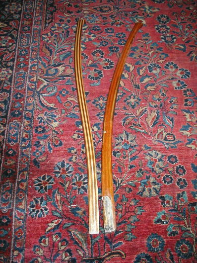

    Here is my new tiller on the left. The old one is on the right. The upward curve on the new tiller should clear the knees. Also, you wont tend to lift the tiller while steering, which puts stress on the bracket.

    The manual has plans for a tiller in the shape of the one in the last photo above. Goes over the knees while seated and will stay down when using the tiller while standing. H&L (who make just about all the tillers you see in the chandleries - ie., marine hardware stores like West) can make it for you.
