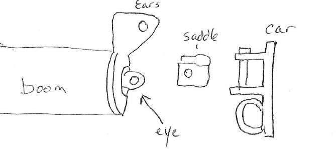

    My gooseneck has now reached the end of its service life. Below is a rough diagram of what I have. The piece I broke on Saturday I call the "eye." It emerges from the center of the boom. I'm thinking it might be the end of a long rod that runs inside the full length of the boom. Anybody have any info on that?

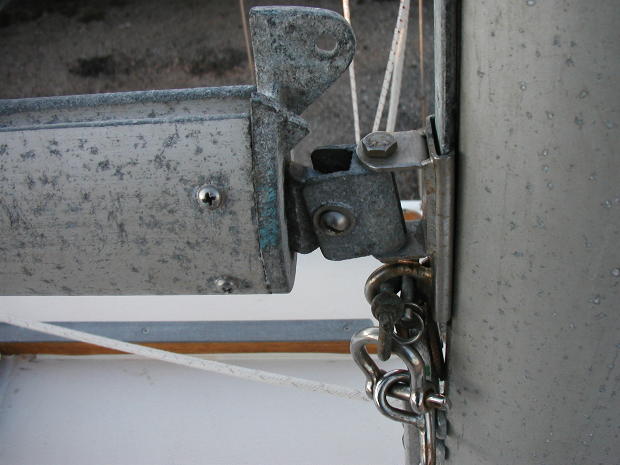

    I took this picture last Winter. The whole business is pretty ugly. You can see that one of the "ears" is broken off. The "saddle" looks brittle, deformed and suspect.
    1,823
    The gooseneck is fairly critical. I wish it were a more robust structure. There is a brief mention in the Manual about a fixed gooseneck. I kinda like the downhaul, but I'm open to suggestions.
    I broke that "eye" piece on Saturday while sailing in heavy winds. I didn't know it until I got back home and dropped the sail. Then it broke apart and the boom started flopping around. Could have been an ugly scene if it happened while underway.

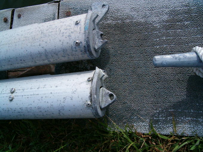

    1,823
    I replaced the boom with the one from my old Commander. Its the bottom one in the photo. Both "ears" were broken off, and the "eye" (arrowhead) hasn't got much left to it.
