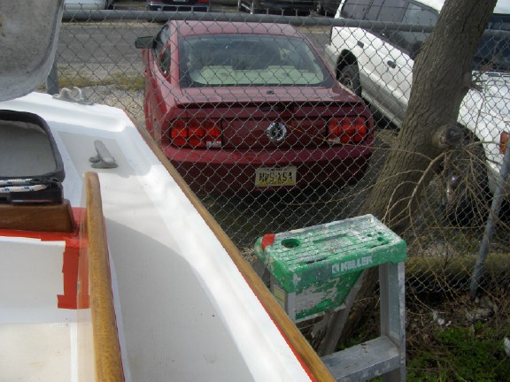

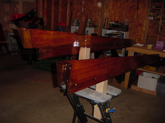

I wet out the wood with the shop epoxy mix and dry it off with rags or towels. That raises the grain. Smooth with sandpaper and douse again with the sealer, and either use it as a 'tie coat' or let it set up. Then sand for varnish. Skip the 50/50 and proceed with the normal varnish schedule, starting with thinned coats.
