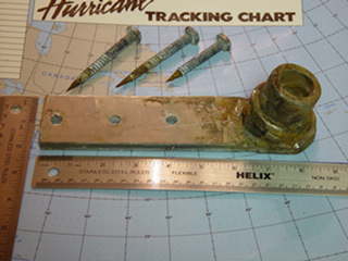

Thanks for the educated reply. The piece in the pic looks like two different diameters of pipe welded to a piece of flat stock.
It came from a very old Pearson someone cut up. I have no idea if it was oringinal or a replacement. If a replacement, of course I don't know how long it spent in the water but it shows no sign of corrosion.
That said, nor have I seen the effect it had on it's partner the rudder post.
