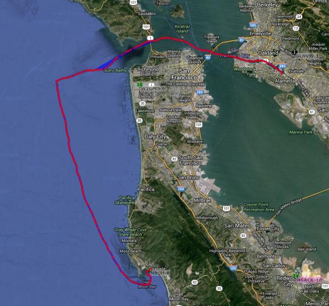

    I just recently had a haulout at Svedsen's and noticed some of the notorious corrosion of the bronze rudder shaft at the water line. It was pink (dezincification?) and appeared a little thin. I had the rudder taken off for a closer inspection. It looked a little worn, and so I decided to have Svedsen's replace it with a 316L stainless shaft.
    After they took the rudder off the shaft, it was clear that there was only about a tenth of an inch of uncorroded bronze holding the shaft together at the waterline and at each fastener penetration hole! One hard shove and I would have snapped the shaft. So my purpose for posting this is to caution the reader that if any corrosion is present - it may be a lot worse than it appears. The corrosion easily hides in the areas covered by the rudder and attachment screws.

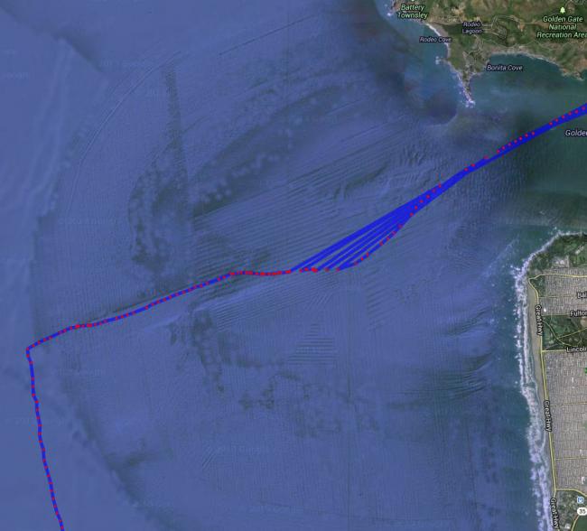

    I'm glad I had it replaced because I had to traverse the Golden Gate Bar in heavy swell to get back to Half Moon Bay, and for the first time I had to navigate over the bar all the way out to the end of the deep water ("main ship") channel to avoid plunging breakers on either side. This was my tenth crossing in and out through the Golden Gate Channel, and the swells from the recent storms made it exciting - I wouldn't ever want more excitement. I'm posting here the course that I took over the bar and the full voyage. I had 10 foot following seas all the way back to Half Moon Bay (surfing at 6 to 8 knots!), where I had to reverse the rudder every 10 seconds to compensate for reversed flow across the rudder caused by oncoming swells. The rudder got quite a workout and the new shaft was essential!
    Had I not followed the proper course to avoid the breakers and avoided going through at max ebb tide, I am sure I would not have made it across the bar in those conditions. Previously, I'd always been able to plan my bar crossings in less than 6 foot swells, but this time of year, I could have been trapped in the Bay for some time waiting for those benign conditions to develop. I highly recommend this article to anyone who plans to cross the bar: http://coastsidefishingclub.com/grey...francisco-bar/ -- especially the sections on "Crossing the Bar Tactics" and the mythical "South Channel" (why is that name even on the charts?). It's written for fishermen in motor boats, but the advice is just as valid for us. Capsizing is capsizing.
