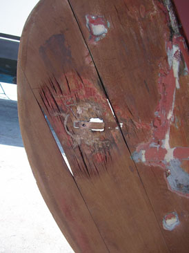

    During a haul out in late July 2018, we discovered that the mahogany rudder blade on my Pearson Ariel was eroded due to alkaline conditions produced by the rudder zinc that had been installed on the rudder. The zinc was in very good condition after more than a full year in the water. The copper strap connecting zinc to the rudder bolt within the body of the rudder blade had been broken (likely due to metal fatigue incurred when a diver was cleaning the rudder blade while installing a new zinc). We considered repairing the rudder blade with epoxy, but upon examining the upper bronze rudder shaft, we decided to replace the rudder. The bronze rudder shaft was badly eroded in the vicinity of the top rudder blade bolt. Since other Ariel rudders have failed in this same location, and in light of the evident corrosion, we decided to replace the rudder.

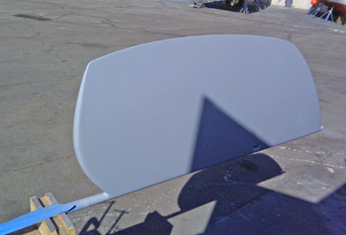

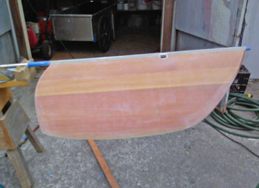

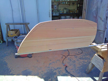

    The rudder blade was built of Kiln Dried Douglas Fir 2X6 and 2X4 boards secured to the shaft by nuts secured to the 1/2 inch all-thread stainless steel rods. The kiln dried fir boards that compose the rudder core were glued together with and all voids were filled with West Systems Epoxy. The boards were then shaped by sanding to an improved more aerodynamic shape with a larger blade that tapers to the trailing edge as shown in the attached photos. The last 1/2 inch of the trailing edge was built of epoxy resin. The rudder, including the stainless steel shaft where it abutted the rudder blade, was then wrapped with 6 oz fiberglass cloth saturated with E West Systems epoxy, sanded to fair and then coated with Interlux 2000 Barrier Coat. The stainless steel shaft was wrapped with one layer of cloth. Two layers of cloth were applied to the rudder blade. Finally, while the second barrier coat layer was still wet, Petit Trinidad bottom paint was applied. This layer was followed by two additional layers of Petit Trinidad.

    The dotted line on the photo below of the rudder (shown before application of fiberglass) is an outline of the old (original) rudder profile. The new rudder is shown in other photos after application of fiberglass, after application of Interlux 2000 Barrier Coat, after application Petit Trinidad bottom paint, and as mounted on the boat in the slings just before splashing the boat. Additional photos of the old rudder are include din the follow-up post.

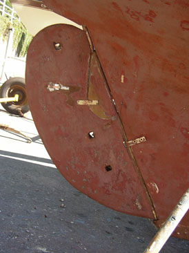

    The photos below show the old damaged rudder blade in the area of the rudder zinc and the old rudder in 2004 during a previous haul out.

    My Answer: The profile (surface area) of the rudder is larger. The leading edge of the rudder is necessarily the same width due to the shaft width, but the rudder tapers to the trailing edge, as can be seen in some of the photos in my earlier post. The final 1/2 inch of the trailing edge is epoxy. If you look closely at the photo of the fir rudder blade that was taken prior to the application of fiberglass, you will see a dashed black line. That line shows the profile of the original rudder. The line should help you visualize the areas where the profile of the rudder was enlarged.

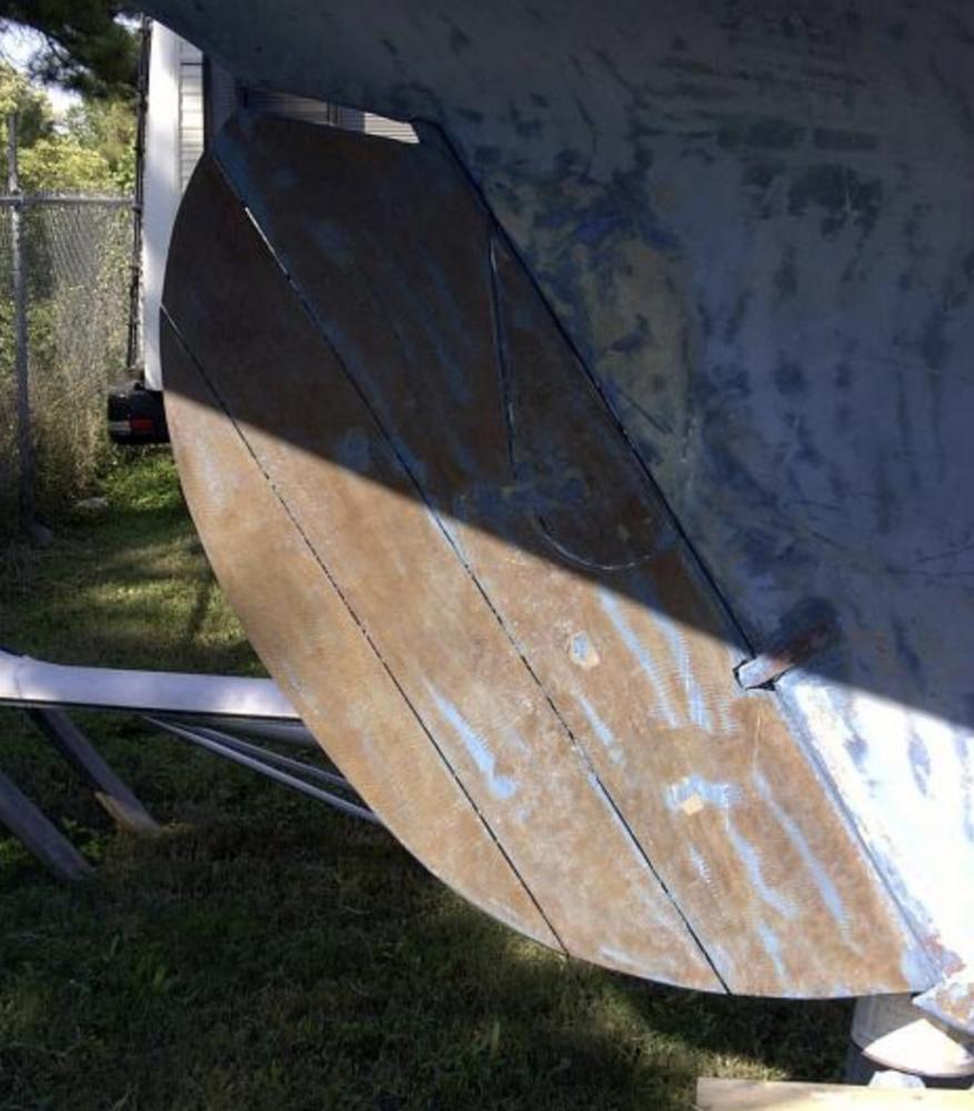

    Below is a photo of the old rudder taken during my recent haul-out in July showing damage to the mahogany rudder blade due to erosion resulting from alkaline conditions produced by the rudder zinc that had been installed on the rudder. Whether this damage was accelerated by the broken copper strap that once connected that zinc to one of the bolts tying the rudder blade to the shaft, I do not know, but I suspect from my research on this topic that placing a zinc on a wood rudder is not a good idea regardless of whether or not that zinc is connected to the bronze or steel rudder support structure.
