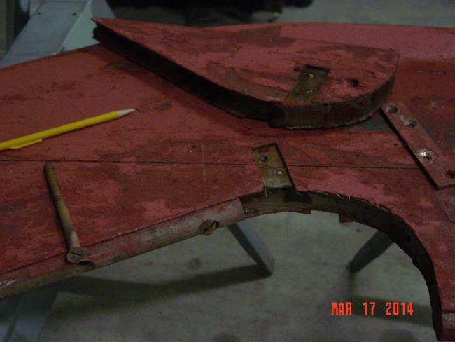

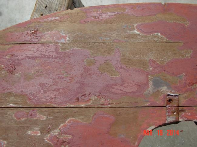

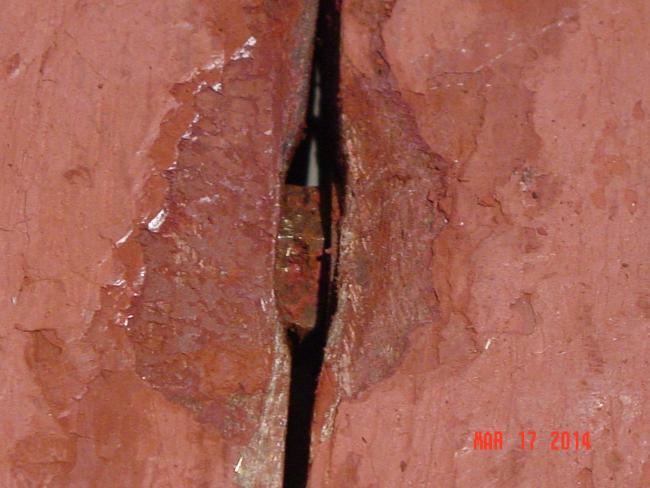

    Well I have taken the rudder apart somewhat and put back together a little bit. Thanks Ebb for that advice, I'll be buying a manual soon and using your advice to build a new rudder. I am going to keep the old for a spare and restore it as best I can. The third board (trailing board) had three drift pins in it and wood screws at each end. Its solid so I'm leaving it alone.Name:  DSC05656.jpg
Size:  37.1 KB Name:  DSC05658.jpg
Size:  44.5 KB The top fastener on the bronze rod is a machine thread that goes to this nut and washer holding the first board to the rudder shaft.

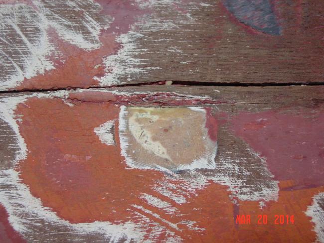

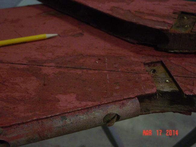

Size:  31.0 KB The second fastener is a wood screw holding the first board to the rudder post, the third fastener is a machine thread bolt the same length as the first but going beyond the first board into the second board (pencil is pointing to the area where nut and washer are still buried under paint) I was able to tighten that bolt a quarter turn after first removing it and cleaning it. I also cleaned bottom paint out of the crack between board 1 and board 2. The wood plug was only attached with the short straps and two short wood screws at an angle.
Size:  32.2 KB Showing the wood screw

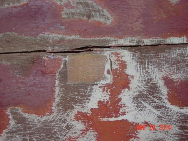

Size:  59.5 KBName:  DSC05667.jpg

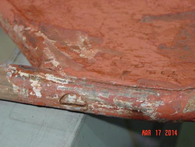

Size:  58.8 KB Pearson plastic in the holes?
Size:  48.5 KB The Wood Rudder is slowing appearing.

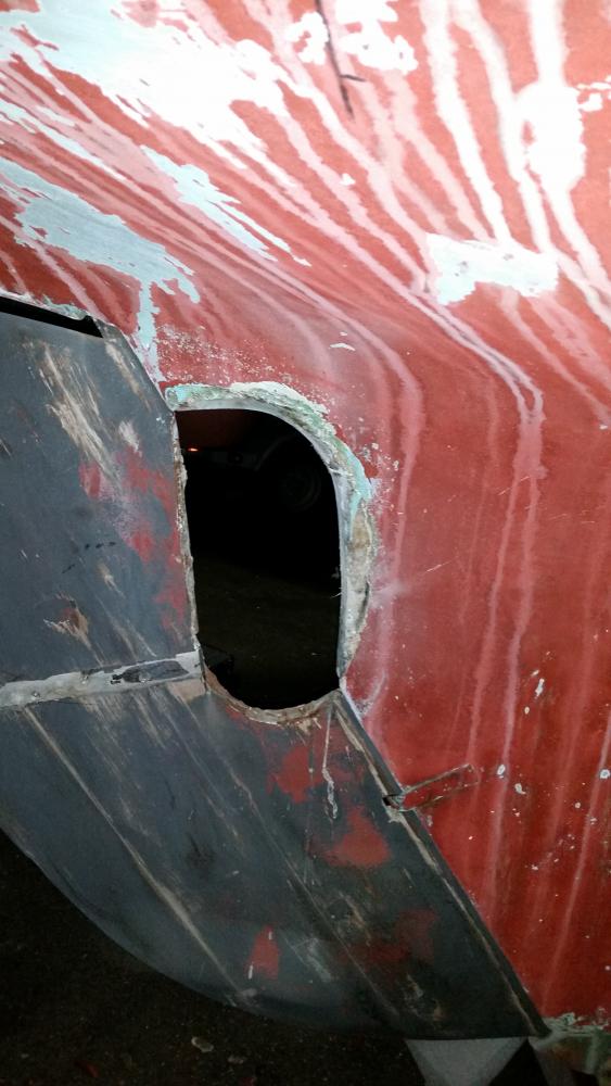

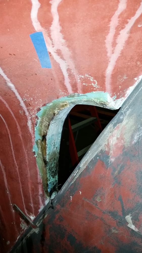

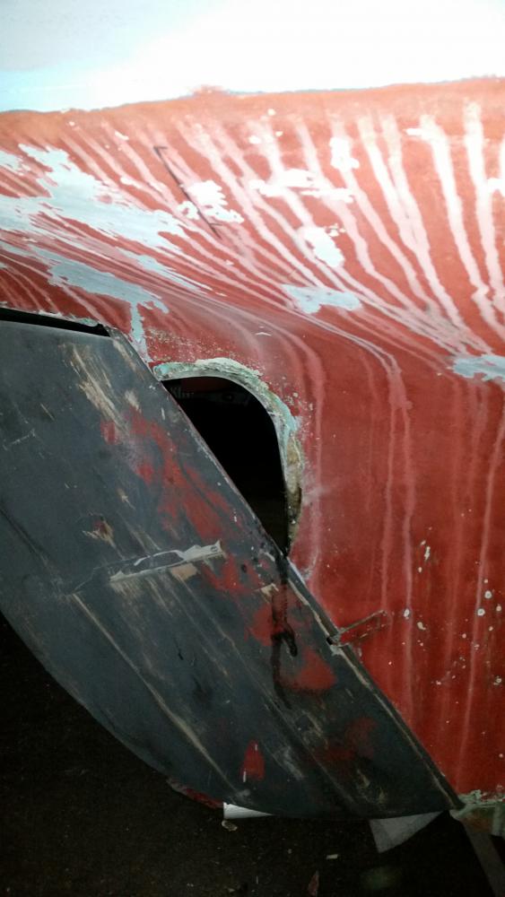

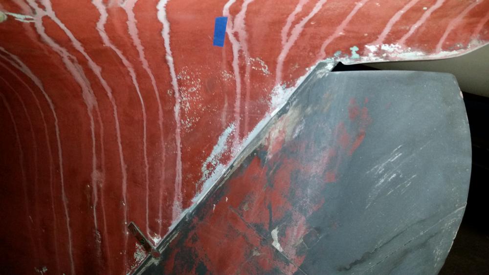

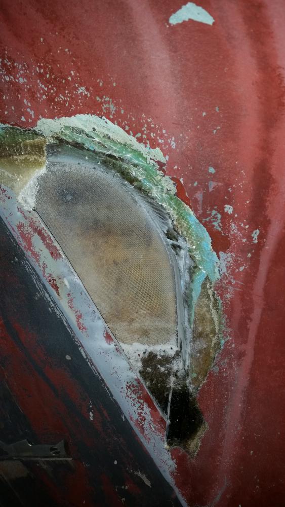

    I am just about done with rehabbing the hull and deck and about to start with the repower project. I am going to install a Yanmar 2GM. The boat was originally powered with an outboard so I figured I would start to poke around and see what was involved with cutting the window in the keel and rudder, installing the shaft log and building an engine bed. When I started to sound the keel where the window should be I noticed a decidedly different sound. It sounded like a different laminate schedule than the rest of the keel so I cut a bit out and discovered that the boat was built for an inboard and they glassed over the window. A little cutting and a few minutes with a pry bar and viola. I have my keel window. I was prepared for a fairly involved glass job and now all I have to do is clean up a little tabbing and install the shaft log. I hope the rudder is as easy. It appears the stock is set up for a window too. I'll keep my fingers crossed.

    Yes, the rudder has a cutout for the prop . . . unless it was changed by an earlier owner.

    Looks like I have the original rudder. lucked out again. Not much room for a prop.
