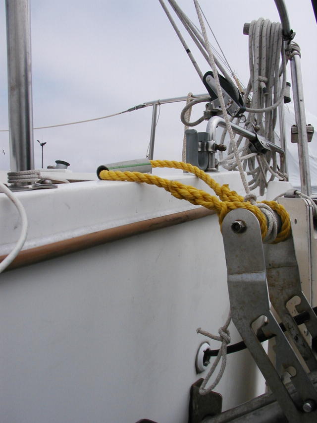

    If you run a short loop of line to the metal handle of the engine, it will give you more leverage in pulling the engine up, and you dont have to lean over the stern so much. I learned this trick on a boat I rented in San Diego once.
    I would also make sure the outboard engine bracket and tilt mechanism on the outboard is nicely greased up.
    I assume the engine bracket has a good torsion spring to make lifting the engine easier.
    As far as tilting the engine goes, maybe a loop of line around the back of the engine might help. Naturally, you dont want any line that could dangle in the water and foul the prop.
    I'm just trying to think of the easiest fix first. A Yamaha 9.9 is a great engine. If you go with a smaller outboard, someday you might regret it. No way would I recommend major surgery to cut out an engine well.
    West Marine sells a outboard engine tilter that hooks on to the top of the engine cover ($55.00) But, it doesnt look great to me.

    Somebody at my boat yard had the same idea for a lifting handle. Looks like he braided some three strand line and used a bit of hose for the handle.

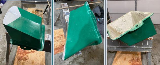

    Question plug for outboard well
    Anyone have a plug for his/her outboard well? Is it made to be easily removed and replaced? How is it constructed? What holds it securely in place? Does it keep water out of the OB well? Is there any noticable difference in how the boat moves through the water with the OB well plugged? I am thinking about constructing a plug for the opening and would appreciate any input or photos. Thanks.
    2,267
    Someone was going to reproduce the plug from an original, but ran into physical problems from inhaling too many of those esthers, or whatever. Click on the search button above and enter outboard well plug, or variations, and you should find the information.
    Feb 2003
    somewhere along the ICW
    33
    looking for photos
    Back on 6-19-03, after Bill's response, I went back and searched the previous posts for information on the plug for the outboard well. I could have sworn there were some photos posted but I cannot find them again. Does anyone have photos of their outboard well plug available to post? I'd love to see views of the plug installed and by itself.
    Thanks in advance.
    2,267
    I will get some photos of the plug when I'm at the boat on Saturday, and then post them here. If someone else does not post first.
