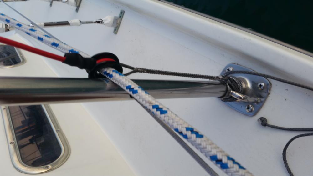

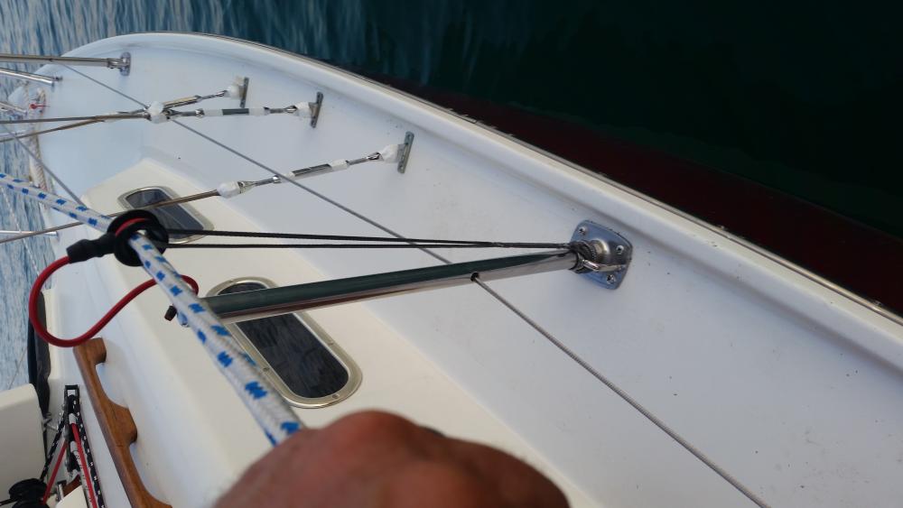

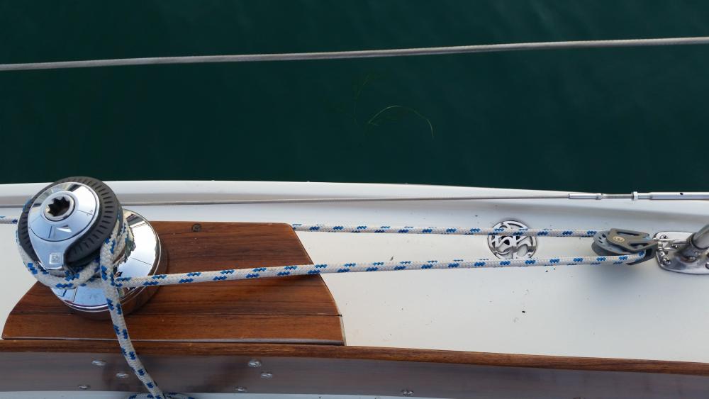

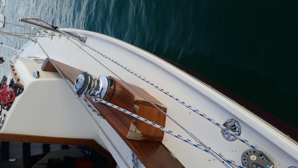

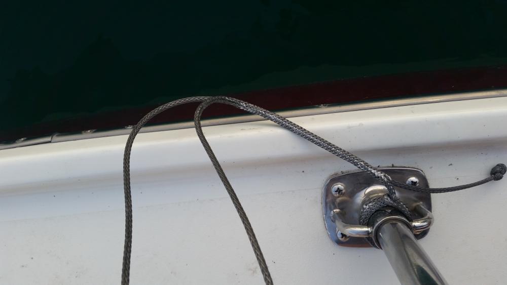

    I just installed a floating jib lead set up and it is working really well. I looked at all of the posts on track placement They were very useful - mostly in convincing me that I didn't want to go through all the effort to install a toe rail t track and inboard tracks. After recoring the entire deck I wanted to come up with a solution that required drilling as few holes in the boat as possible. I've used a similar set up on a Santa Cruz 52 and a class 40 and figured that it might work on the Gail Grace too. I'm flying a 155% headsail on the furler. The first time I pulled it out I realized that the locking foot block I installed on the deck near the back of the cockpit was not going to work. I had to turn it somewhere further forward so I put a snatch block on a stanchion base and the lead was almost perfect but I had no adjustment. I have since replaced the snatch blocks with a couple of Lewmar 80mm blocks that work nicely. Below are pictures of the floating lead as installed. It consists of a short length of Dyneema spliced around a friction ring, The tail of the line is spliced with a loop and an adjustable splice. On the top of the friction ring there is a piece of bungee attached to the upper lifeline to keep it from banging around when it is not under load. I can flip it inside the lifeline and use an inhauler to the cabin top winch to trim smaller jibs inboard.
    Name:  2016-08-16 19.23.11.jpg
    Jib sheet lead thru adjustable lead, back to turning block and to winch
    Name:  2016-08-16 19.23.30.jpg
    Turning block to winch
    Name:  2016-08-16 19.24.00.jpg
    Adjustable lead set at low position
    Name:  2016-08-16 19.24.49.jpg
    Adjustable lead set to high position (around 13" of difference)
    Name:  2016-08-16 19.25.23.jpg
    Adjustable splice

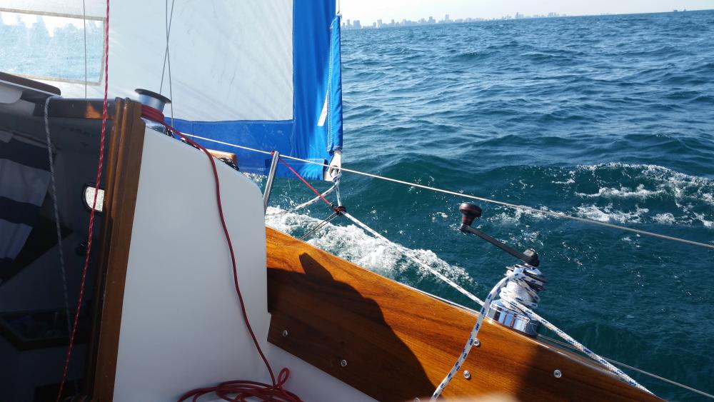

  8. #83
    Apr 2015
    Chicago, IL
    133
    Floating lead under sail
    Name:  2016-08-19 16.16.44.jpg
    Here is the set up in action. I think I will need to install a folding padeye on the deck a couple of feet aft of the stanchion to get it perfect.
