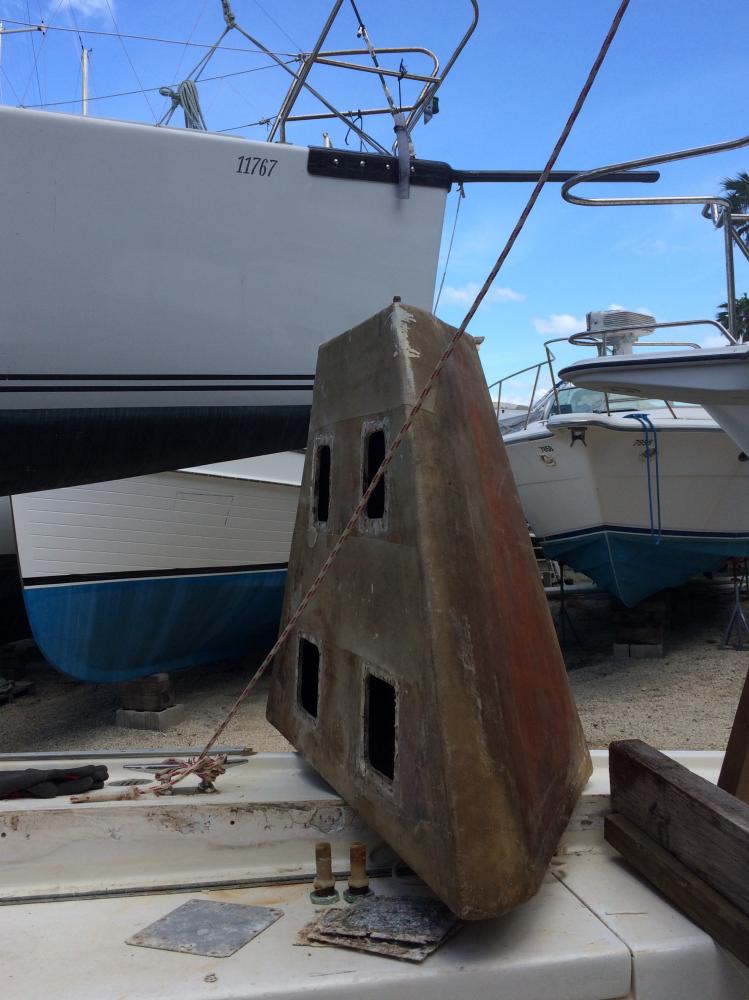

    Cranberry's Water tank.
    We removed the tank with minimal fuss, discovered a strange (very hard) indigo blue filler type material. Never seen anything like it.
    3,546
    tank
    'removed with very little fuss.'
    You must have one of those very rare Ariel's made of rubber,
    getting that out!
    Others on the Board have found that blue polyester in their boats.
    But it seems not to be all over, just in strange spots.
    Ran into some on liotlgull. Maybe it was used as filler/leveler,
    and colored for contrast ? ? Isn't gelcoat.
