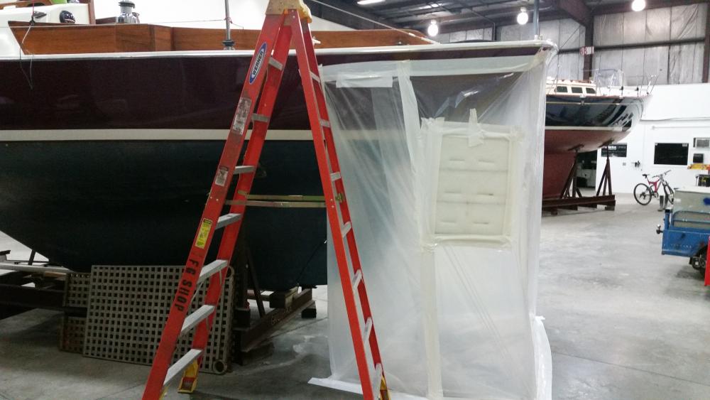

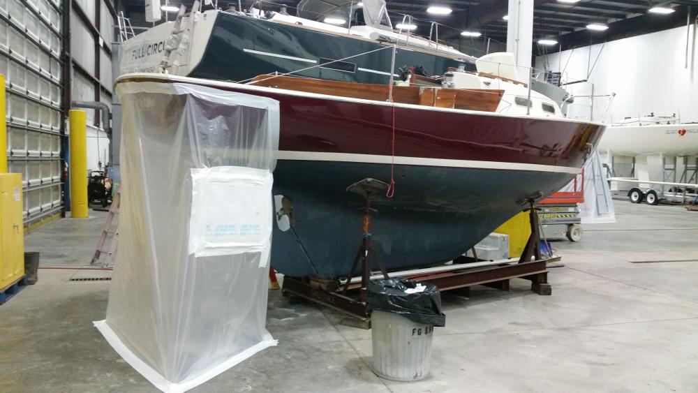

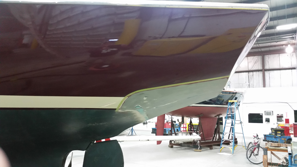

    I decided to get rid of the outboard well. Since I converted the boat to an inboard I no longer need it. At first I thought I would keep it in case I decided to use an outboard at some point in the future. However, after a season sailing her I don't think that is likely. The reasons for the effort are many:
    • Nicer lines
    • Better performance under sail and power. (I am pretty sure the well was creating drag when motoring and some times when under sail)
    • More room in the stern lazzerette
    • The foam between the lazzerette liner and the hull was saturated and caused the new finish to blister.
    • Less weight in the stern.
    First order of business was to cut the old well and liner out then dig the foam out. First I cut the old well from the outside then cut the inner skin out. After that I was able to pry out the old well and dig out all of the saturated foam. I filled up a trash can with 100 lbs of foam, glass and smutz.

    Here it is tented up and ready to grind and prep for glass.

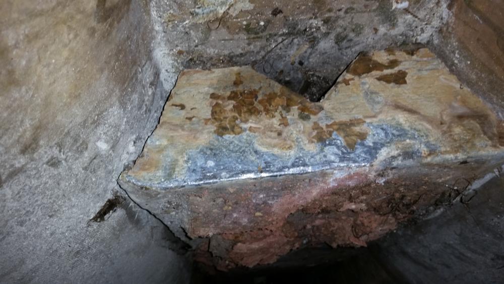

    Corrector Weights
    I am tying up the last details from the outboard to inboard conversion. The Yanmar is in and happy. The outboard well is history and the hull is ready for paint.
    Name:  2016-12-10 08.42.56.jpg
    Name:  2016-12-10 08.42.45.jpg
    Time to lose the corrector weight. If this is my corrector weight it measures 32 x 10 x 5. If I deduct the cut out for water flow I get 1456 cubic inches. At .41 lbs per cubic inch that is just south of 600 lbs. The Yanmar weighs 251 lbs. I cut out 100 lbs when I git rid of the outboard well so I have a net reduction of 450 lbs.
    Name:  2016-12-14 20.01.01.jpg
    I have a few questions:
    • Am I looking at the corrector weight? (sorry the photo is upside down and I can't figure out how to sort it)
    • Does that sound right?
    • Is there a class minimum weight?
    • Should I be worried about helm?

    Just after I posted last post with questions I found the thread on corrector weights. Most of my questions were answered there. Thanks! Still wondering if Commander owners who removed them like the change in performance?
  10. #85
    Sep 2008
    Brooksville, FL
    720
    While I did in fact remove the added ballast form C147 I ended up replacing it with very close to the same weight in batteries for my elec. drive. And while the replacement weight is approx. 1 foot higher in the boat Destiny sails very very well. I have had her out in 30mph winds and she will settle in with her rail just in the water and hold there.
    I believe Mike who owns C227 took his added ballast out and did not replace it. Now I believe he has repowered with a Yanmar so you might try touching base with him.

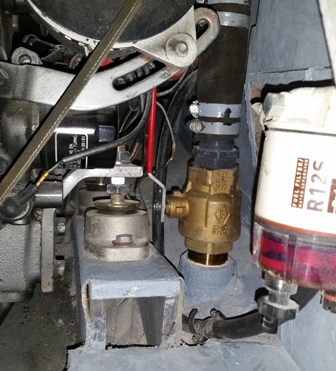

    Cockpit Drain Seacock

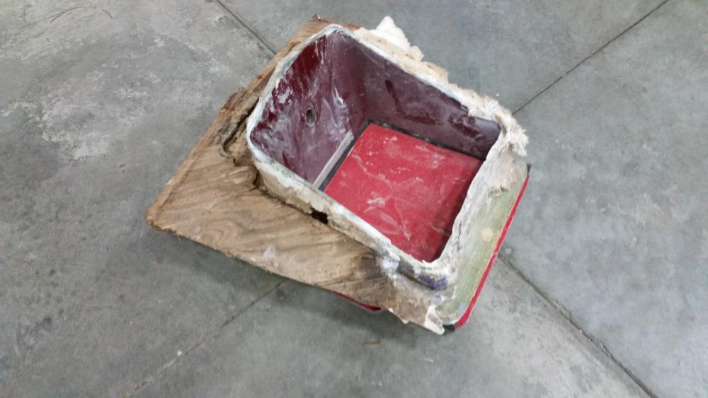

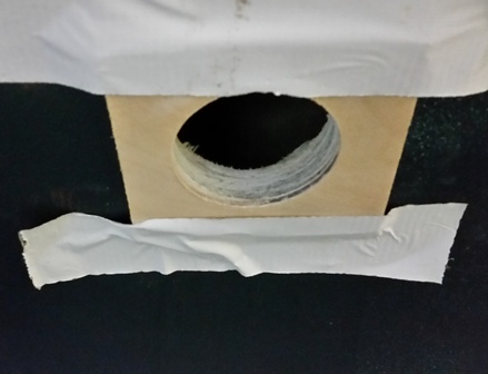

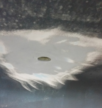

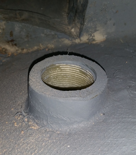

    I finally got around to installing a proper shuts off for the cockpit drains. I should have done it last year before the repower but put it off instead. Of course last spring when I launched one of the hoses leaked and I had to haul her had replace both hoses for the season. The job is a lot trickier with the engine in place but I managed it anyhow. First thing I realized was that the angle of the hull prevented me from simply installing a seacock. It would run straight into the engine if I tried to locate it in the same spot as the old drain hole. Also it is important to align the fitting with the drain tubes under the cockpit floor. The solution was to cut away the old tube from the hull and replace it with a new threaded fiberglass fitting that is aligned correctly. I found some nice extra heavy duty fiberglass threaded couplings from a company that manufactures these type of fittings for applications where fiberglass pipes are used to conduct corrosive liquids. Think chemical factory. They are really heavy duty, carefully machined, provide maximum flow and are cheap.
    Name:  2016-12-13 15.18.43.jpg
    To cut away the old tube I made a guide by using a hole saw to cut the correct sized hole in a piece of plywood. I then taped the plywood to the hull and cut around the old stub from the outside. The hull is so thick that once you get the hole saw started in the hull you can gradually guide the blade to cut in at an angle toward the upper drain stub and produce an oblong hole that fits the coupling closely.
    Name:  2016-12-13 15.17.38.jpg
    Once the old stub is gone from the hull I used a 4" grinder to expose fresh glass round the hole on the inside of the boat. Next step is to align the tube in the hole so it pointed at the upper stub. I wedged in some shims on the inside of the boat and laid a fillet of polyester filler on the outside of the boat to hold the tube in place. I laid in an epoxy fillet around the tube then glassed the tube to the hull. After this was dry I cut the tube flush on the outside and filled and faired with epoxy.
    Name:  2017-01-29 14.26.58.jpg
    Name:  2017-01-21 14.59.43.jpg

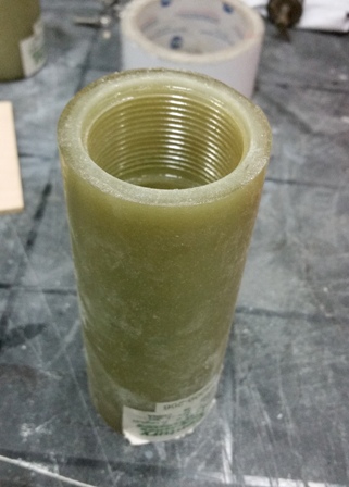

    I coated the fresh tabbing on the inside with epoxy paint and installed a threaded nipple, 1 1/2" bronze ball valve, a pipe to hose adapter and a 6" piece of hose. I can easily reach the valve from the access doors in the cockpit floor and the interior. It was a pain in the ass but worth the piece of mind.
    Name:  2017-01-29 16.03.53.jpg

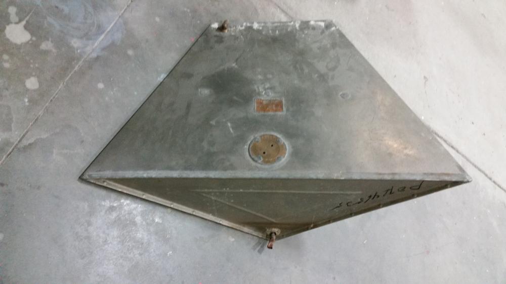

    Water Tank.

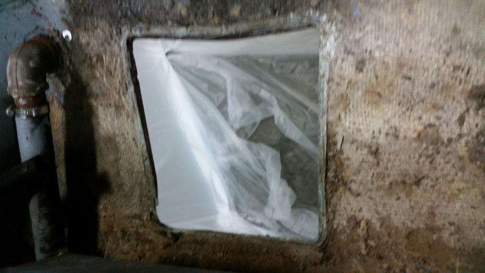

    I removed a very nice Monel water tank from under the v berth in the Gail Grace. I had no use for it and would rather have the storage space. I can't even guess what something like this would cost now. I had to break the brazing on the fill tube but otherwise it looks good. If anyone wants it I will pack it up and ship it - just pay the shipping.

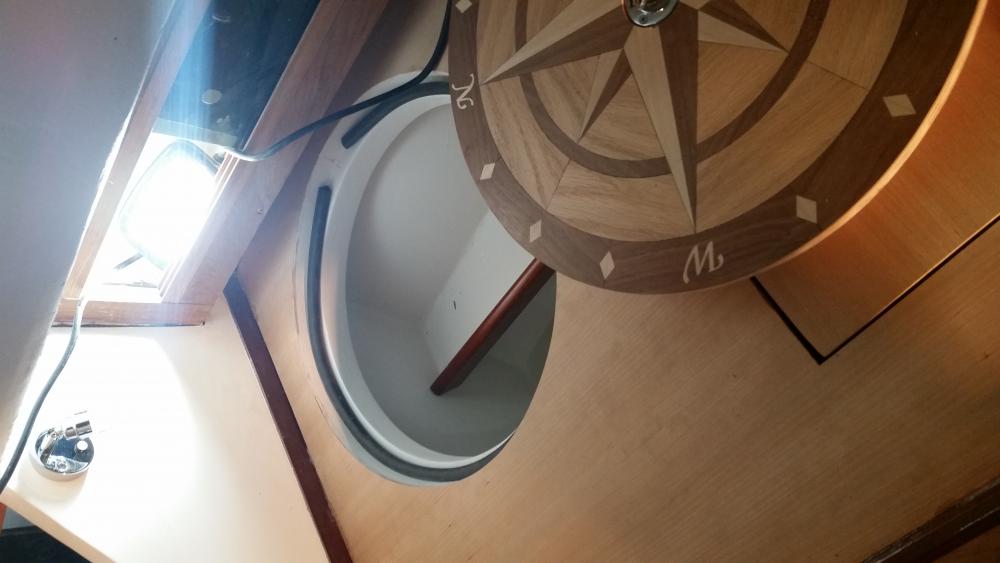

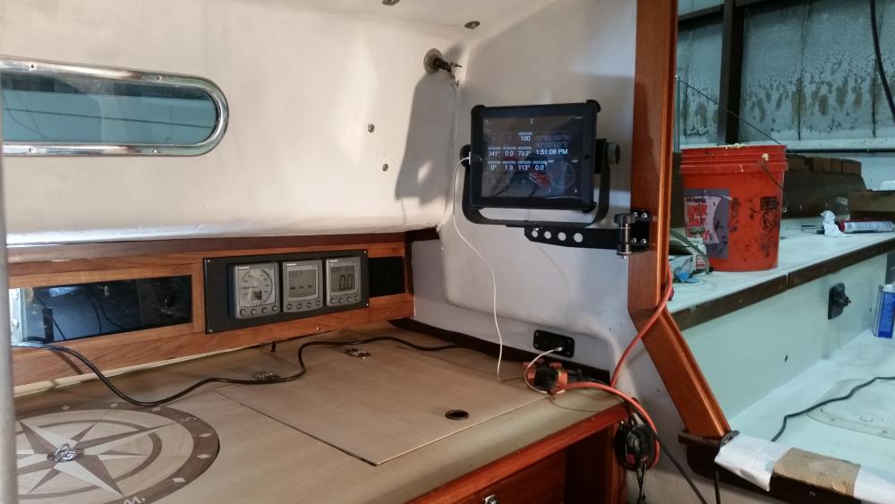

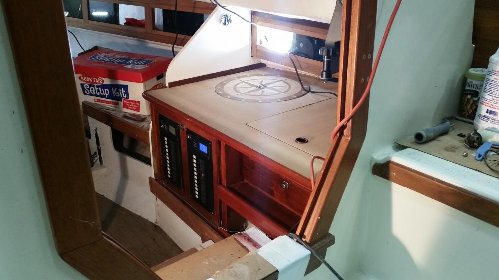

    Winter Projects

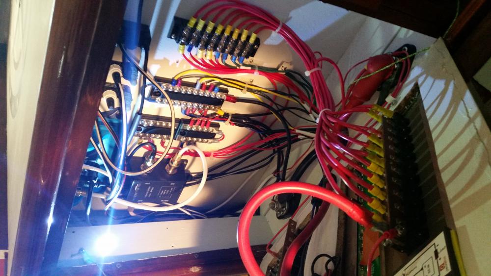

    Almost time to launch. I have a pretty long list of projects for this off season. I'm just about done. Here are a few highlights
    Remove outboard well
    Install cockpit scupper sea cocks
    Install new nav station with cooler
    Install all new electronics including:
    Autopilot
    AIS Transceiver
    Wind, speed & depth
    WIFI NMEA
    LED courtesy lighting
    LED lazzerete and engine compartment lights
    Ipad interfaced with WIFI NMEA string with charting, routing and instrument display capability
    Name:  2017-05-06 13.51.09.jpg
    Name:  2017-05-06 13.51.51.jpg

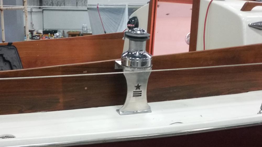

    Almost forgot - New winch pedestals. The old wood ones were clunky and were starting to split at the seams so I made new ones from 3/8" Aluminium. I had a local shop cut the pieces with a water jet including the Commander logo. Then I curved the upright piece with a press, welded the piecestogether and spent a couple of hours grinding and polishing. They are a little rough around the edges but are functional and an improvement over the wood blocks.

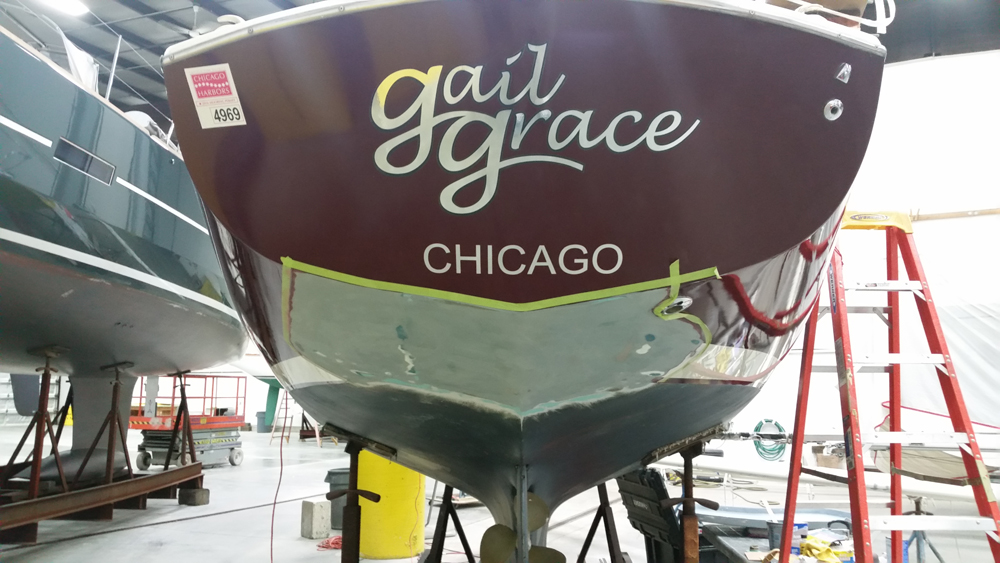

    Father's Day 2017
    Grace of Gail Grace fame
