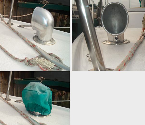

    That must be the deck fitting for an original cowl vent. There are pics somewhere on here...

    The fitting on the foredeck is for a cowl vent. These photos are of Lucky Dawg's vent. It screws in and has a pin with a spring at the bottom (that you may be able to see) so that you can point it any 360* direction and lock it temporarily in that in place. I've toyed with painting the inside red, but haven't done so as of yet.
    pix are from this http://www.pearsonariel.org/discussi...6043#post16043

    Kyle, I was hoping it was for a cowl vent. That is really cool. Now all I have to do is find one. At least I know what I am looking for.

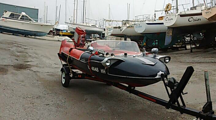

    1956 Lonestar Meteor
    Name:  56 Lone Star Meteor.jpg
    Check this thing out. The woman who does our varnish work managed a barn find up near the Wisconsin border. It will need a complete renovation (house paint over the gel coat and some other well intentioned improvements) but overall it is in good shape and mostly original including the Mercury Outboard. This outboard does not have a transmission. Instead it has two starters, coils and distributors. You start the boat in gear and go - there is no neutral. To stop you pull the shifter to the center position and it shuts the engine down. To put he engine in reverse you pull the shifter back and press the start button. This engages the second starter, coil and distributor and the engine runs in the other direction. They were know as "dockbusters" Too bad I already have a project.
  7. #37
    May 2008
    Excelsior, Minnesota
    326
    Falls Flier?
    Looks like the old Falls Flier... They didn't have headlights tho. Those old Mercurys were prized by the racing hydroplanes As there are no gears in the lower units it's a lot smaller/less drag. Unfortunately I do not have a air scoop for you.

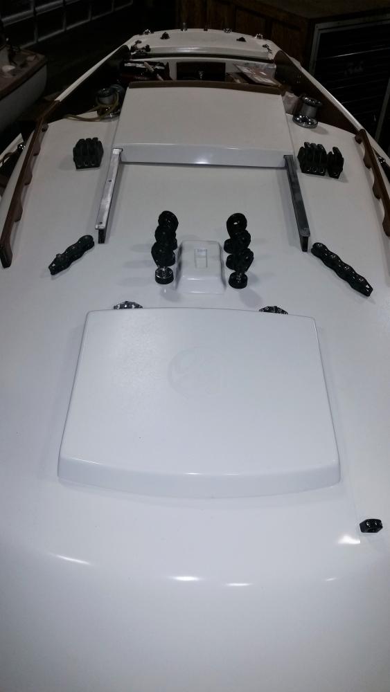

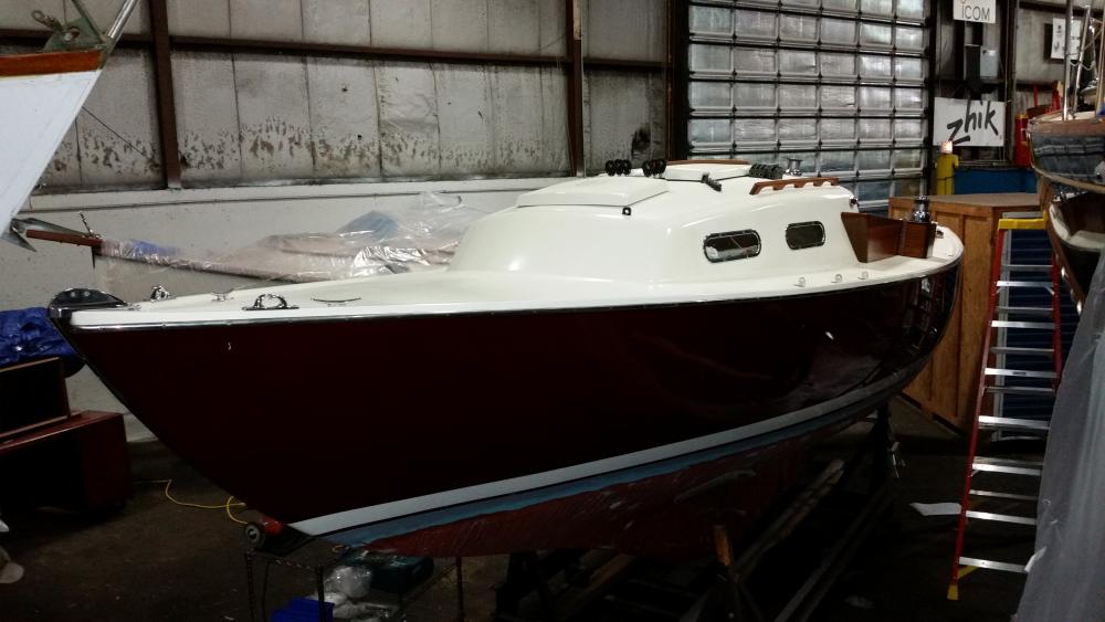

    Bisquit No More

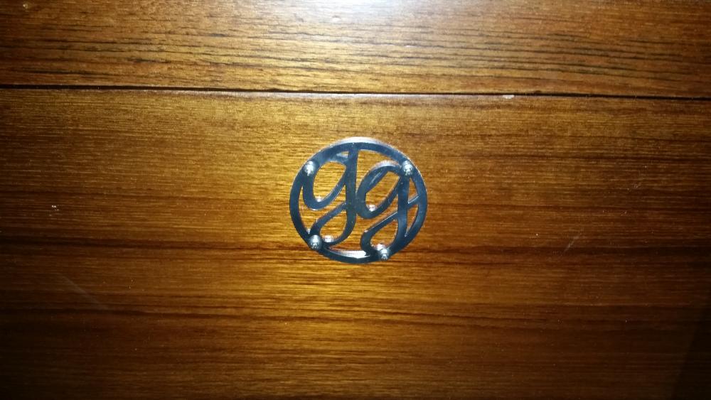

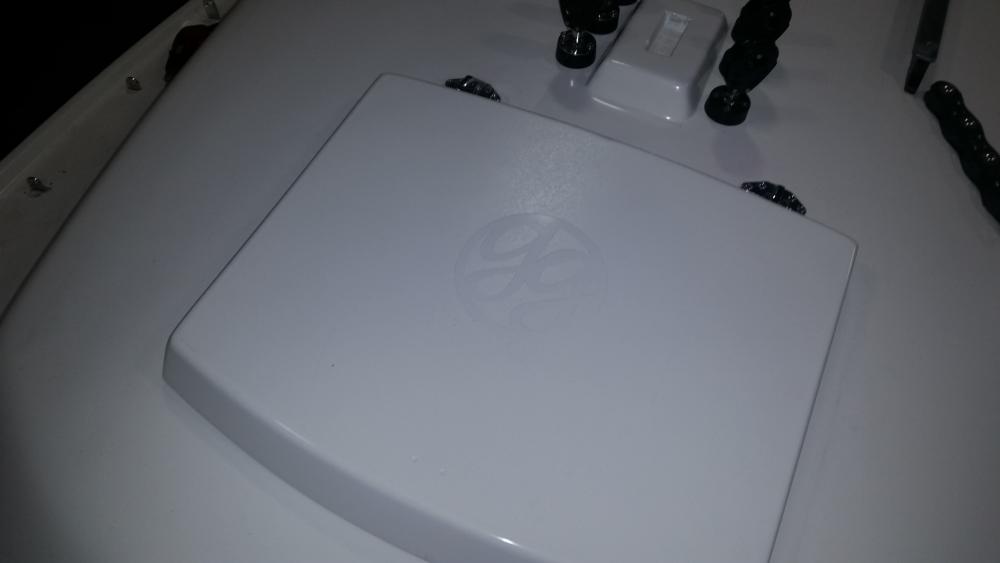

    I have officially renamed Bisquit. She shall hereinafter be know as The Gail Grace (gg) for short. She has been out of paint for a while and I am just about through with installing all of the hardware and brightwork. I lead all of the halyards, the single line reefing, outhaul etc. aft. The hullsides are painted with Awl Grip "Downeast Red" a custom color they make for Morris Yachts. The deck is painted with Awl Grip in Oyster White with sprayed on nonskid. I designed a logo for the boat and incorporated it in the nonskid. You just get a cheap vinyl version of the logo cut and after you spray the smooth and it has dried - before you spray the nonskid you put the decal down. You go ahead and spray all the nonskid areas and then peel the graphic after the nonskid has dried. I have been meaning to post some pics of the progress but you know how that goes. I had custom scupper grills made in 316 stainless by a place that uses water jetting to cut them from stainless steel. Time to start the next project. I'm going to re-power her with a little Yanmar diesel.

    WOW! What an amazing transformation! Beautiful boat.
    Love the logo in the gel coat, great idea.

  13. #43
    3,621
    Cool beautyful work
    Sorry if I missed it in your text....
    great idea using gg bronzes for scupper covers!
    For your cockpit drains also?
  14. #44
    Apr 2015
    Chicago, IL
    133
    Thanks, I can't wait to sail her this summer. The whole family is excited. I had the shop cut 8 logos. $265 for the lot. Two for the scuppers, two for the cockpit drains, one for a hatch board, one for the Christmas tree and two extras. I have a cockpit grate that I have to modify slightly so you can still see the covers. I'll post some pics of that when I am done.
