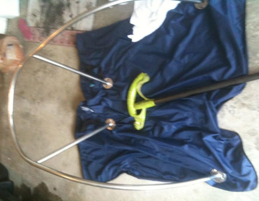

    I can think of several shops here locally that could repair your bent bow pulpit. Surely there is one there that could help you out. If it is just deformed rather than creased, you may be able to (like I did) rent a tube bender (florescent green thing pictured - used for bending electrical conduit) and get it back in shape.

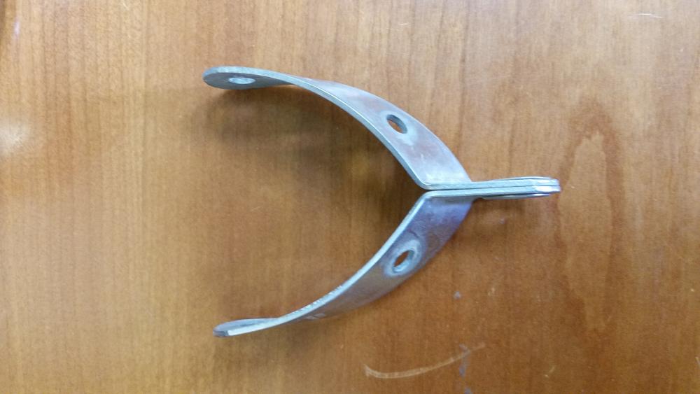

    Andy,
    Did you ever get that tang? If this is what you are looking for I found mine today. I no longer need it. Happy to mail it off.

    Excellent, Thanks Phil. I will private-message you with my address.

    Original tang
    Sorry no photo.
    The original is a single piece of the same hefty s.s material as the other rigging
    tangs, that was hung over the mast sheave. It has a squareish curved top
    with 3 holes on either vertical edge, that fills the area above the sheave cutout,
    with a flat bent-out tang at about the angle of the forestay for the staysl blocks,
    over the mast sheave opening.
    Like other tangs its attachment hole faced the mast, not 90degree like yours.
    Mine was filled, since it really did not hug the mast curve very well, with a
    hard metallic substance that I thought was ancient bedding compound. But
    after cleaning, proved to actually be the compacted corroded oxide top of the
    mast. The top of the mast extrusion was completely eaten away. Might say
    the fixture held the sides of the mast together like a buttoned shirt and tie.
    The tang could have let go at any time because of block tension and yanking.
    Because the ss tang is usually out of sight at top of mast, it must be insulated
    from the aluminum best as possible. Instead of tube rubber, suggest Mainesail's
    BED-IT butyl, because it is incredibly tenacious, and will make a 'live' gasket
    -- and Tefgel on screw threads. (keep Bed-It away from threads)
