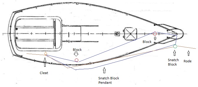

    Attached is a schematic of the setup. I had to use a generic deck plan drawing, and the Ariel is a little less beamy than the deck plan shown.

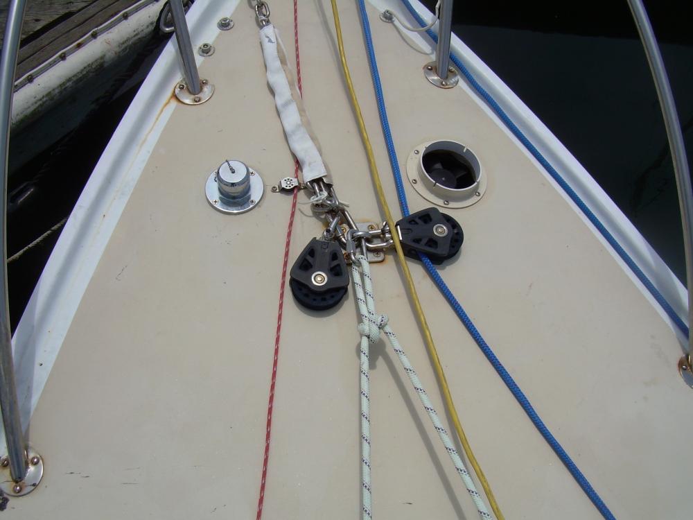

    The snatch block (green) is tied in a looping pendant (blue) which is used to adjust it from abeam the cockpit to the bow. I have two blocks (red) at the forward shroud chainplate and the bow. * Two blocks, including this one, are attached to the padeye. The other block is for my boom preventer.
    So the pendant runs in a loop: 1) starboard jib sheet cleat, 2) block at the forward shroud chainplate, 3) bow block, 4) bow skein chock, 5) along side the starboard hull back to the jib sheet cleat.
    The snatch block pendant is always set up on the boat, going on the assumption that the times I will really need my anchor in a hurry are the times I can't anticipate needing it. The snatch block is normally stowed in a space under the starboard jibsheet winch.

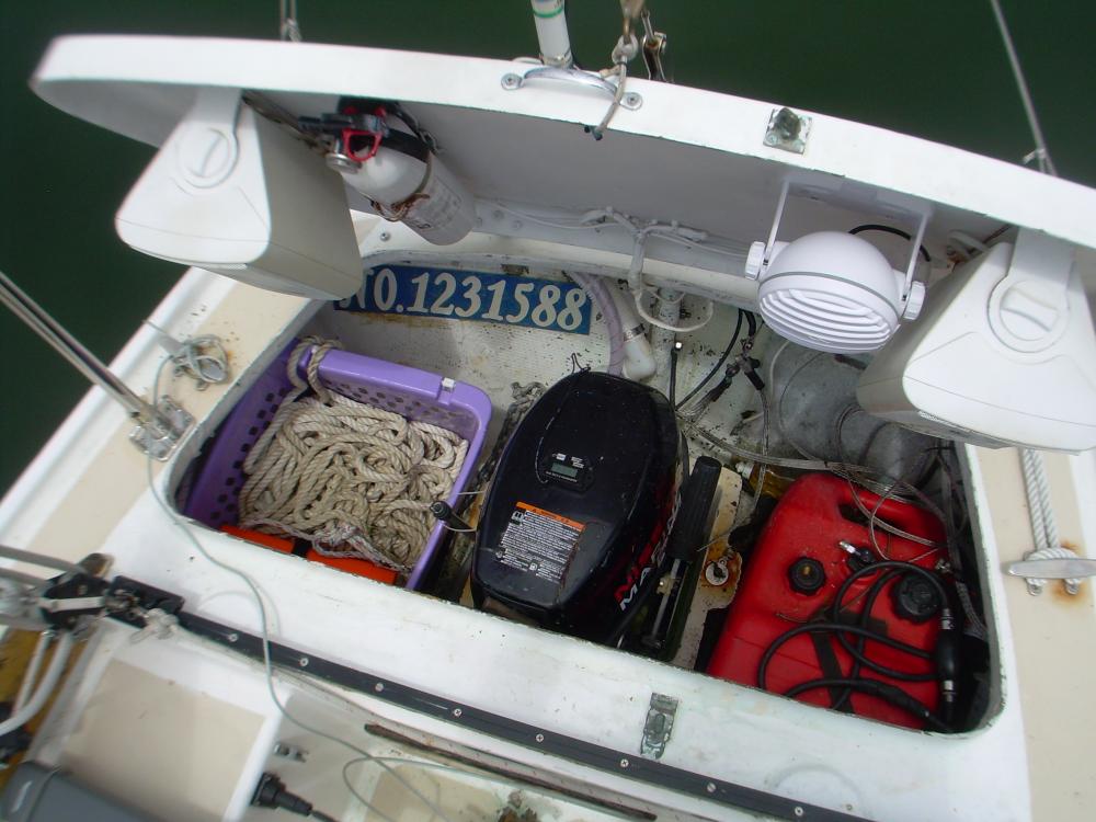

    To anchor, I pull the laundry basket out of the aft locker (engine compartment). The anchor rode is in a random heap in the basket. The anchor and 25 feet of chain rest beneath the basket on the bottom of the locker. I place the basket on the cockpit seat, reach in and remove the anchor and chain, and drop the anchor off the starboard side (I always drop anchor while hove-to on a starboard tack - so the starboard side is to windward). In an emergency that prevents heaving to while I am underway, I'd just cast the anchor off the starboard stern. Once all the chain has gone overboard, I clip the anchor rode (brown) through the snatch block gate. I then haul the snatch block to the bow using the pendant loop and tie off the rode and pendant to the cleat. The only snubber I use is on the anchor rode just above the thimble that attaches the rode to the chain. It's submerged, rubber, and doesn't mind seawater exposure.
    One advantage of using a snatch block and pendant is it allows me some adjustment range of the bow's angle to oncoming swells. They are often not perfectly aligned with the wind, and also when the swells are really high and sharp, I can trade off pitching and rolling motion to get a better ride - which also places less strain on the rode, making the anchor less likely to come unset.
    To haul in the anchor, I use the jibsheet winch, if necessary, to haul the boat to the anchor. Once the anchor breaks free, I haul in the line until the chain emerges from the surface, and then I haul the snatch block back to the cockpit using the pendant, unsnap the rode from the snatch block, and haul the chain and anchor aboard.
    If there's bottom mud in the chain and anchor, I let them dangle over the side for a while until most of the mud is removed. Sometimes I dip them up and down a bit - teabag style. Since I am storing the anchor in a "wet" locker, when I get back to the dock, I just hose off the entire aft locker and let my little bilge pump in the locker empty it out.

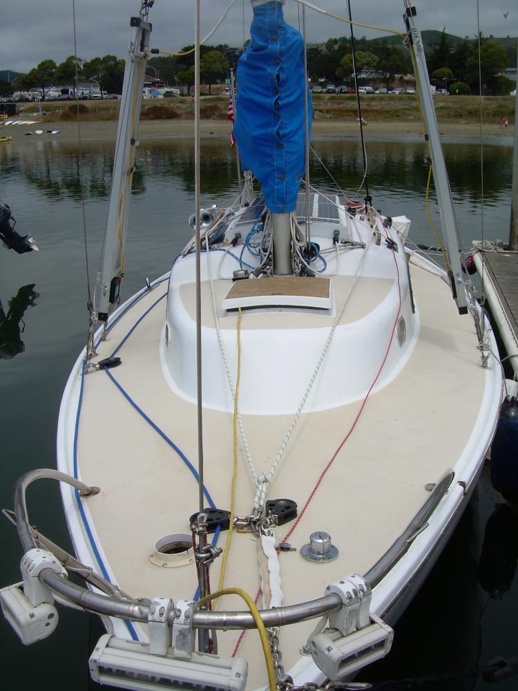

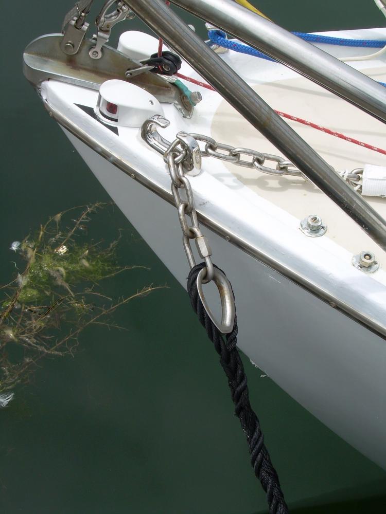

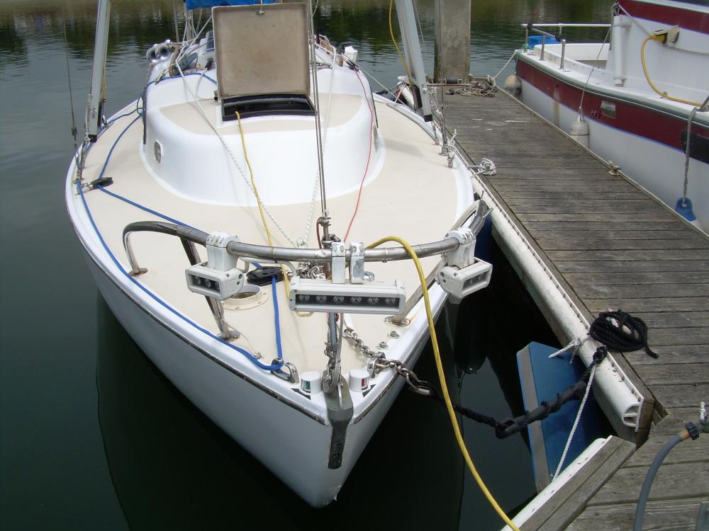

    Attached are some photos. The blue line on the starboard side is my anchor pendant. I removed my vent hood on the foredeck for a better view.
    A few other things you'll see in the photos:
    • I have LED lights on the bow rail. These have taken a beating (including a few whacks by pilings while docking) and continued to work for three years. The paint on the mounts is pealing, but the lights work fine. I suppose you don't see too many crab pots in the Bay, but they are strewn about everywhere like mines where I sail. The lights are also good for night entries into tight harbors like Santa Cruz -- and for making my boat recognizable to the many tourist kayakers we have during the day - would wouldn't otherwise know the difference between how the "front" and the "back" of a boat looks ("most things have bright white lights only in front, right Mable?"). They're brighter than my headlights on my car. Current consumption: 3 amps.
    • I have chain attached to my dock line on my port side. That dockline is just a few inches short of being long enough to reach the propeller, and it stays on my boat at all times. The reason for the hefty chain and cast stainless thimble is that I use that line for my sea anchor - which I've used often to take a rest offshore - and a chain won't chafe. With a sea anchor deployed, an Ariel is a formidably stable boat even in wicked swells. The white cloth covering is to keep the chain from abrading the deck paint.
    • The white line with stripes having a Lineman's Loop (Alpine Butterfly Loop) is my jackline. The line glows green even in full daylight because it is photo-luminescent. Easy to see in the dark! The line has the outer sheath steam-sealed to the inner core, so the sheath doesn't "milk" (slide over the core) which is important with a jackline. I opted for round line instead of flat webbing because it is never in an area where I step (where it could roll) and it does less harm to my hands when I have to cling to it.
    • I have LED navigation lights at the bow, and a little black masking where the lights would otherwise reflect off the white paint, then bounce off the bow railing and destroy my night vision. They are "2 mile" lights. Also, the thin red line going through a block at the stem is my jib downhaul.
