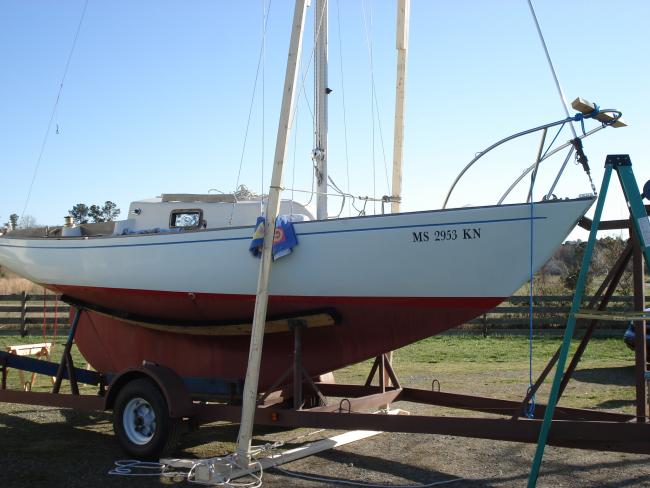

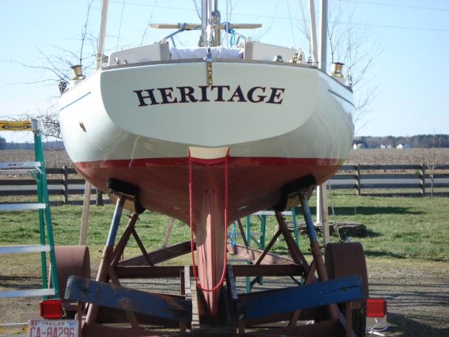

    I know, I know, It's not a great Commander or an Ariel, but it's still a classic Alberg design that I now find myself steward of. So..., based on a few folks on this wonderful forum who have expressed an interest in my latest vessel endeavors, here's her debut:
    Her lines were orinally drawn in 1959 by Carl Alberg and she was marketed as the "ALBERG 23", later changed to Sea Sprite 23. This vessel is hull # 760, built in 1982 by C. E. Ryder.
    She has not been in the water in over 10 years and I have addressed about all the issues that come with unknowing previous owners, deferred maintenance and a slight bit of neglect. With that being said however, she was not in bad shape by any means, just needed some of the classic TLC and a caring new steward.

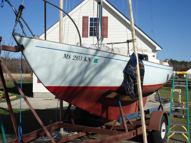

    Hello Chance, It's truly great to hear of your new project, that's a great boat for sure, The place that modified my Ariel trailer to haul the Triton owns one and he loves it. It needs deck recoring but he hasn't gotten to it yet. Is that a Mass. state registry number?? Is the mast going up or down in pics.? Carl

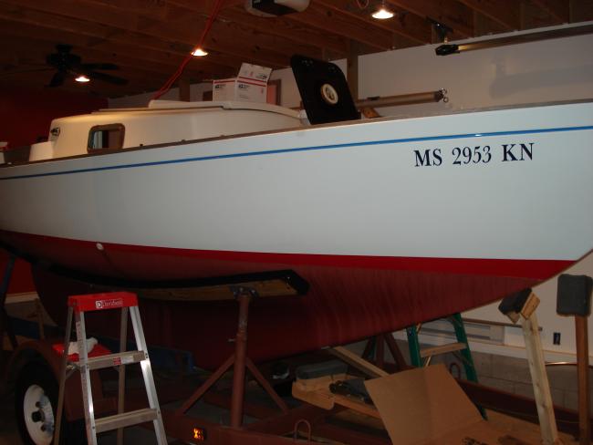

    Carl, you are correct, I do believe the third owner had her there. I now am the fifth owner and have her registered, though I am having trouble identifying the font that is currently displaying her old registry number, that I want to duplicate. I have attached a closeup of the font I'm looking to duplicate.

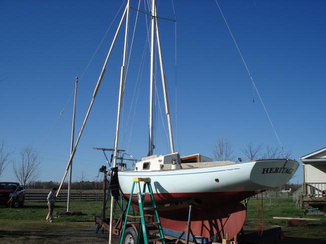

    As for the mast stepping. We (my family) and I had just stepped the mast so that I could obtain accurate marking on all shrouds and stays for measurements on the new rigging. The rigger I chose (Rigging Only up in MA) , recommended I step the mast with the old rigging to find out where her turnbuckles sat once tensioned, instead of assuming the the old rigging was of the right length. So that is why you see the mast stepped in our driveway. It was a rather cumbersome set up. The mast is not that heavy, but at 30 feet, with jumper stays and the normal cap shrouds, fore and back stays, double intermediate (lower) shrouds, halyards and topping lift, it made for an interesting evolution.
