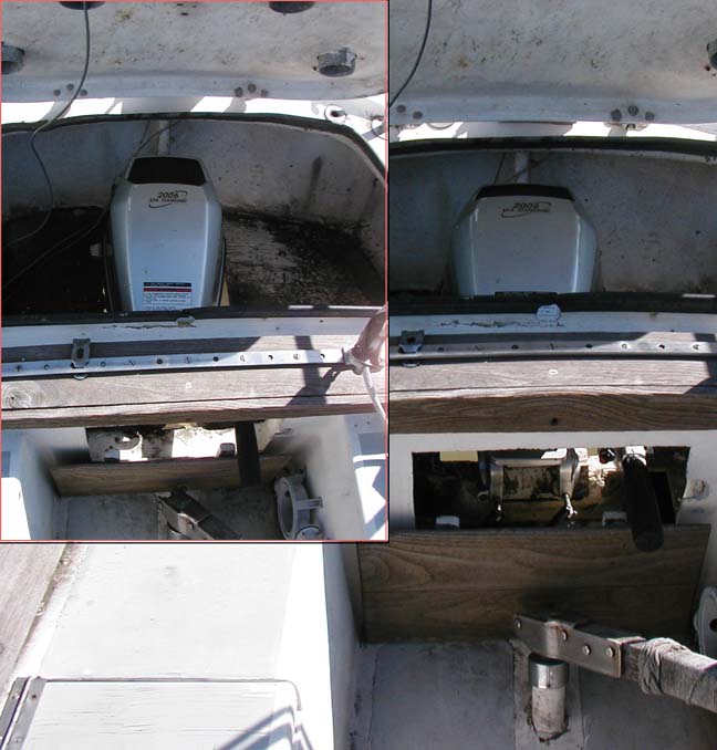

    Kent, don't forget the upper exhaust port when considering closing the hatch. See earlier ob discussion and photos. You need a fix (maybe a fitting with hose attached) to "pipe" the exhaust away. As I recall, several skippers are "thinking" about this.
