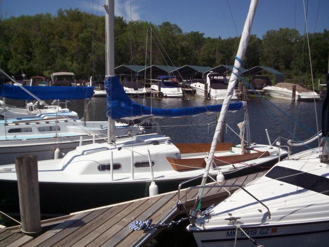

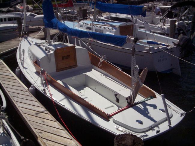

Here are a few of her as she sat in Marblehead.

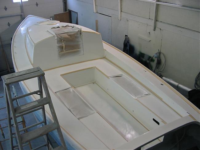

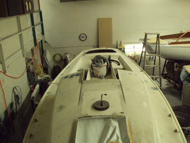

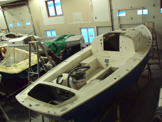

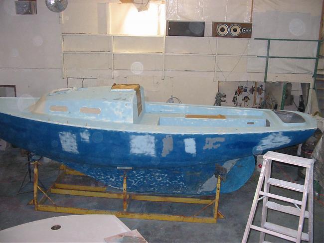

Pic #1 - Hardware and britework removed and staring deck repairs.

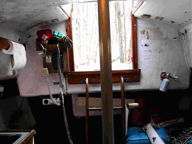

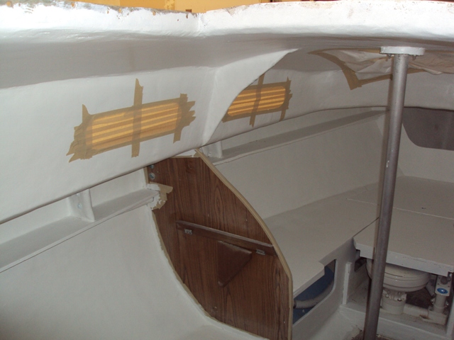

Pic #2 & #3 - Cuddy clean up.

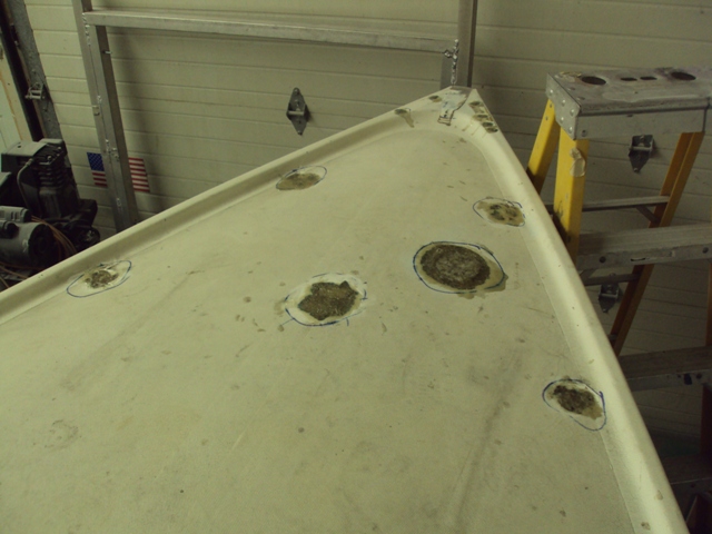

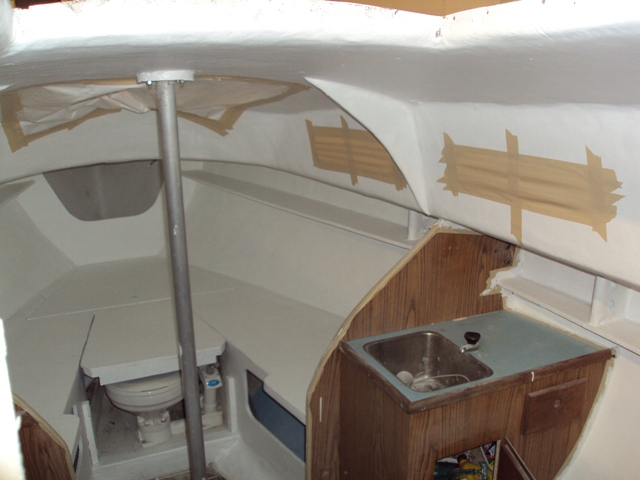

Pic #4 & #5 - Starting deck repairs.
The boat is in pretty good condition. The deck gel coat is severely weather checked and cracked, however, with the exception of the port forward chain plate and around a stanchion fittings the decks are very solid. The deck around the mast step has been recored by a PO, very nicely done. The boat owner picked up all the wood and will whittle away his winter with the britework.

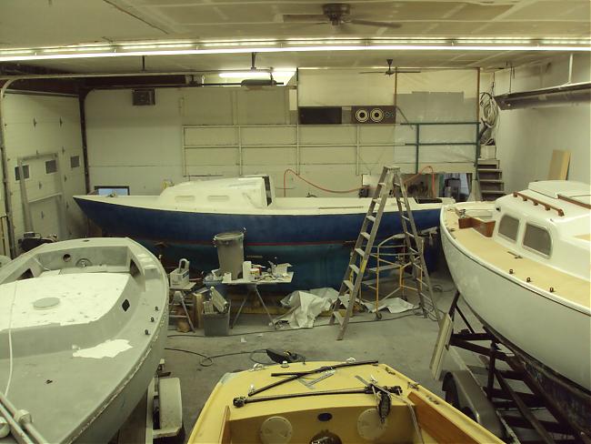

Pic. #1 Commander 299 keeping good company.

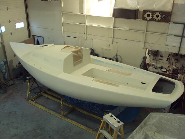

Pic. #2 All deck repairs completed and ready for final prime.
Pic. #3 After 2nd prime coat buzz down, wiping down in prep for 3rd and final primer coat.

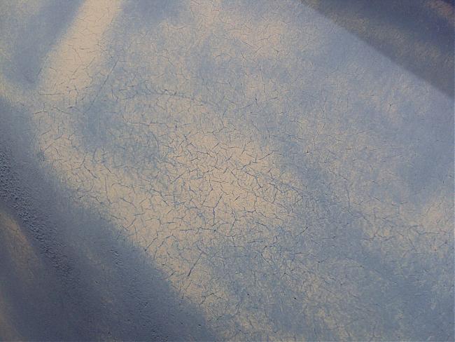

Pic. #4 229's deck was very solid but extremely weather checked. It is important to get the primer into all the crevices instead of just bridging over them or the checking will telegraph through in a few years. We worked a vinylester paste (the blue stuff) in with a roller then buzzed it down and reapplied.
Pic. #5 Final prime coat sprayed on. One more sanding session and on to the topcoats.

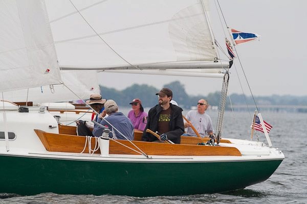

Love all the different angle shots!
Every view shows what a great daysailor the Commander is.
Your 'gentleman' buyer is getting a fine restoration for his buck.
When you think how difficult it is for many people to restore a Classic from the keel up, it's worth every penny.
And that you are reviving one of the most beautyful designs ever conceived - THAT ALL WHITE OVERHEAD PHOTO PROVES IT! - is real classy too.
Feels good, way over here via some internet noodle in California, to see you breathing life into this gorgeous old one design. Everett Pearson should stop by to shake yer hand and buy you lunch!

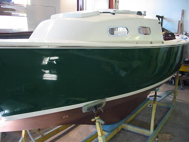

We are just throwing on the finishing touches on 229. Now that its starting to warm up a bit, the N.O. is finishing up the bright work.
Bill; That is A 235, another rescue boat that I found a N.O. for. We are doing some deck repairs and new non-skid, new engine controls for the A-4, strong back etc. I'll try to get some pics up of her as well.

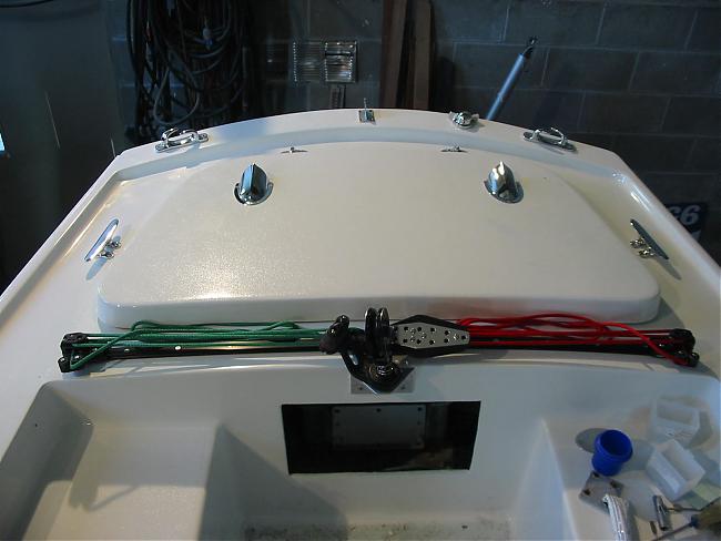

Pic #1, Taping for the nonskid. We used Awlgrip paint with Awlgrip course additive.
Pic #2, Aft deck with plated hardware and new traveler set up.

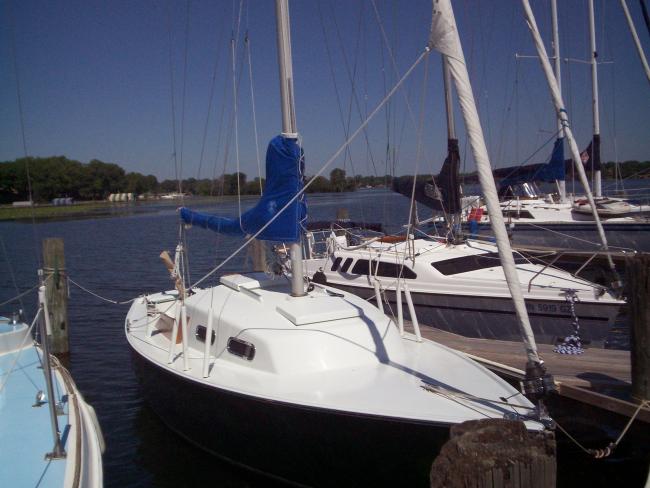

I was walking by ol' 299 with a camera in hand so I snapped a few pics.

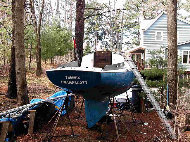

Phoenix fell in with good folks, hopefully we can get them on the board.
